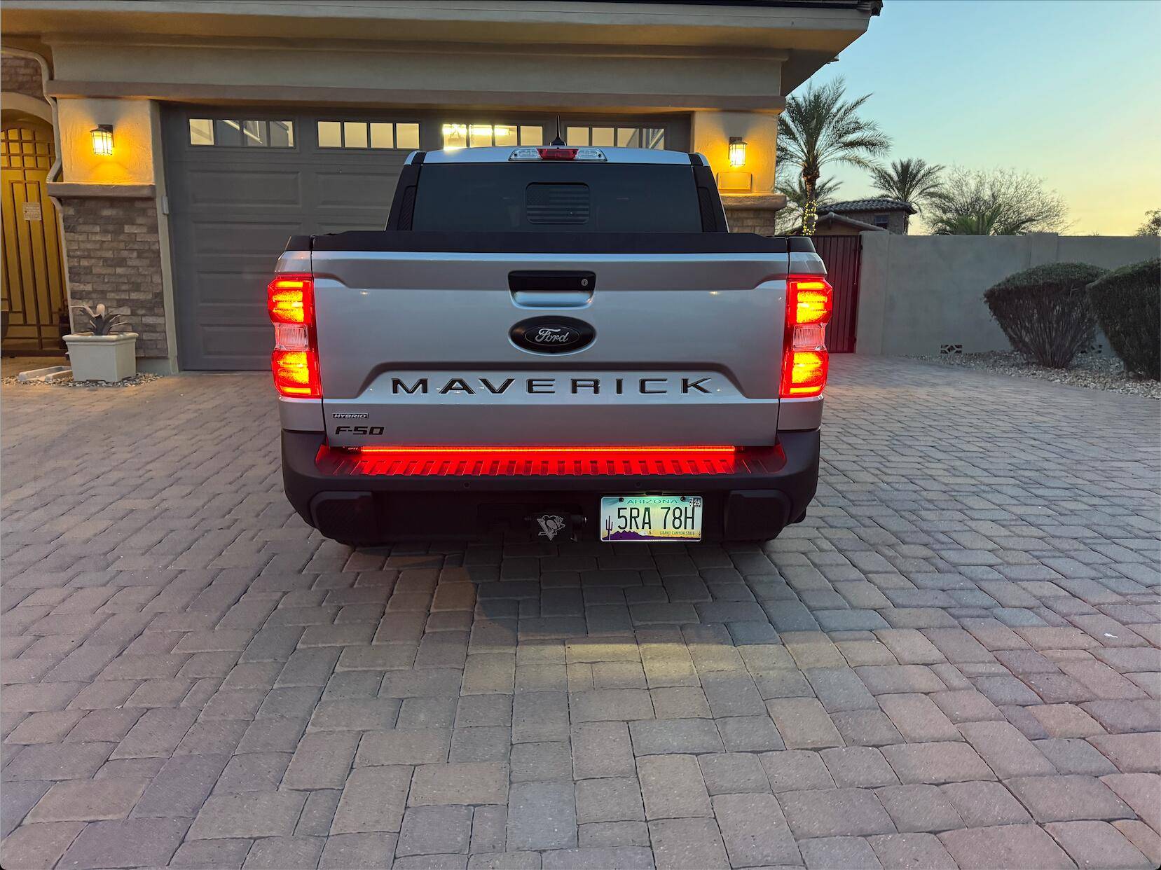

I used the curt harness:
https://amzn.to/3XzjLCk
I was lazy 😄 I took a shortcut and tapped into the reverse light circuit using the Curt harness on the driver’s side. Instead of running dedicated power all the way to the battery, I opted to use the existing 12V wiring in the truck bed. Also, living in AZ I just used automotive velcro to mount it to the bumper so I could remove it if I needed the spare. After two years no issues. 🤞
Not being lazy to me, if I were to install a light bar I would do the very same thing, adding the reverse light feed from the short jumper on the Curt harness, as well as power from the FlexBed.
