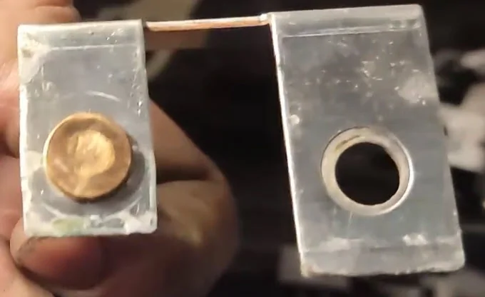

The jump point stud (Copper?) looks to be press fit into a bus link that bolts into the DC bus.
So probably can't put much torque on it.
I used 2 nuts and fit a ring terminal between them.
12 Volt Jump Point - Press Fit Stud Rear
Did you wire something up to the jump point? Was it a light bar or the one I have? The post looks like I may be able to just thread the connector over it and tighten with a bolt.
