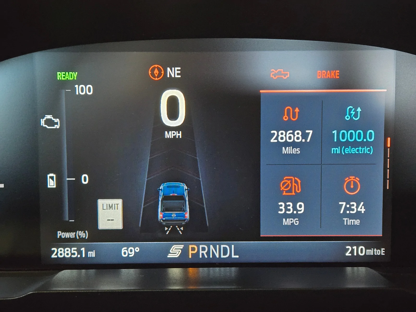

Do you have a meter on yours that shows you the accumulated totals EV VS Ice, for say a month or 1000 miles?
Not just the key on, key off individual trips.
I can get that off the trip meters. I never reset trip2, so it's cumulative since the truck was built.
You must have something different than I do. I quit resetting my trip 2 right around 8,000 miles. And this is what my screen shows doesn't show a difference between electric and gas.

Ye
You must have something different than I do. I quit resetting my trip to right around 8,000 miles. And this is what my screen shows doesn't show a difference between electric and gas.
New trucks with the updated dash. Here's mine at my first oil change. *I did some towing which really killed my cumulative MPG.
