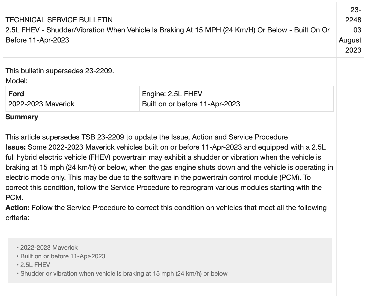

This is 100% the 23-2248 recall. I suffered from the same thing and had this done and its amazingly better.
TSB attached.
Ford Maverick Surging when stopped.  Anyone else? TECHNICAL SERVICE BULLETIN

Sorry you feel that way, but thanks for being helpful.
They are right though, it’s a different issue. I had that other TSB applied and it stopped the shudders handing off from ice to gas, but doesn’t matter for this issue at warmup for my first stop sign where it wants to lurch forward.

I just took my maverick in for the first Oil Change + tire rotation. I mentioned this EXACT issue & the grabby hybrid brakes. Dealership said,
We verified the audio screen concern, we ordered a new screen. For the brake concern we were unable to verify but there is a technical service bulletin that applies to Mavericks built before 04/11/23 for a shudder or vibration felt during low speed braking when the gas engine shuts down and the vehicle is operating in electric mode only. Ford says this may be due to software in the PCM, we updated the software . additionally we performed the needed maintenance ( lof and tire rotation). I’ll call you when the display screen comes in.
however after this I am still having both issues. Grabby abrupt hybrid brakes (seems like the truck doesn't transition from regen breaking to pad on rotor smoothly). & this exact issue. I described it as, randomly on cold mornings you will put the vehicle in drive and while your foot is on the brake its going: nudge nudge nudge nudge nudge.
