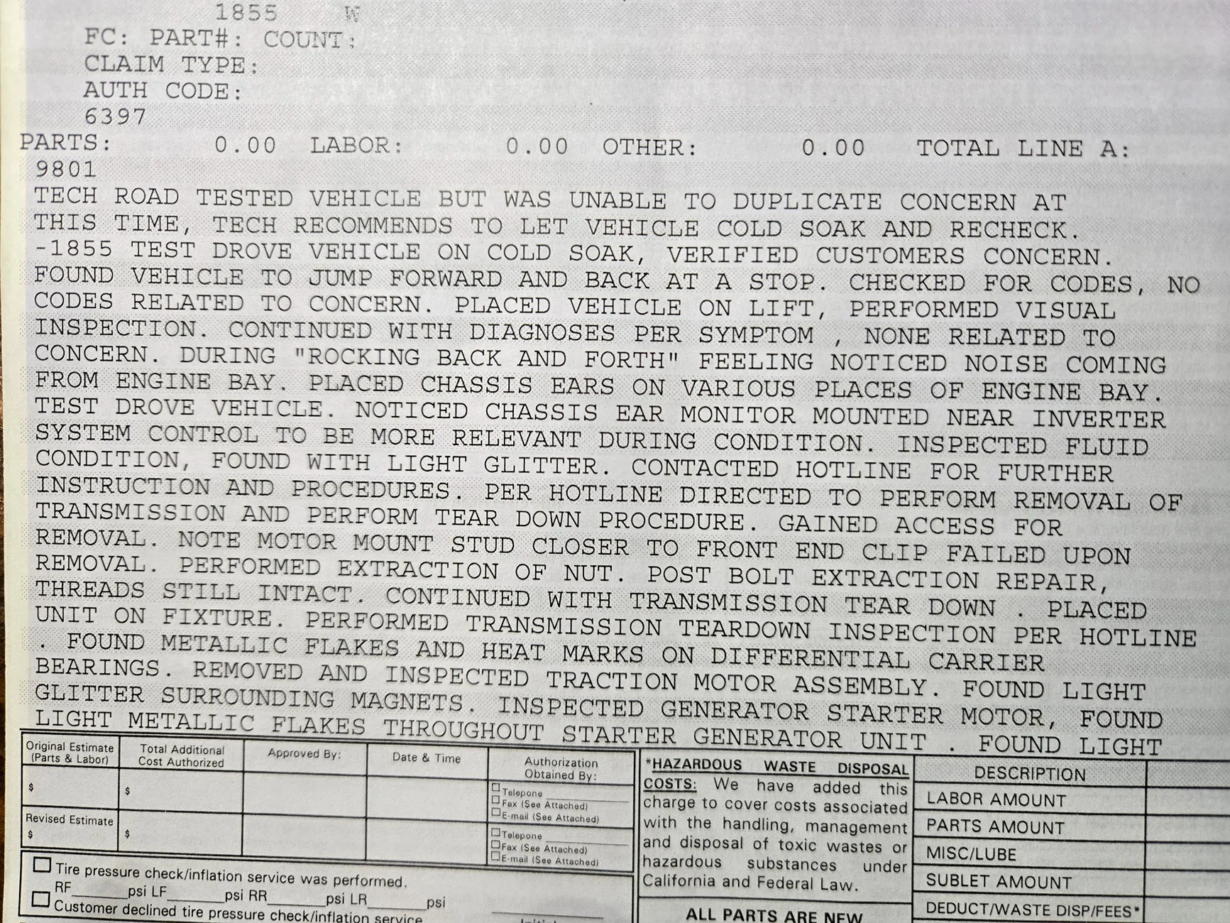

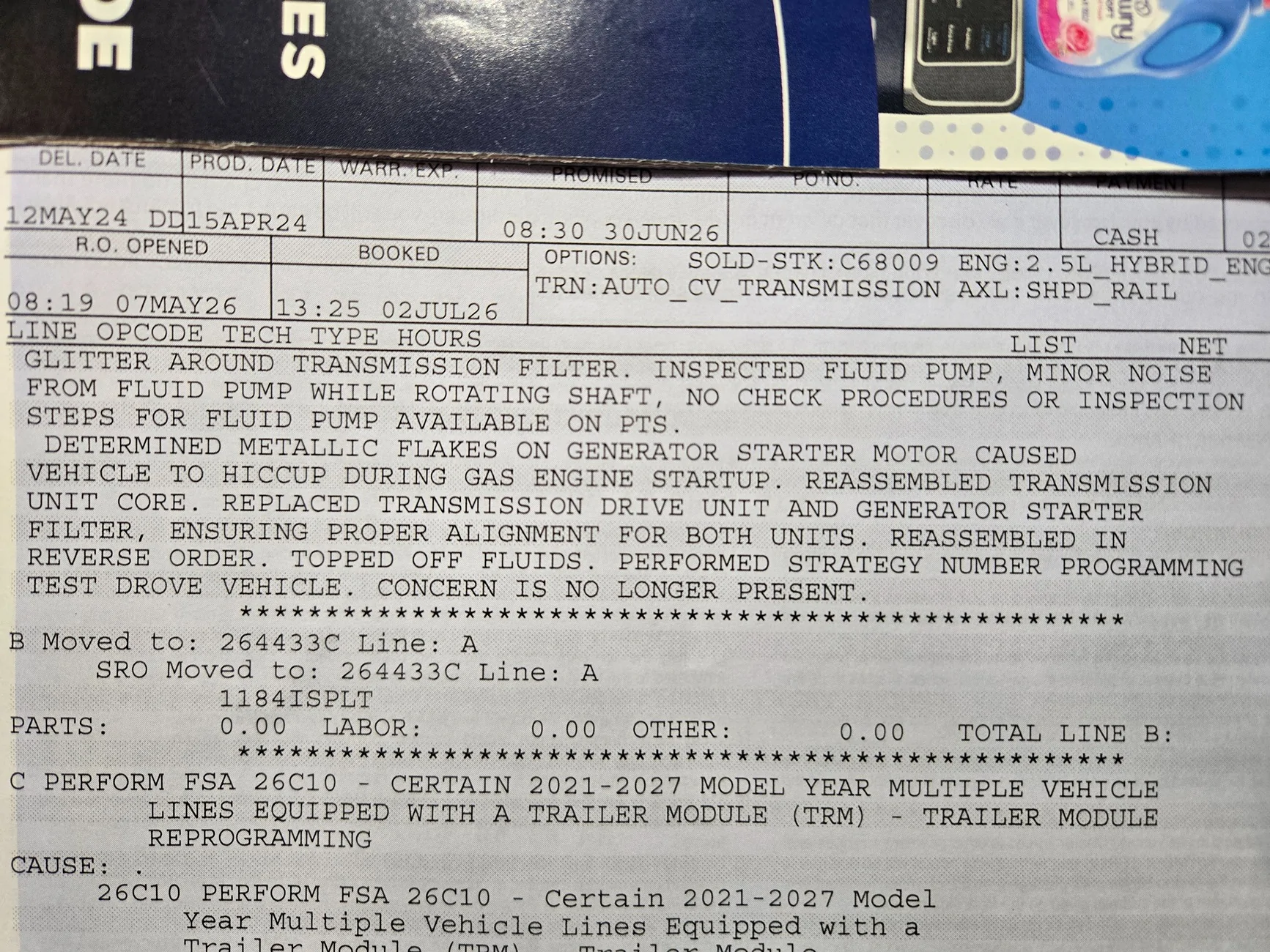

SURGING HAS BEEN RESOLVED!!!
Read the attached work order from my dealership. It took a few visits before they found something. They did a great job! They call it engine Hiccup. Before you decide to ignore this, go with your gut and deal with it. I'm fortunate that 3 dealerships in my area are owned by the same individual and they have a large database to pull from and have dealt with this before.
Well we know for sure that all that glitters is NOT gold in this case.
I guess the tranny filter isn't intended for fine stuff. Wonder if Andrea had a hand in assembling your tranny - and was wearing too much glitter that day.
Replaced "transmission drive unit" and "generator starter filter" - huh?
But reassembled core, and I'm guessing other things.
Maybe just strange use of terminology - it would be interesting to get a better description of what is new or just cleaned.
I'm assuming cleaned though that word isn't used.
Flakes on GM, did not use the word glitter.
Hope no touching in the GM was happening to create flakes, that resulted in glitter later on after some grinding.
Well - several things in there would sure explain the difference between slight surging effect and "jump forward and back".
