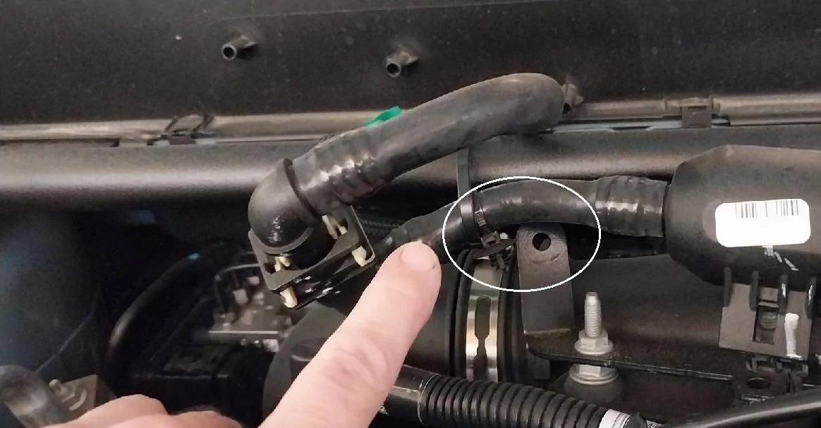

I just answered another thread on installing this, a few months ago..
There is a canister, that I had to loosen and reattach with a wire tie...
I also included some photos....

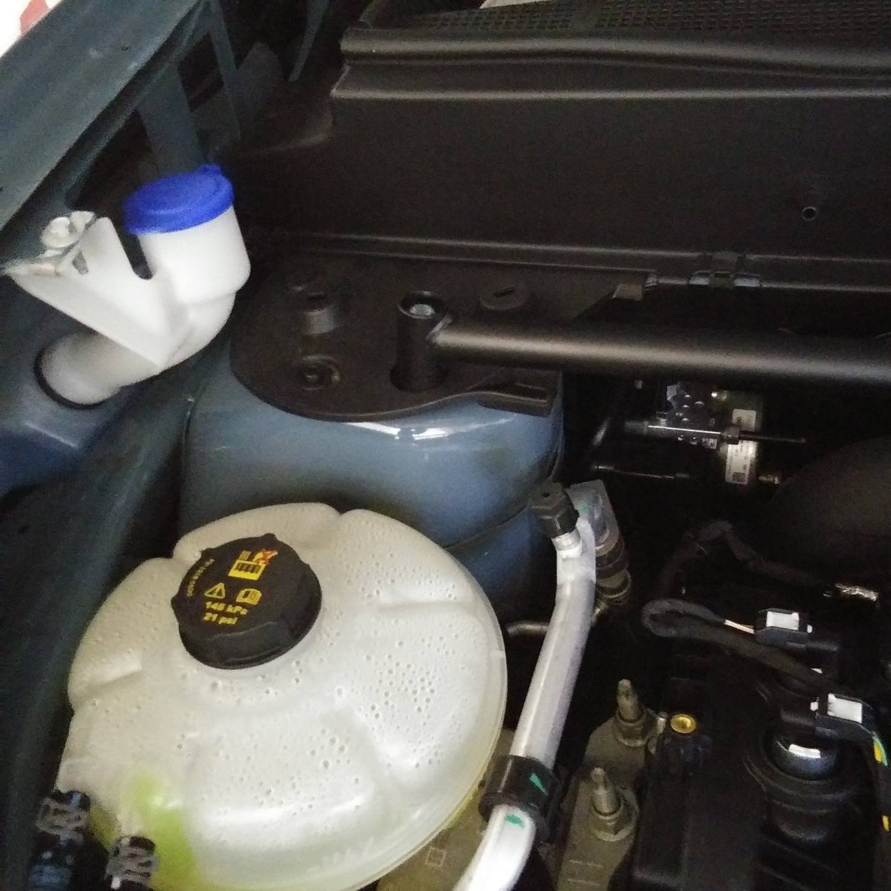

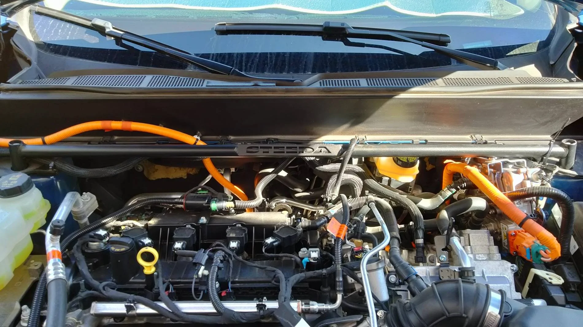

Below is the final installation. I have noted the mods that I had to make it fit with little work...
Ford Maverick Strut tower brace Steeda Steeda Install details
Ford Maverick Strut tower brace Steeda Steeda Install Cansiter Cli
I highlighted the "Clip" and "hole in the bracket" that I had to leave "Loose" for the Strut to fit with minimal rearranging of components... ;)

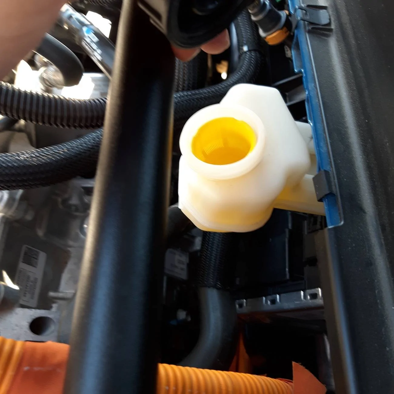

Does the Steeda block access to the brake master cylinder?

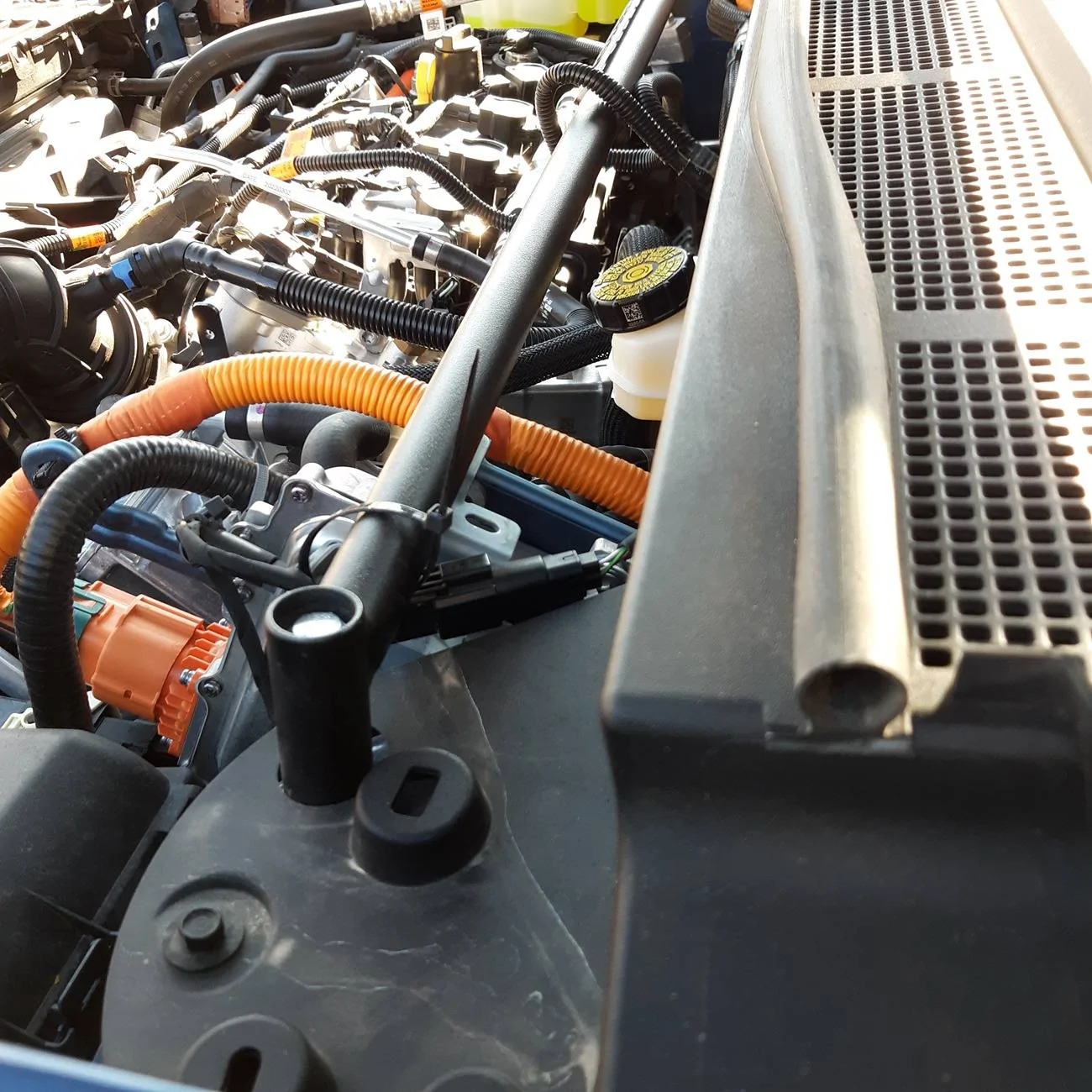

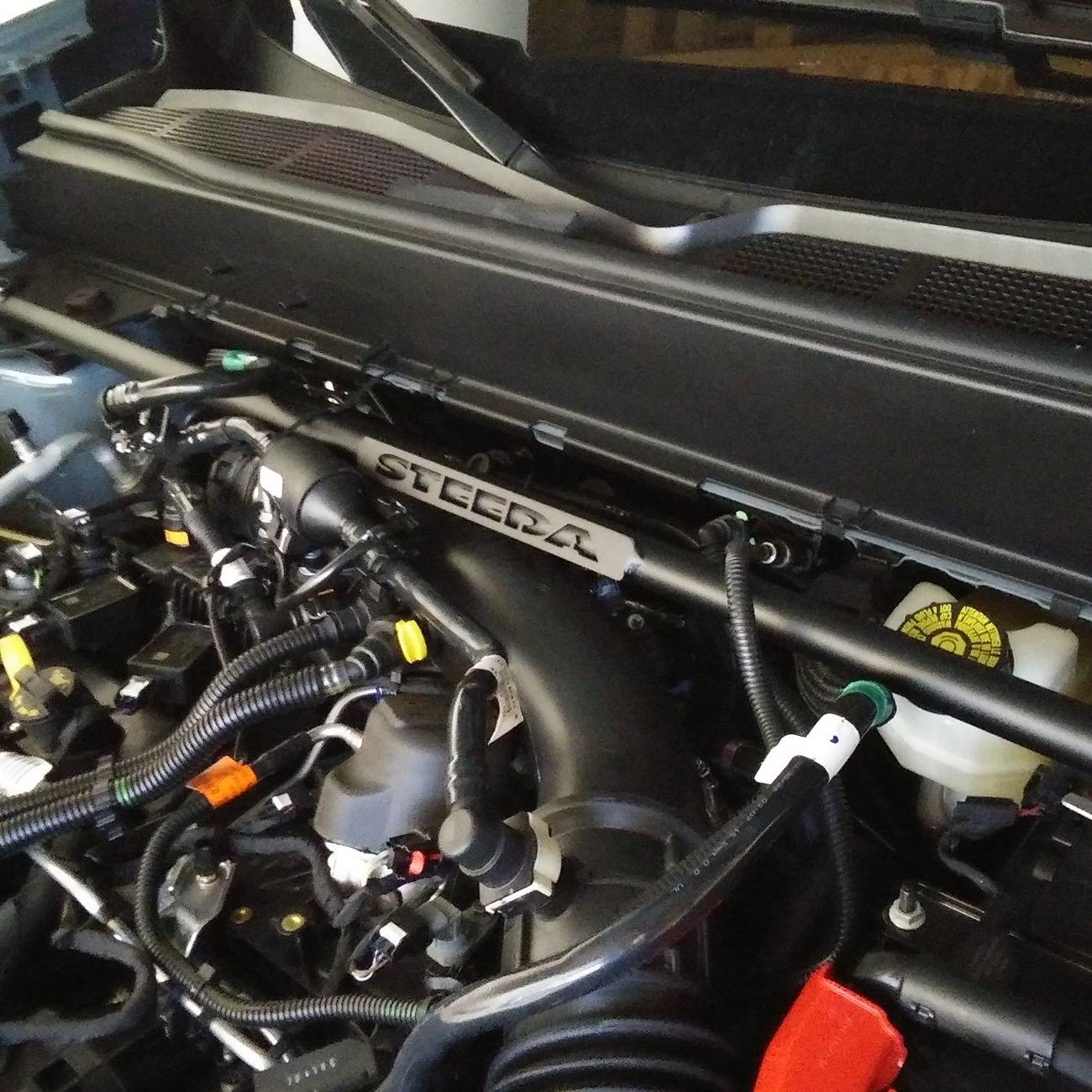

HRG
Your EcoBoost could be different.
I own a hybrid. No master cylinder or booster per se, they're electric brakes.
If you are speaking about the brake fluid reservoir. No problem, there is plenty of room with a Hybrid as the picture's show.
Good Luck
