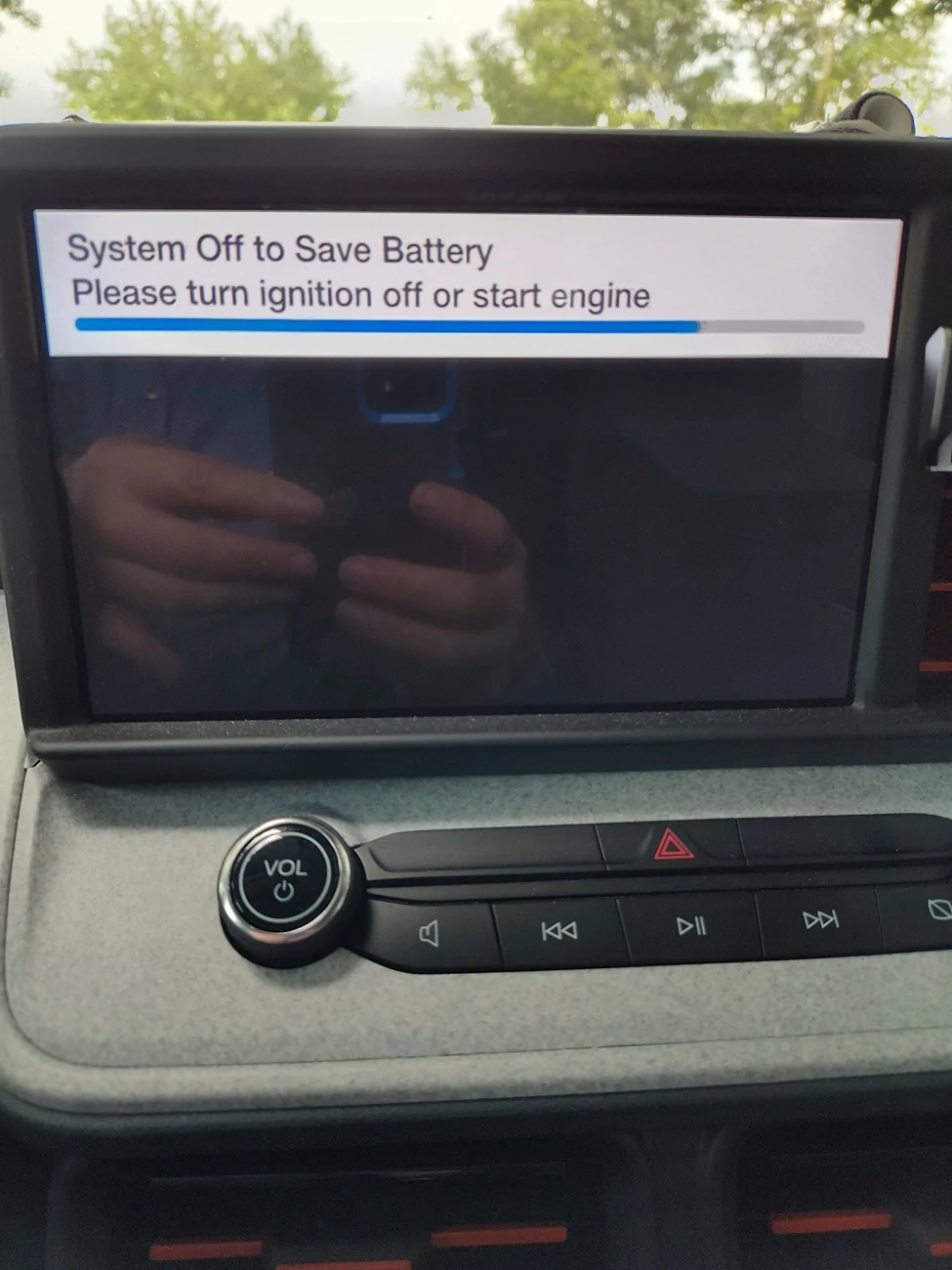

HOW DOES THE BATTERY MANAGEMENT SYSTEM WORK
If excessive battery drain is detected, the system temporarily disables some electrical systems to protect the battery.
Systems included are:
  • Heated rear window.
  • Heated seats.
  • Climate control.
  • Heated steering wheel.
  • Audio unit.
  • Navigation system.
A message could appear in the information display to alert you that battery protection actions are active. This message is only for notification that an action is taking place, and not intended to indicate an electrical problem or that the battery requires replacement.

Now this reply is just for the hybrid mavericks.
It was nice they wrote software and wrote it in the manual that there is a order in witch items are shut off to protect the battery.
I think most of the items listed above will need to key ON to operate?
I know on my 23 XLT mav. if the key is on the battery is being charged.
Maybe they wrote that in to the software to be a watchdog system, so when there is a glitch in the software and the key is off and something is on by a glitch the watchdog system will turn it off to protect the battery.
They must have a high degree of conferenced that there software has issues.
Now I am going to need to look at other vehicle I have owned to see if they have a safety protection like this in there manual.
I'm not sure I'd put that much faith in the order of the items, not alpha order obviously, but there have been other sloppy sections in the manual. Maybe it is the order.
Glad you mentioned it that way - I was assuming totally when off.
I agree must mainly be for key On or perhaps ACC mode mainly, since I got this before truck taken in for battery replacement. Was only on ACC mode.
Ford Maverick SSM 53801: 2022-2025 Maverick Hybrid 12V Battery Drain Issue Update Fix Released! IMG_20250723_170311813_HDR
But I think applies to EB in ACC or On - but even the hybrid in On mode not Ready may be charging the 12V to handle those loads - but eventually the HVB could hit 30% and no ICE available to run. I've seen that warning.
It would be smart programming - to have something even with key Off, to be watching other modules being awake, at the least some V or A being drawn - during the 75 min or after, might as well disable modules that seem to be awake more than they should.
Shoot, they've been doing it for years with an overhead light left on or door left open causing the same - just an expansion of that.
