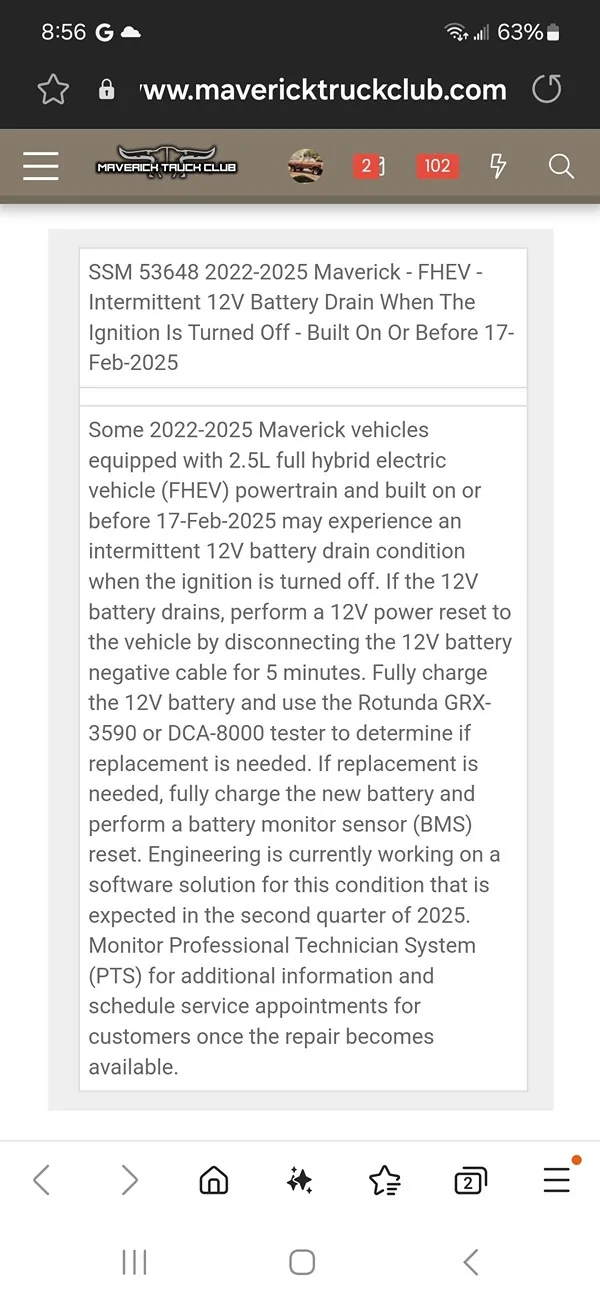

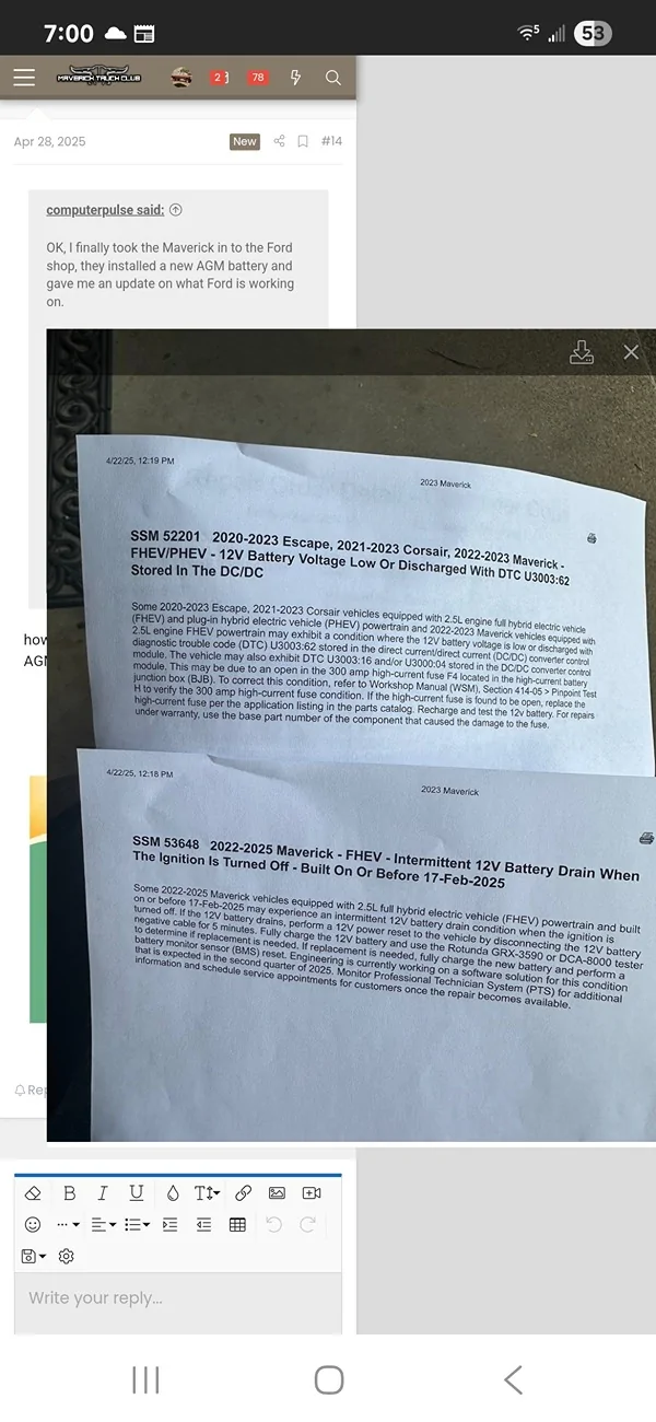

There are many SSM's and some articles with apologies from FERD and, of course, no fix. See the list and at some point you may give up as is their intention.

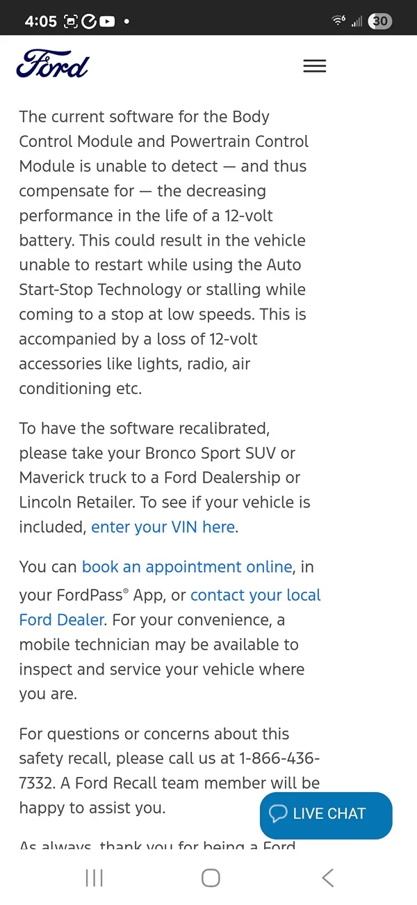

I believe there is plenty of evidence for a class action lawsuit. Any advice how to proceed? The first image is my work order with a previously unresolved SSM 553087. Called Ford Customer Service a year ago gave them my vin and they confirmed the SSM. But....I was told there was no information, at all beyond that. Nothing! More pile up.

I filed a complaint almost a year ago. They won't issue a recall unless it is a safety issue. Don't charge the battery to keep it going. They will only replace when the battery is below 40% capacity at 100% charge. You need to let it sulfate and fail. Carry a jump pack.
