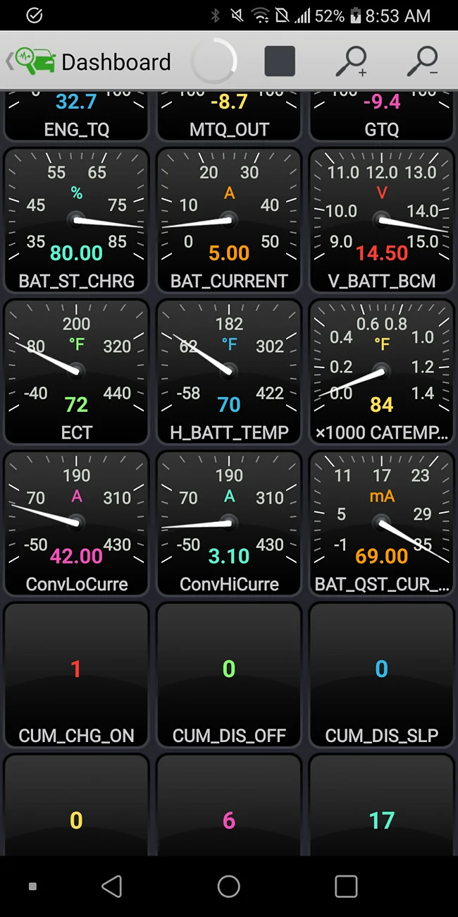

The proving if there is a noticeable battery drain isn't that hard actually.
They should be able to give you those figures after several on/off sleep cycles while they've had it.
The truck logs what the drain was after it goes to sleep. Next time they turn it on with scanner attached - they get the figure.
But like any vehicle issues - they gotta catch it - that's the hard part many times.
But the computer will report what it saw as max drain in milliAmps during the prior sleep period.
My Bat_QST_Cur reading below - Battery Quiescent Current at 69 mA is higher than supposed max 50 mA, but that's not going to cause a massive draw difference, unless it's always at that level when it should be dropping back to 25 mA for big chunks of time.
That's not even an LED light on though - so searching that down could be considered a waste of time when the impact would be minimal.
But that reading would point out when something is clearly very wrong, that requires more indepth troubleshooting.
(anyone else looking this over - 6 is my new battery age in days, temps show just started, and Eng_TQ shows ICE running, 12V Battery SOC is 80%, so only 5% away from fully charged.
So here already, start of a drive in the morning with good temp, only 5 Amps being sent to battery for recovery when they don't know how long I'll be driving. Perhaps that is the correct amps when only 5% away from fully charged. That is a topping charge already. Shockingly my cumulative charge is higher than discharge - but that was equal the next morning.)
Looking this over = I take the range of 35%-85% being the range of saturation charging. You are 5% away from finishing saturation charging. Perhaps installation of voltage regulator to lower voltage to float levels and have it activate at 85% (84? or ?) so the charging can continue at float. Let's assume programmer is targeting 85% being fully charged instead of switching to float. I have almost 3 years on very lightly driven 22 hybrid that sees Noco G5 every 4-6 weeks. A 30-40 mile drive will bring 12v to 12.6volts if down to 12.1v the following am and it stay there for 2-4 days if not driven. Let's assume that trying to float charge 12v at 14.6-15.6 routine is inadequate. Just a thought.....
So I've confirmed multiple times now - Ford's "SOC%" of 85% is fully charged.
They aren't using standard V readings to determine whatever that "SOC%" is defined as.
I agree that at the 85% the Amp reading is between 0 and 1, because it bounces between those 2 readings, unable to give a tenths digit. Right at a decent float charge on a topped off battery.
Great - that should work.
1st week - when it showed 80%, the amps was down to 5, 81 was 4, 82 was 3, 83 was 2, 84 was 1.
2nd week - it can't reach 80% already, dropping to 3 A around 77%. Like 80% is the new goal. But the 14.5 V in either case not great for float level charge.
So a voltage reading is only valid after no charging for awhile - obviously not while charging, or soon after.
So I'm assuming a valid V reading on 1st start of day - it knows about that.
Their SOC% seems to slightly follow that 1st start level.
But as you charge - can't use Volts anymore, so SOC is now mathematically done.
Since it can read the Amps going to the battery, it can track Ah, and if it knows the size of the battery thru the BMS relearn, it can deduce where the level would be.
IF it really knows the size of the battery, it can calculate that.
I think that step is off - it's got the wrong Ah size of the battery. There is a PID field for that - but for a owner-replaceable service item - they skipped giving an owner the chance to enter it wrong.
It's tracking as you drive what it thinks the SOC is, and that decides how many Amps to keep supplying - good principle.
But it's wrong. It can't keep up while driving because amps already too low with bad math.
Aggravating to watch it happen.
