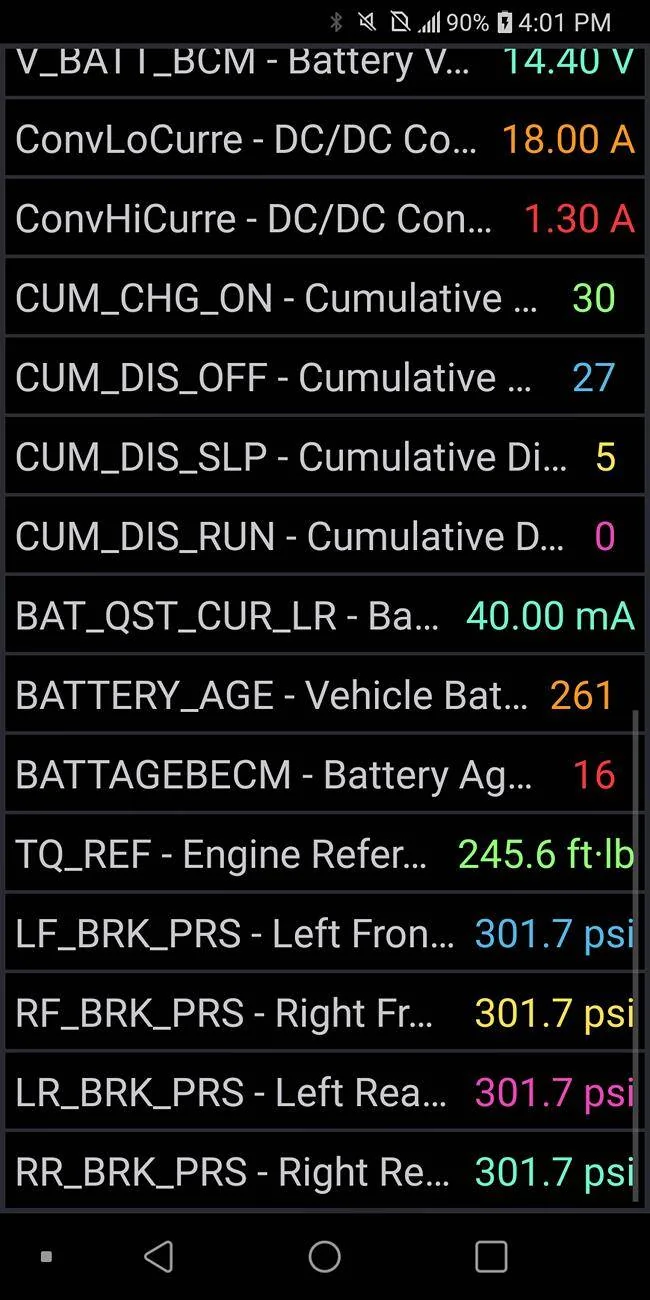

I've been tracking the PID for Battery Quiescent Low Range battery drain since I found it, after almost every long park - and scanning thru written notes it's a decent minority for the acceptable 25-50 mAh, but most of the short stops where it goes into sleep mode quickly and longer stops seems to be around 60-70 mAh. (but I'm not sure if the reading is a max or avg, but seems like max figure)
So it's not a huge draw after the potential 75 min max to turn totally off (except TCU).
More the problem is the willingness of system to not attempt to charge enough to equal or overcome the amount of discharge it tracks.
Now, only a negative balance of 2.x Ah (30 vs 32) over 261 days isn't that huge, but that's the point, the system should be able to charge just a bit longer at higher rates on each drive to make it equal at least. It had reached 3.x Ah near time of battery death. So perhaps all my charging logs is based on 2 bad cells and max ability for power to 4 good ones.
Then again I did the Battery Sensor reset last summer after a recharge in testing that recommendation (did nothing) so I lost the cumulative figures at that point, so it could be the initial 2 cells died during a more extreme difference in initial 5 months, and with 2 bad cells just couldn't keep up anymore.
I know a running fan takes Amps not mAmps, so pretty sure even the 27 Ah discharge over 261 days isn't likely a fan before sleep mode - maybe a couple times?
But really the system wouldn't need much to make it up anyway. Don't drop to 0-1 A charging rate within 15 or less minutes.

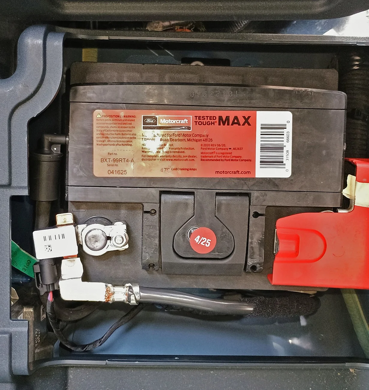

Yes. The replacement recommended by Ford was an agm battery with 470 CCA vs the 390 amps of the OEM battery.

I don;t think that you have an AGM replacement. The original blue-label EFL battery was lited as 390CCA. The replacement EFL battery is a larger 470CCA, with bright red labels. A Motorcraft AGM battery will have a black and white label with a part number starting with "BAGM-" and it will have 540CCA listed under the part number.
I may be mistaken. I'll check again to make sure. But I do know it's a 470 CCA. I do know that the Ecoboost batteries are replaced with an AGM when we perform the recall. Maybe I was conflating the two.
Nope, they replace EFL with EFL on the 22-24 models, and on the 25s, AGM with AGM under warranty.
For the Battery recall 25S02 specifically has us to replace the original EFB (ENHANCED FLOODED BATTERY) battery with an AGM BATTERY in the bronco sport and Ecoboost Mavericks. The instructions are to inspect the vehicle. If it has the original EFB battery or a NON FORD battery, then we are to replace it with a new AGM BATTERY. I've performed several. So I actually remember the technical instructions
