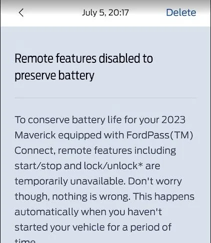

Guess what I got a few days ago...
Ford Maverick SSM 53801: 2022-2025 Maverick Hybrid 12V Battery Drain Issue Update Fix Released! 1752074853940-rq
But... I was installing a new subwoofer, had the battery disconnected, then connected, with doors open/closed, stereo on/off for the better part of the day. So I can't be sure all my messing around in the driveway caused this or if the SSM 53801 update failed to fix the parasitic draw.
I'll continue to watch, wait, report.

All that work is doing nothing but draining the 12V battery when connected - so sure it seems you can expect this result.
At least a new battery - you might want to think about charging it up since it's already lost a lot of it's charge, probably down to 50% SOC, doubtful it reached 9.5V at least.
After charge up - make sure locked for 8 hrs for BMS relearn process.
Did you actually have a parasitic draw that drained your battery in a day or two in the 1st place?
Or just the normal issue of low battery charge?
Considering deep sleep turns off the TCU, and you got a new ACCM upgrade, there's still a whole bunch of modules to cause a parasitic draw.
The manual for EB calls out shutting down misbehaving modules, not sure why the hybrid doesn't also. Maybe it does, just forgot to include language in manual.

Just the normal issue of low battery charge / deep-sleep notifications. Like others, the truck has never failed to start & run. I did throw a slow charge on the battery after I got the notification, did the BMS reset (plus it then sat >8h overnight)... and all good again. Plus I thump down the road with my new sub :D. [I can't believe how terrible the non-B&O base stereo is... but that's a different thread].
