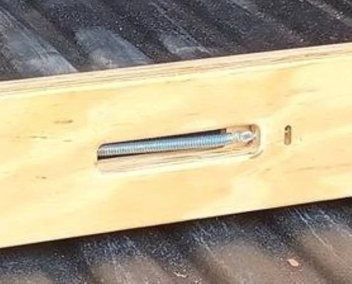

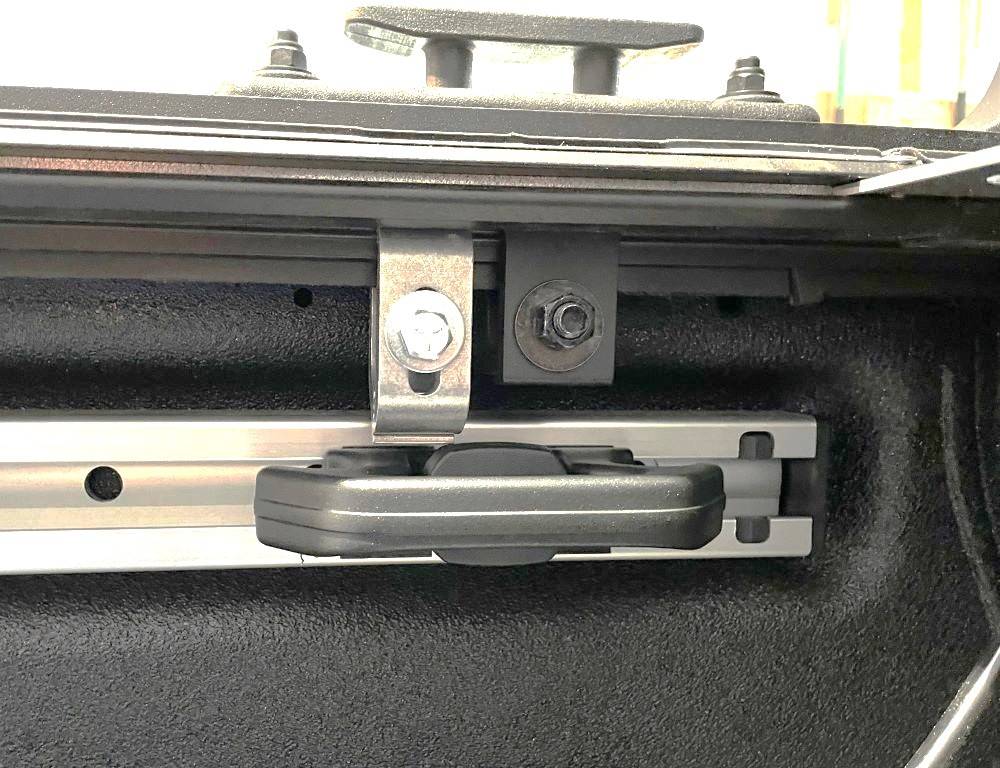

I like the Flex Bed, but with the side tie downs and a hard tonneau cover clamped on, but I found it hard to maneuver a 2x6 into the rear slot. I could have easily made a hinged board to fit, but decided on something more versatile.
Using a double thickness of 3/4 plywood I created a spring-loaded divider that could be used several places.
Pictures attached show it In the back slot, upper slot and even 90 degrees to the tailgate. I use it primarily to hold 2 Roughneck containers that give me maximum height with the tonneau cover closed.

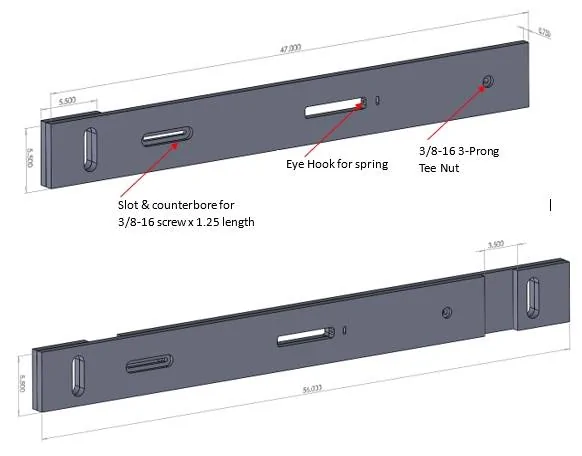

That is SWEET!!! But my old brain is having a hard time visualizing the spring (compression springs?) that must be sandwiched between the two sections of plywood. Very nice, very nice indeed.

Details. We need details. Drawing? How are the springs mounted? Etc, etc, etc. Pretty please.

Here are the basic dimensions I used, make the 2 parts and invert one of them. use 2 short (1.25 length) 3/8-16 screws but don't tighten them so tight the boards won't slide. Attach a stretch spring between the eye hooks and as you push the board ends together the spring has tension.

Which bed cover did you go with? I'm liking that the clamps don't block the rail.
3D Pro
Oct 1, 2023
82
O'Fallon, MO
2023 Ford Maverick
I am using the Bakflip mx4 tonneau cover
Elegant. I might make two of these. Thanks for sharing! 🙏
