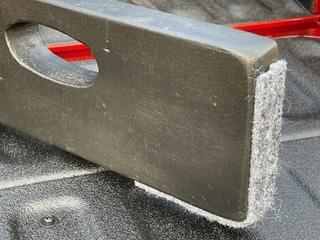

How did you get it in the slot? I had to cut some notches in the corners.
In the corners of the board? I did a lot of trimming to get the length just right. I also used foam pipe insulation at each end to help hold it in place tightly.

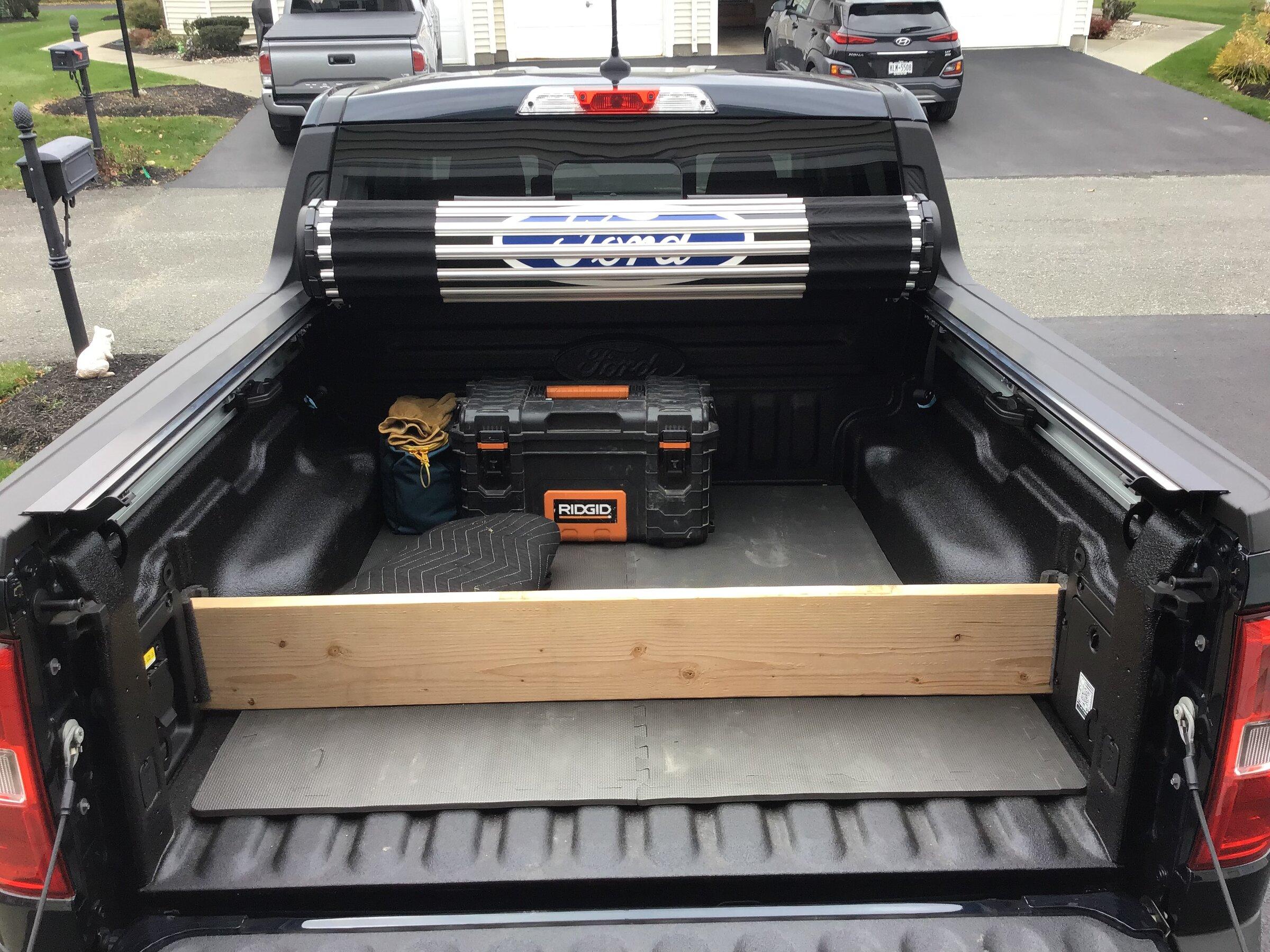

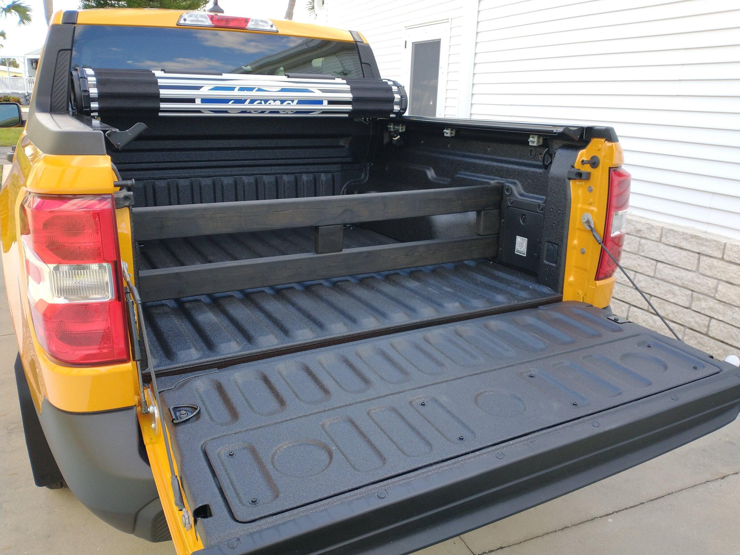

I had a couple 2x4s laying around. I hit them with some black wood preservative. Came out looking like a stain. Layed them in and inserted a shim to keep everything tight. Matches the Line-X pretty good. Groceries won't slide now.
Can you send a picture of the back? How are the pieces attached to each other?

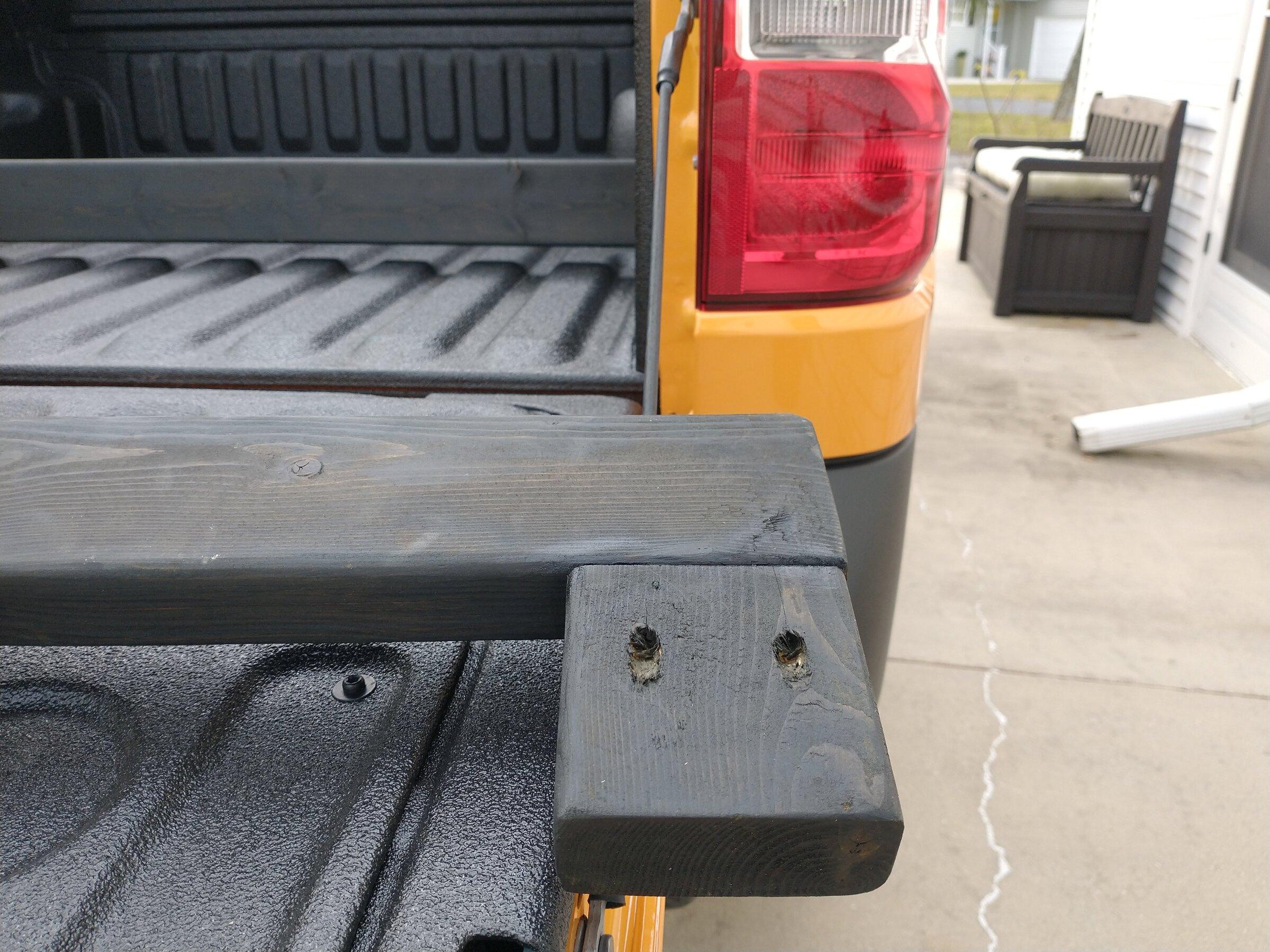

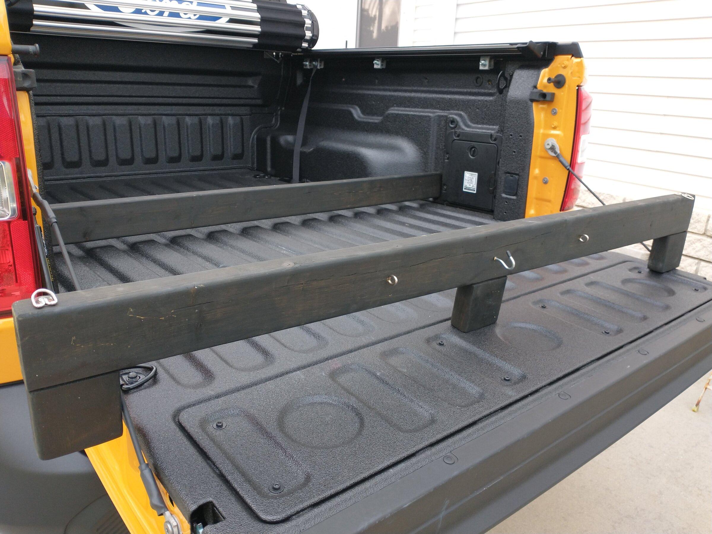

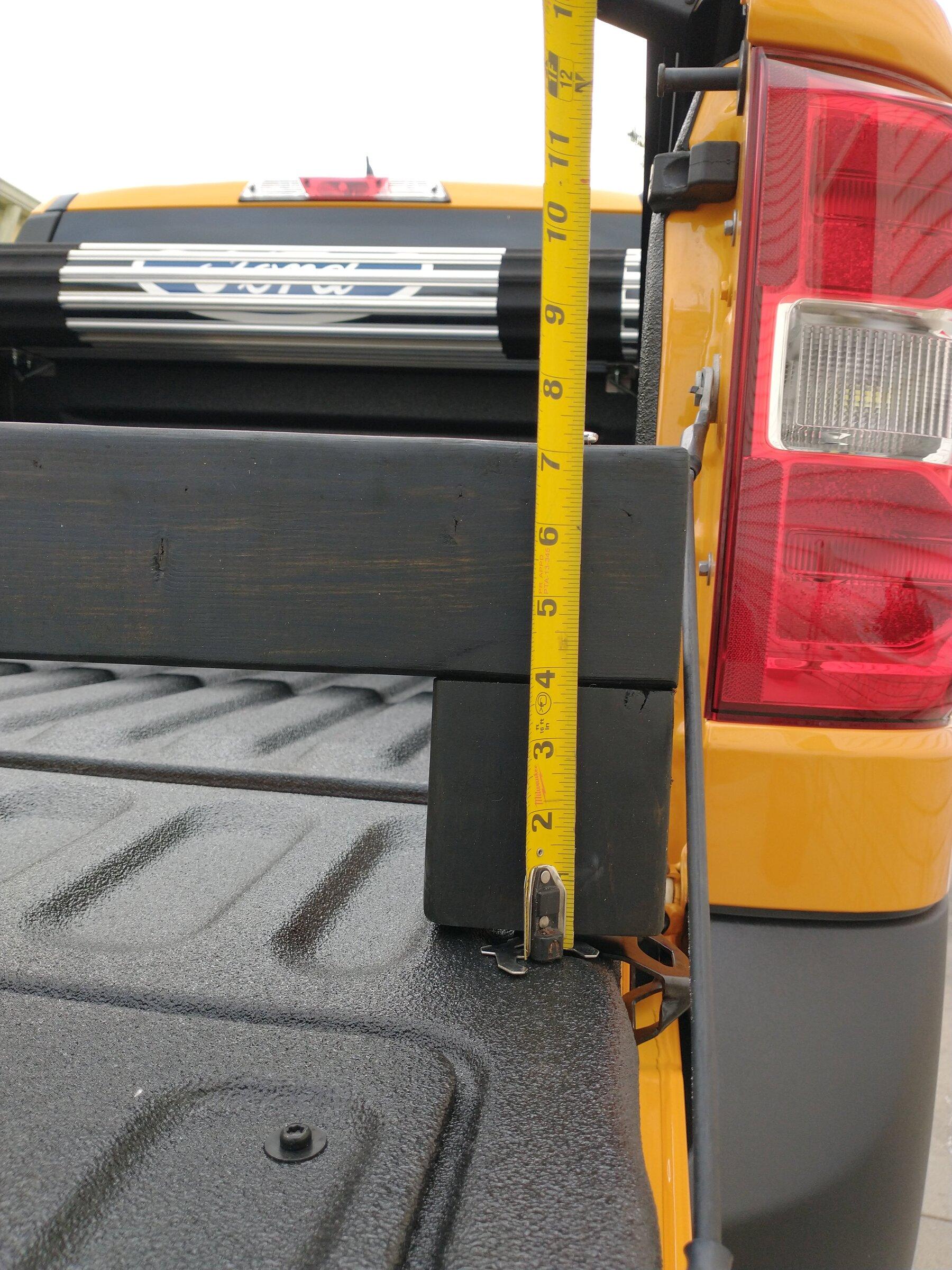

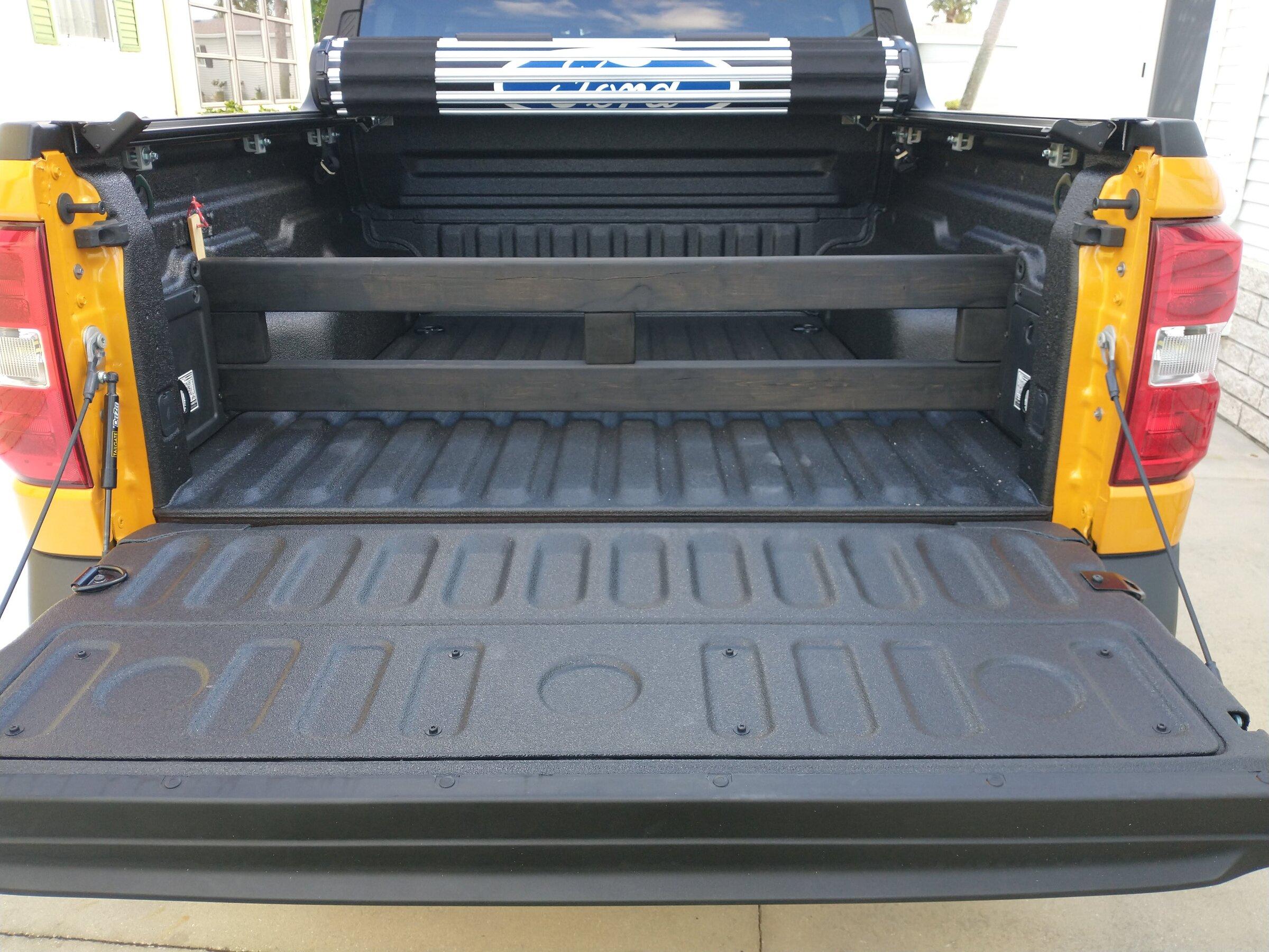

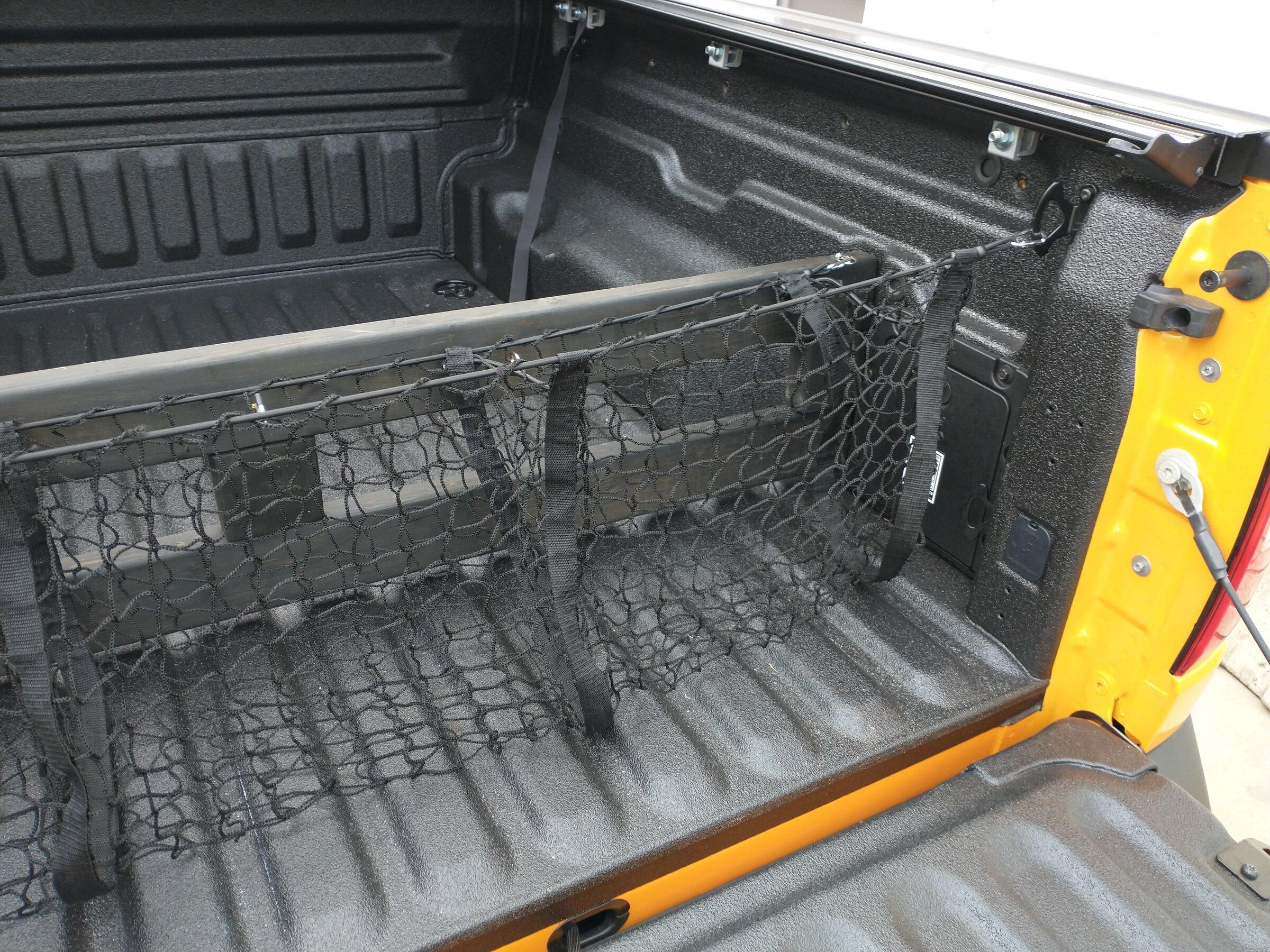

Two sections. Pictures attached. The 2x4 spacer blocks are glued and screwed. I attached a cargo net which works pretty good. Everything comes out easily when I want to carry something big back there.
I see you used pocket screws. Good choice. The glue was probably unnecessary since it wouldn’t add any strength on end grain.

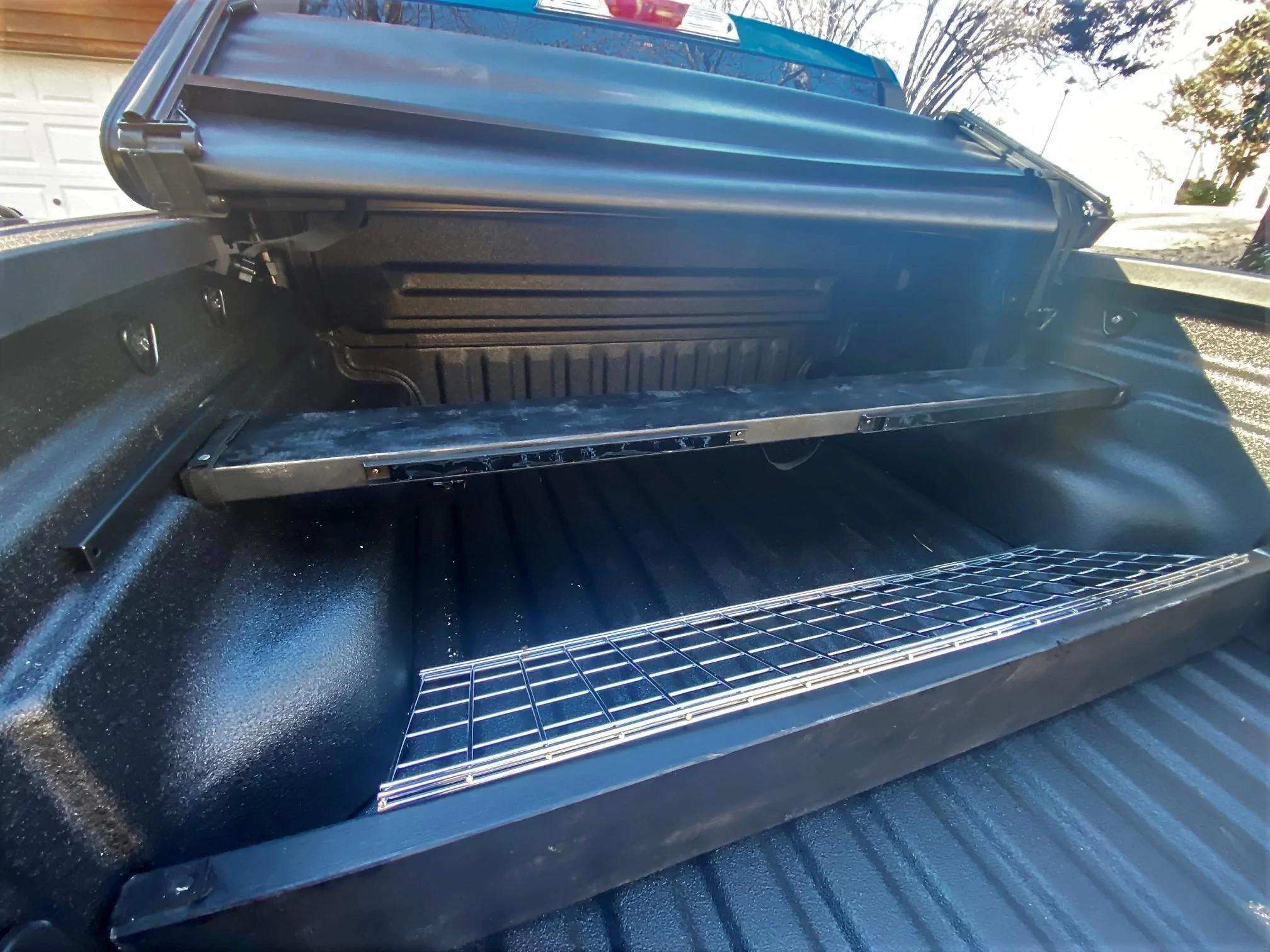

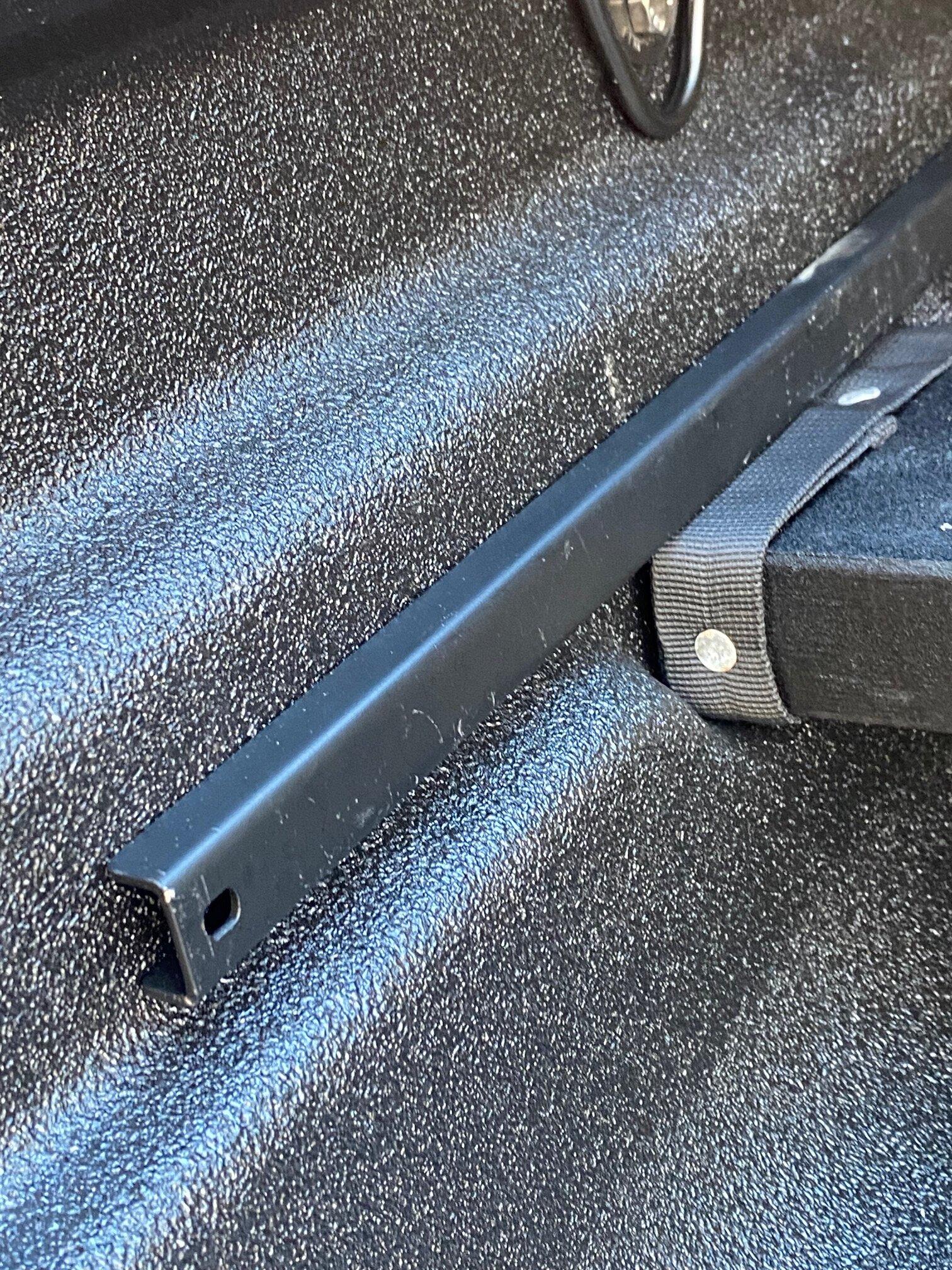

Did a trial run of 2x6's as bed dividers prior to bedliner spray and scratch the OEM paint...as I anticipated. Maverick paint is easily scratched in the bed. Took some used straps and wrapped the ends with strap so its flexible to add or remove strap as padding as bedliner is installed....makes snug fit that's easy to adjust and not scratch the bedliner or paint.

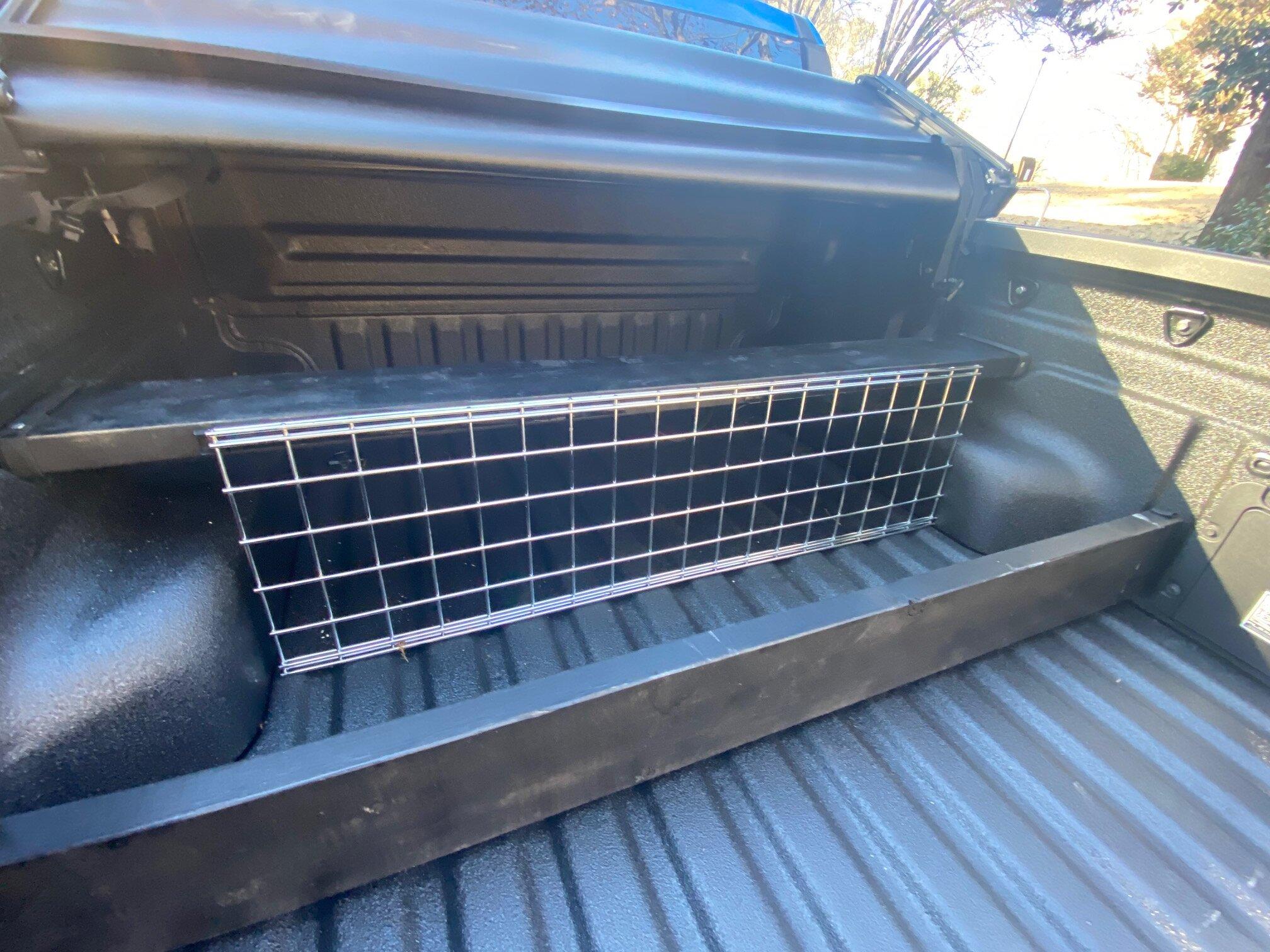

Holding 2x6 in place I used Harbor Freight magnet strips (US General - 18" magnetic strips) which carry about a 10 pound strength and cheap at $1.50 @ with coupons. Placed a magnetic strip above each 2x6 and their not going to move or bounce, takes brute strength to pull the magnetic strips off the bed's steel siding.. Screwed a magnetic strip to the side of the vertical 2x6 to hold an old junk pile "shelf rack"...making the metal rack removable since it's held on solely by the magnets, works well making it modular. Pictures attached.

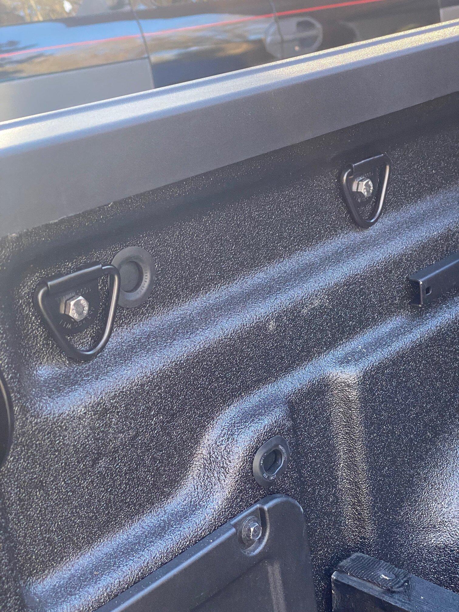

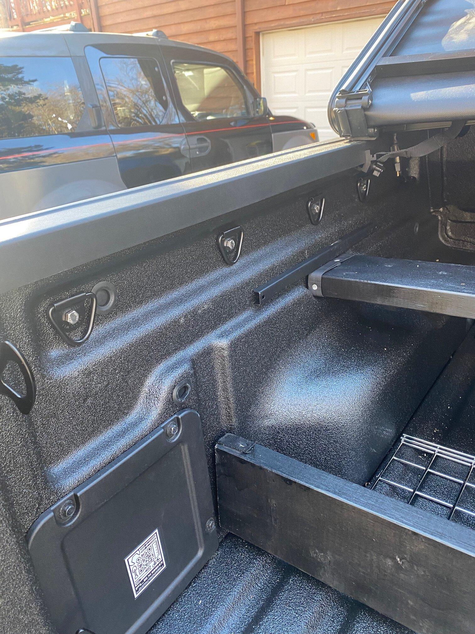

Was going to do a "rack rail" on both sides of the bed but once I got the Maverick I could see the pre-drilled holes are drilled into structural members and are plenty strong as tie downs without a rail. Amazon is a no brainer to get 8mm 1/2 stainless steel bolds and variety of single bolt hooks, not easy to find at hardware stores (chose hooks with maximum of 300lb strength (the lowest) hoping they will break-away before the bed siding frame bends. Tie downs & bolts were around...$19.00 for everything. Highly recommend putting in the bolts (ONLY) before getting a bedliner sprayed in...then back them out to install hooks...putting bolts in thru the bedliner filled holes would be a major project for a household level drill and keeping bolts straight.
Cheap HF magnet bars holding 2x6 in place below. Bed is steel vs aluminum and even with the thick layer of bedliner the magnets hold with brute force.
Footnote: really like the Gator Tri-fold tonneau. Minutes to put on and take off with no tools and very light weight to haul....so for no leaks.

8mm x 1/2 long stainless steel bolts with tie down loops. Heavy duty loops are the largest ones to accept a typical ratchet strap hook. For really heavy cargo I will use the OEM floor loops, as in motorcycle hauling.

Harbor Freight magnet strips holding 2x6 down...
Ford Maverick Flex bed dividers - Any one try bed liner spray on 2x6? IMG_0617
2 Magnet strips screwed into side of 2x6 to hold shelf rack...metal shelf can easily be pulled off when not needed.
Ford Maverick Flex bed dividers - Any one try bed liner spray on 2x6? IMG_0618
Metal shelf magnetically attached...ain't going anywhere when hitting speed bumps with two 10lb of magnet strips holding it in place, unless I need to remove it.
Ford Maverick Flex bed dividers - Any one try bed liner spray on 2x6? IMG_0619

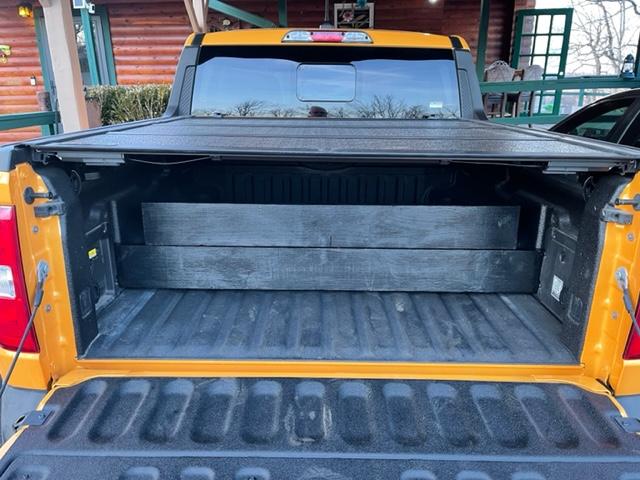

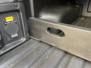

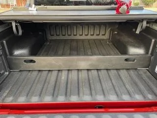

Used brush on bed-liner paint. Used 2 x 6s. The top board comes off and lays between the wheel wells when needed. It’s held together with dowel pins.

Like those handhold. Guess I need to get my saw out.
