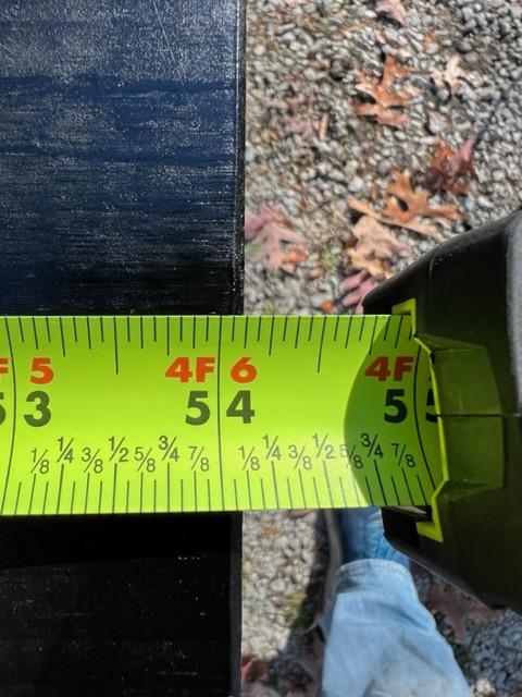

What’s the length measurement for the wood? Gonna go to Home Depot and get a 2x8 to paint but need the length to fit 8n the bed

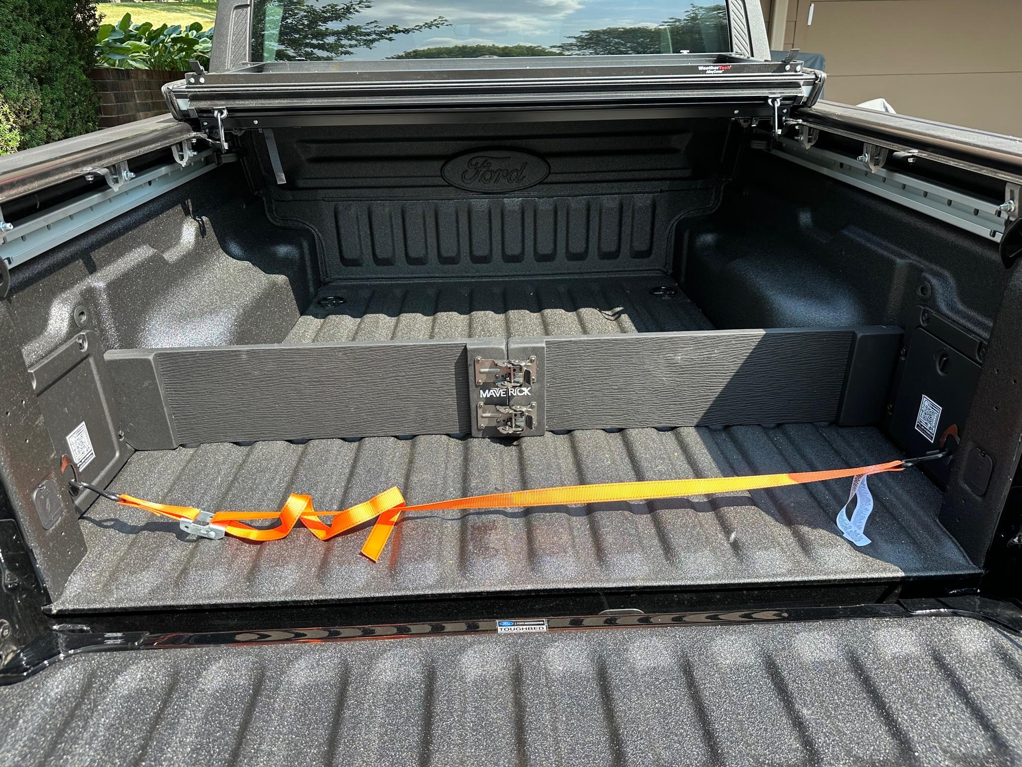

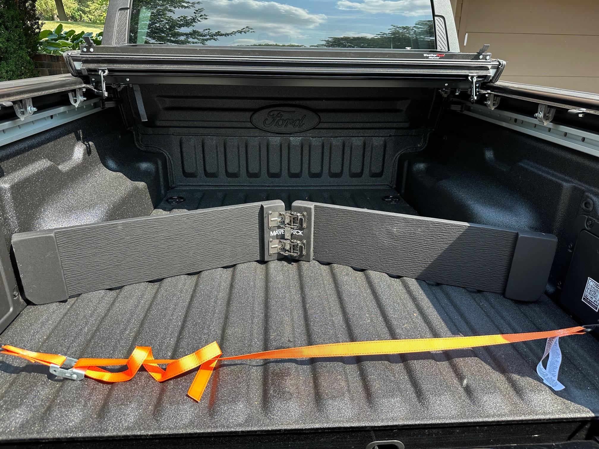

Well, here is my take on the divider made from a 3/4' x 7.25" x 8' PVC board. It has hinges in the center and painted in rattle-can SIBL.
Ford Maverick Flex bed dividers - Any one try bed liner spray on 2x6? IMG_4362
Ford Maverick Flex bed dividers - Any one try bed liner spray on 2x6? IMG_4361

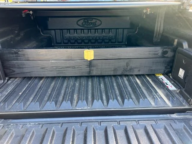

I had a couple 2x4s laying around. I hit them with some black wood preservative. Came out looking like a stain. Layed them in and inserted a shim to keep everything tight. Matches the Line-X pretty good. Groceries won't slide now.

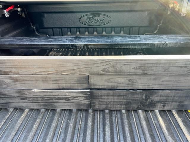

Not sure how it’ll do in actual use but I used yours for inspiration. The hinge will only let it fold in one direction so the direction I face them will depend on if what I have in the bed needs to stay near the cab or the tailgate. I used pressure treated lumber and just sprayed them a matte black. It definitely makes it easier to put in a solid board.
For the 2x6 over the wheels, I heavily sanded the bottom corners to round them which helped a lot in placing the boards and lets it sit more securely with the drop in bed liner.
