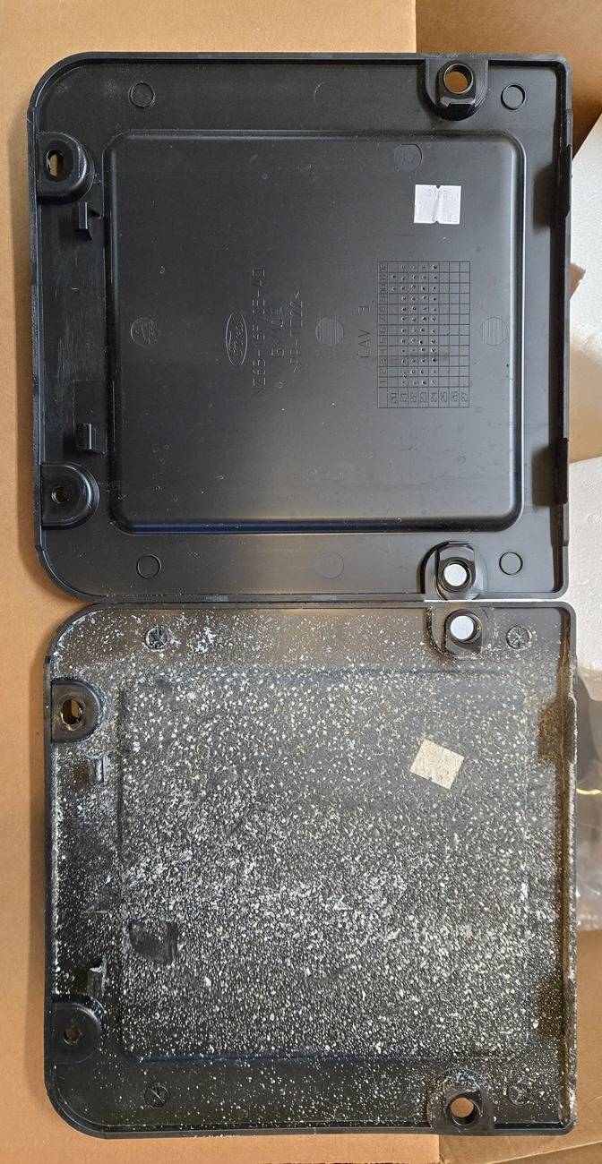

I installed two flexbed cubbies with a 12v outlet in one of them. In spring when it gets warmer, I plan to install an underbody cavety shield after a thorough clean (that's lots of road salt there sadly) and fluid film.
Here's a picture of the two covers where the cubbies went. Can anyone guess which one came out of the driver side, and which one was the passenger side? I bet you'll have a real hard time telling.
Ford Maverick Flex bed cubby .... underbody cavety shield 20250215_125940~2

I have cubbies on both sides too, and the driver's side has stayed much cleaner since installing the cavity shield, as you can imagine. The real telltale sign of the problem is when you see muddy water trails dripping from the bottom of the taillight on some Mavericks.
