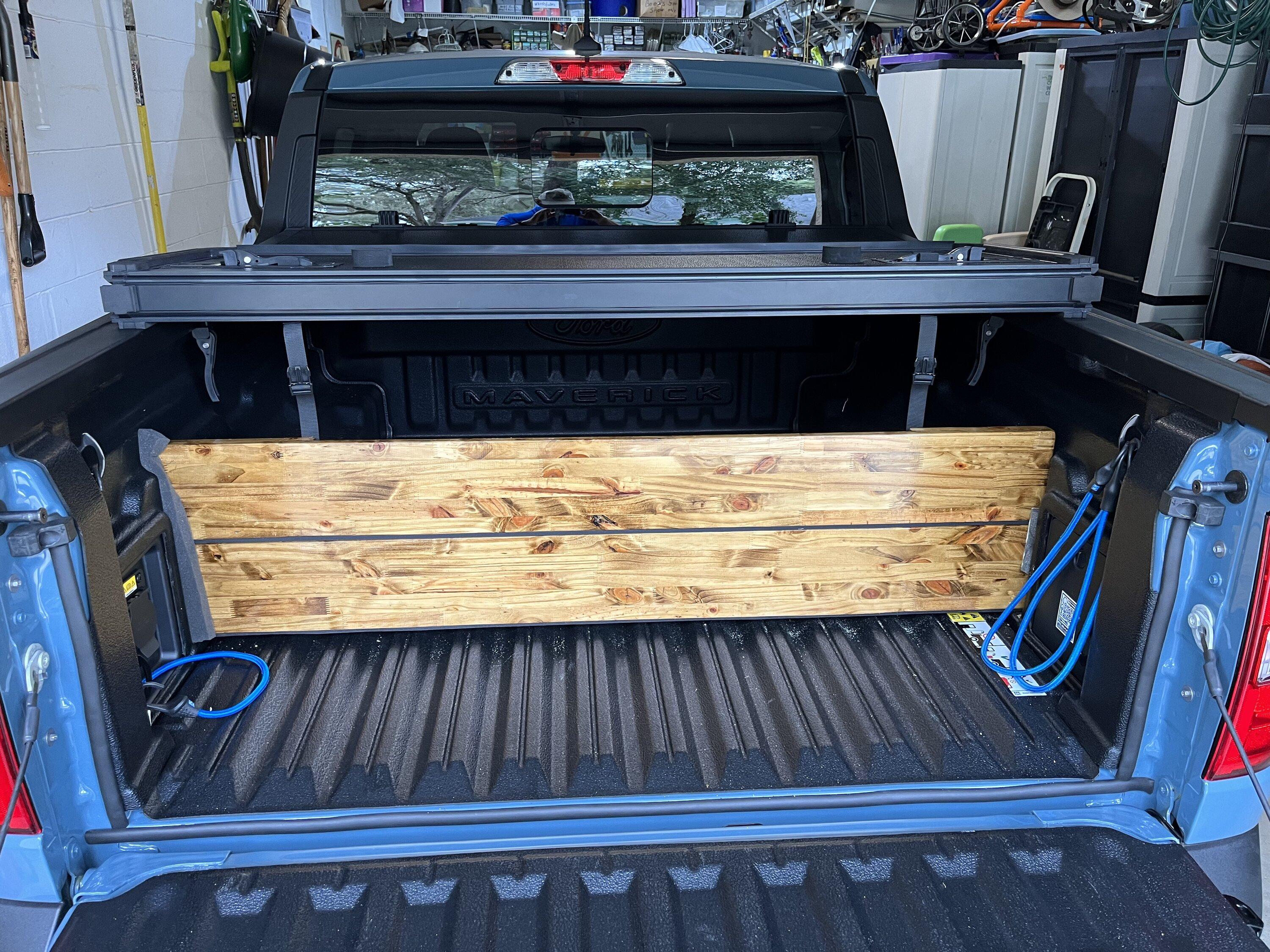

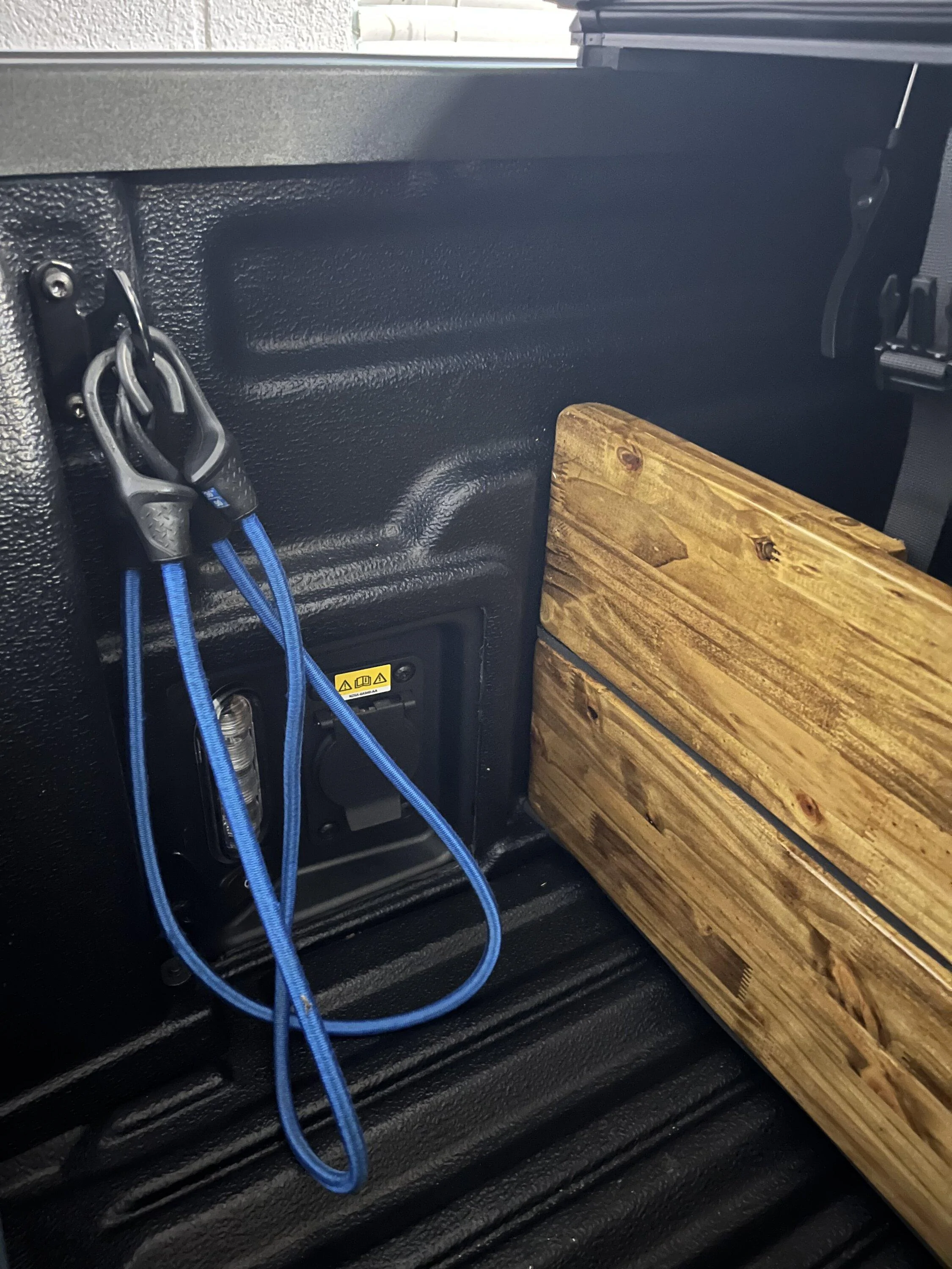

I could not find a commercial truck bed divider for Maverick. Those available are costly, so I made my own. Used a cheap handsome 1’ by 6’ shelf board. Cut to fit a bit loosely. Ripped shelf in have. Left over portions cut in half and glued, nailed and screwed to each bed divider end. Red stain and polyurethane added. Exactly what I was looking for. Lighter and easier to store and fit into place.

Hey, that’s very nice. Thank you. If I may, how much room is fwd of the divider, and how much is between it and the tailgate?
🤓 FWD to cab = a little over 3 foot. Folded Topper covers about half that space.
Divider to tail gate a little less than 16 inches.
Neglected to mention Red OAK Stain. Also rasped and sanded edges for I know as I wheel divider in and out of truck bed area that it will probably get marred. It is perfect for my needs.

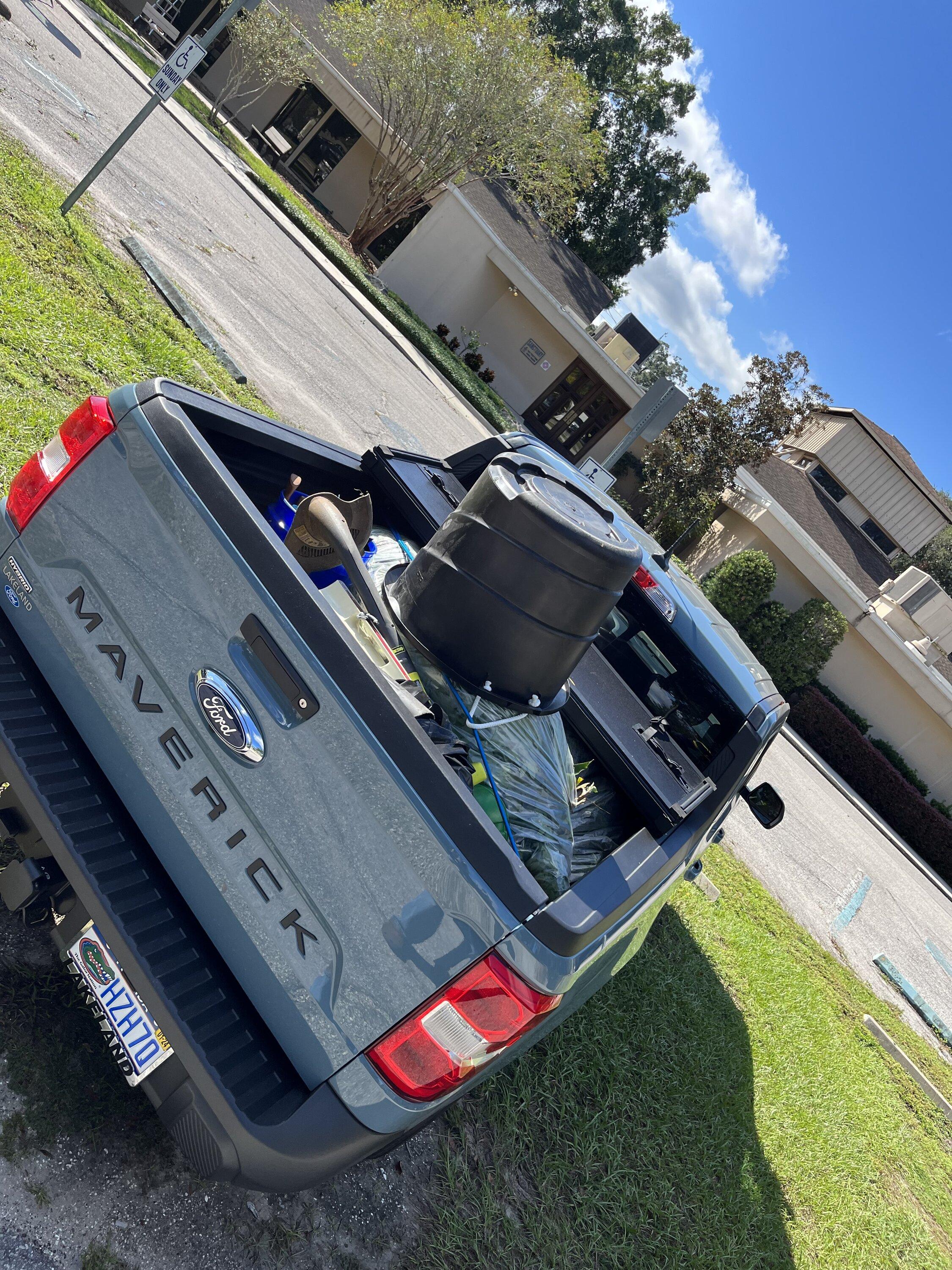

I really was looking for a car/truck (CART). This is more like a Truck/car. So for most of my toting needs, this small rear end space represents my new trunk. Also very functional for my Church work days where tools/supplies go in rear of truck bed, while accumulated landscaping debris in back. Topper a little in the way, but best options for my personal every day homeowner needs. I don’t live in rural area, don’t own boat or RV and don’t off road for need or fun. So no need to just carry air around in a normal size truck. My previous Toyota Pruis met most of my casual trucking needs, but not all. Also the rest of family needs a truck only on a few occasions, so this Maverick will be used by family members, as needed.

Outstanding! Thanks. Exactly what a truck should be.

It really looks great.
