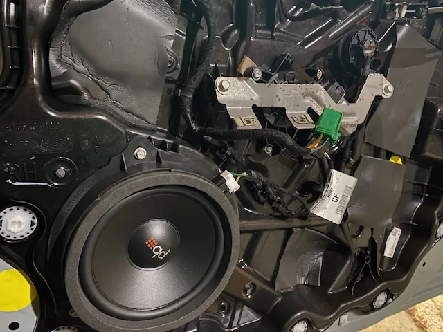

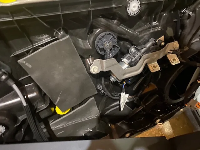

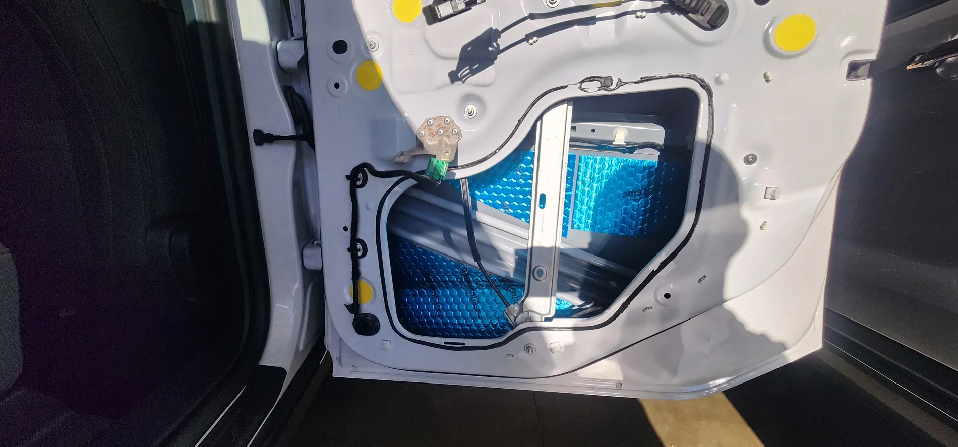

I added sections of 1/4" thick sound deadening where I could on mine, I didn't want to remove the window module. Big difference, no rattles!

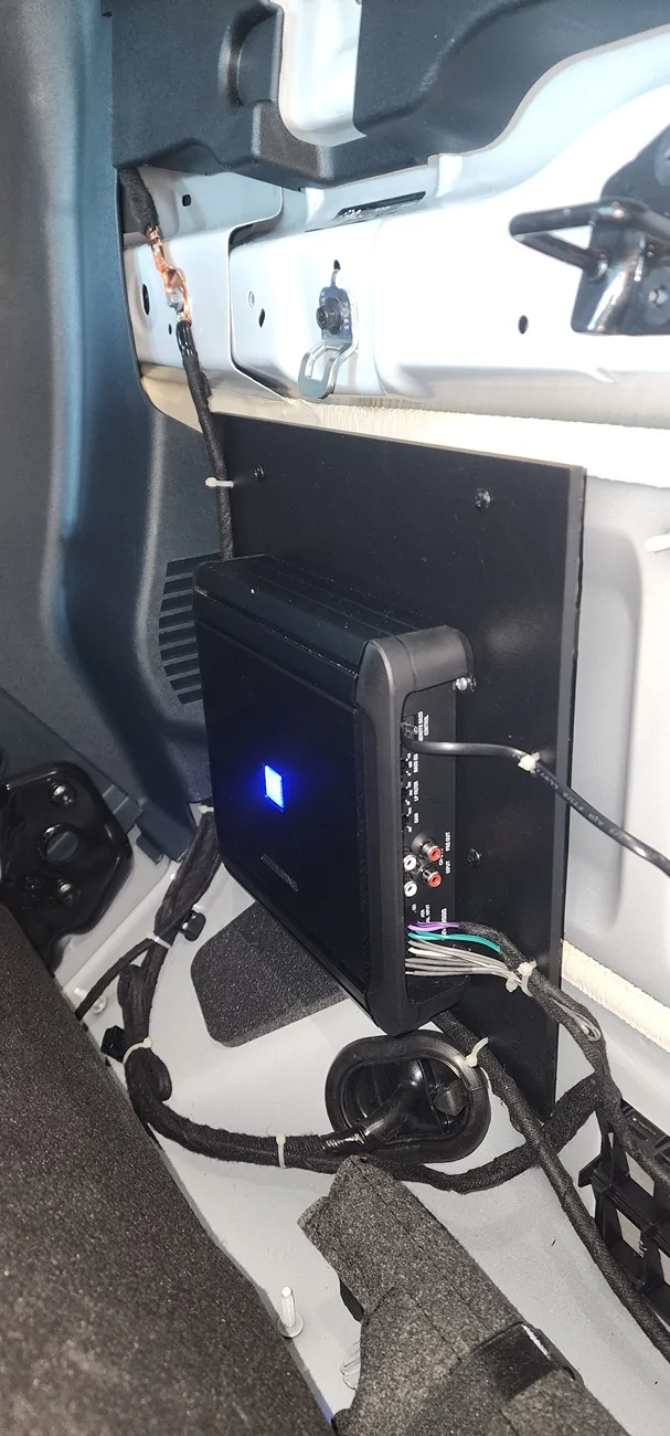

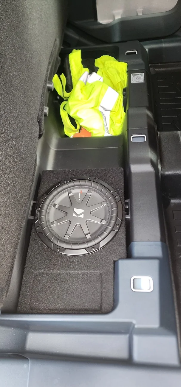

Yes if you upgrade the factory speakers with aftermarket it will be a big difference in sound quality.
Then if you like down the road you can add a aftermarket subwoofer either a compact kicker hideaway behind the rear seat or one in a custom enclosure on the left or right side under the rear seat in the storage area and mount the amp behind the seat.

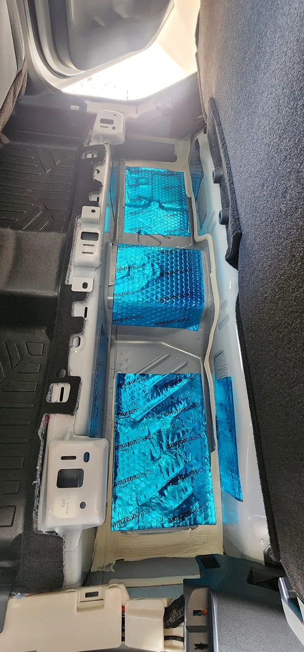

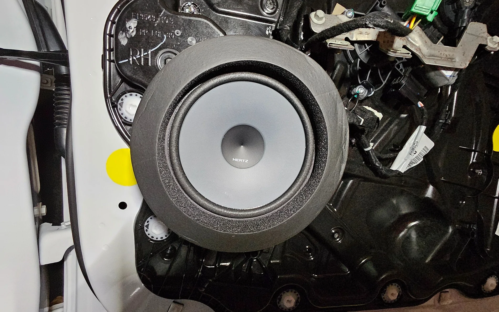

I upgraded the dash tweeters in front door speakers with Hertz components and the rear pillar speakers with kickers than I added a aftermarket kicker 10-in shallow mount sub in a box under the passenger storage compartment in my Alpine amp behind the seat on the cab wall.
Made a world of difference compared to the OEM crap speakers. If you have a little extra time and a little extra cash it helps to put sound damping material inside the doors in anywhere else you feel like taking the time to put it on the interior.
