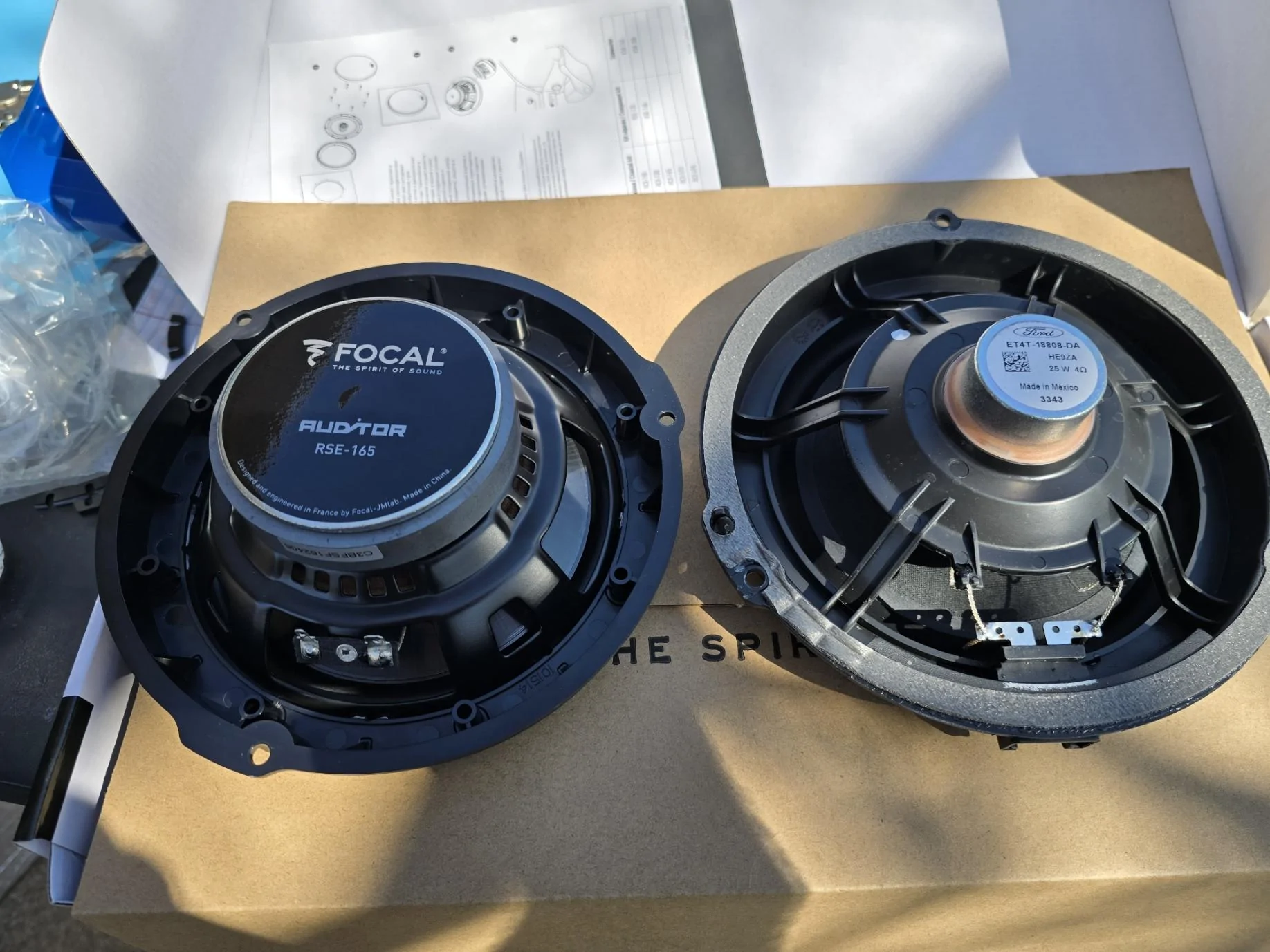

I'm not an audiophile by any means. But I'm gonna guess that Focal will have better sound just by size of the magnet. Ask me what a magnet does and my answer is better sound stuff.

yes, it has a hell of a lot more midbass and much cleaner midrange.
it is not intuitive but you actually don't want to crank up the bass tone control on the Maverick - either factory sound system - more than 2-3 notches. if you max it out you get a big midbass boom around 80hz and it sounds like crap.
if you want more low bass, install a sub or turn the volume knob. if you want a snare to hit harder, turn the volume up. (y)

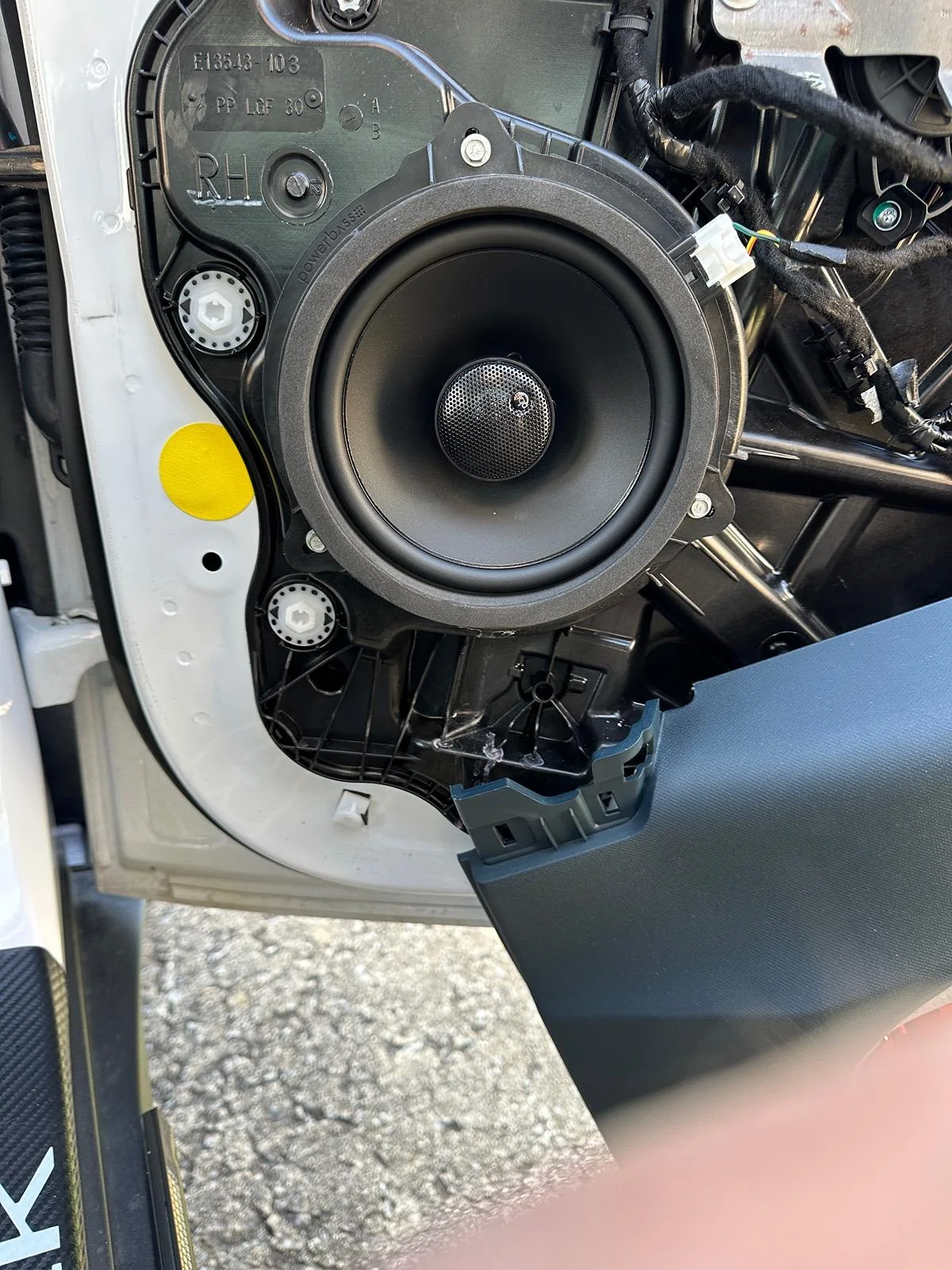

I did the Amazon kit, dropped right in, sounds better than stock. Couple of pointers. DON’T put excessive pressure on the door cables as they will snap the latch off and you will be zip tying them back. Next big oof was if the speaker plugs looks like this, it won’t work as it felt like it was in, but it wasn’t and you will be taking the door apart again( don’t ask how I know
