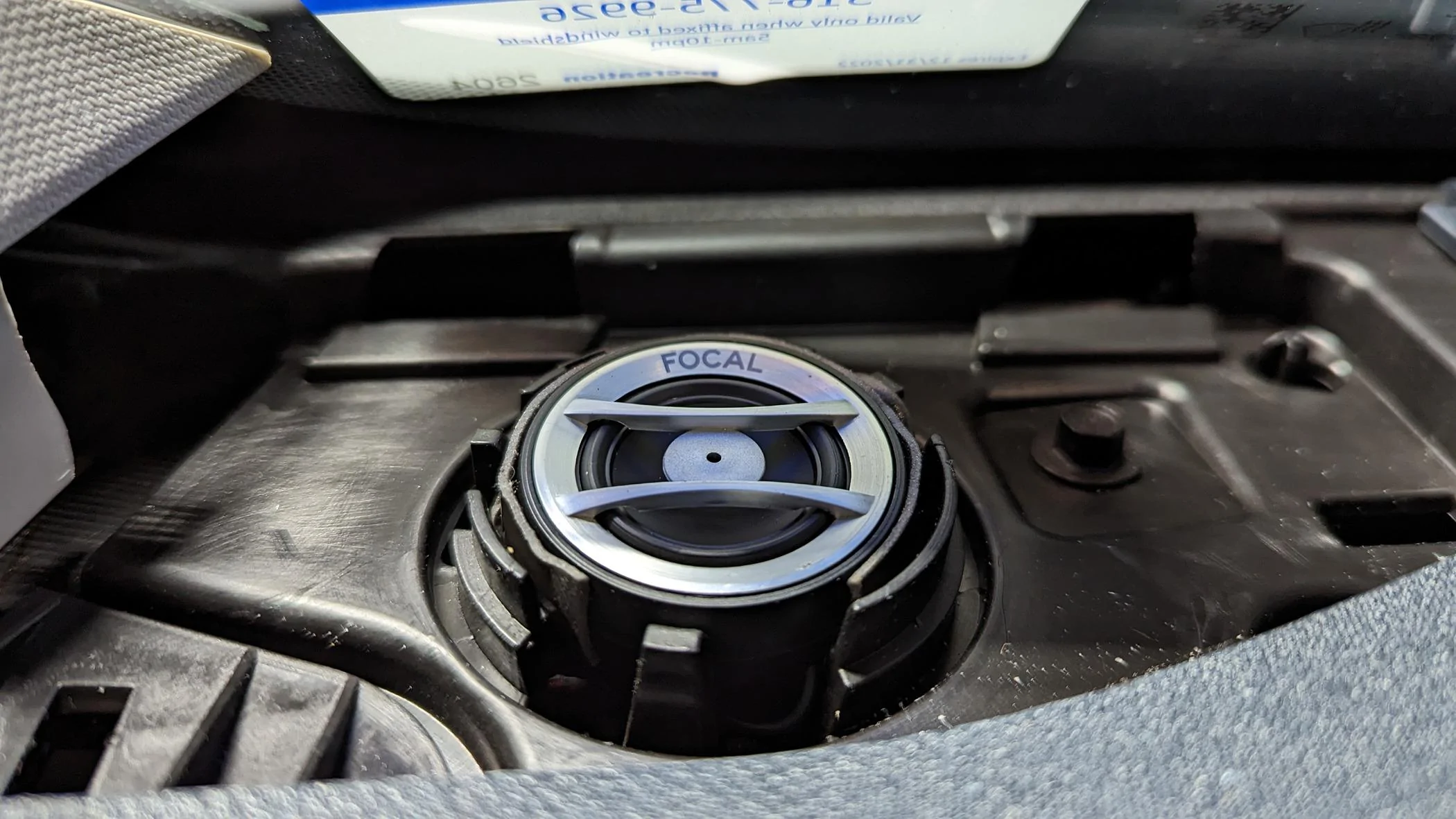

It's a swiveling trim ring that is actually pretty cool, as it would allow you to aim the tweeters if you were surface mounting them in the sail panel or inner door panel. But you don't need it for the maverick factory tweeter mount.
I tilted mine slightly as shown in this pic. Double-sided tape, yes. And this way you don't cut up the factory mount.
