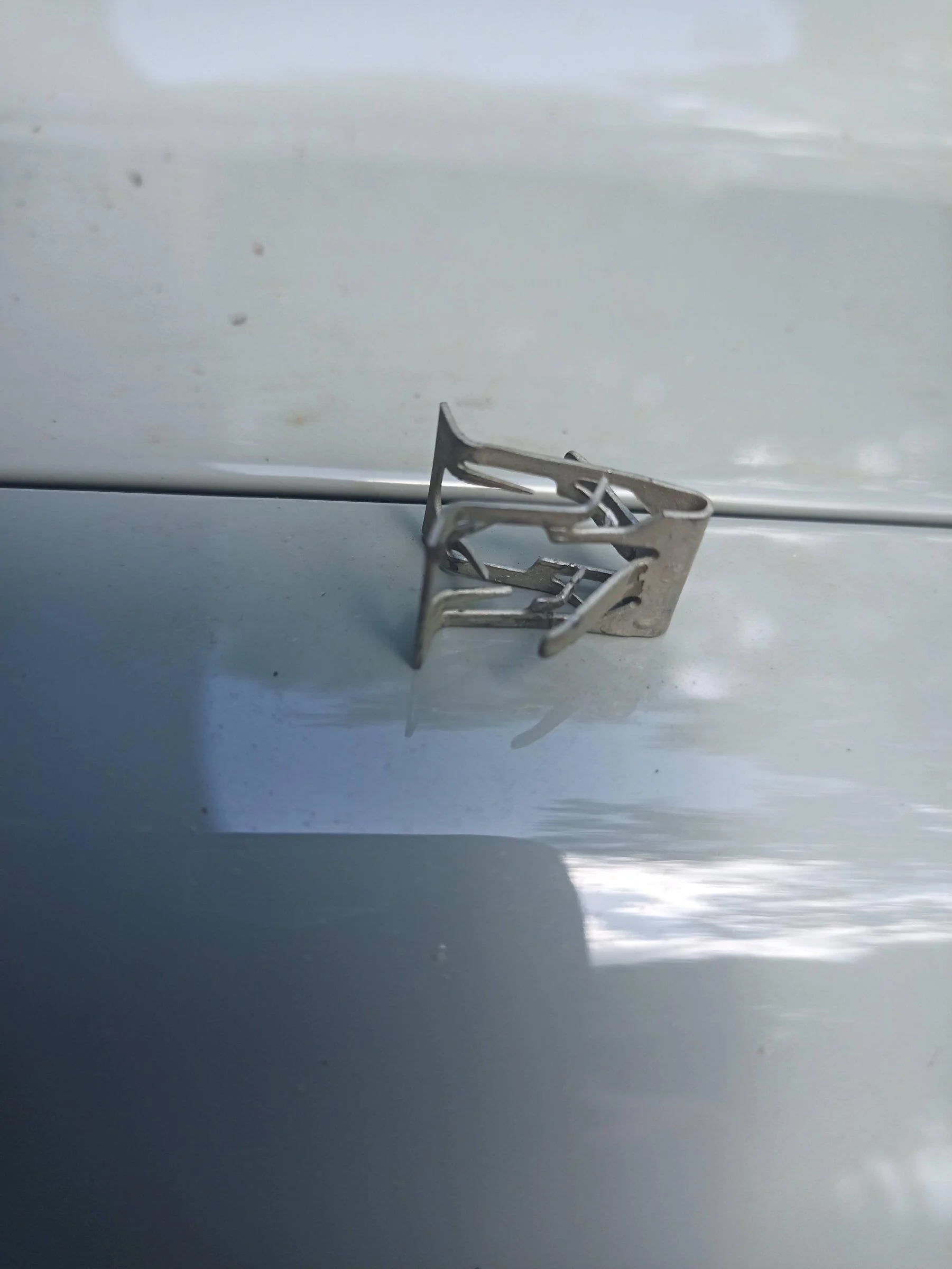

I used the Infinity Reference 4" coax bought cheap on ebay to match my Infinity's in front. They are a definite improvement.
The clips holding the plastic tabs in are awful. Don't bend the plastic tabs. They will break. The metal clips can be mangled then bent back in shape and reused. They hold on to the plastic tab using sharp little fangs that can bend get the tab out. It is okay. The outside bigger tabs should pop out a slot if you can push the panel up then pull out as is intended.
Ford Maverick Recommended Rear Speaker Upgrade? clip of death

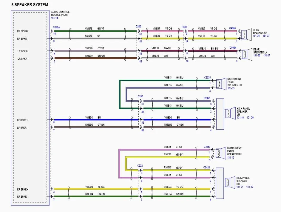

They sent that adapter with my Morel 4" I received today. It does not fit my Lariat Lux rear speaker connection. No worries as I already cut and spliced the wires installing the Pioneer g400's last week.
Wondering if the wiring is the same on the rears with B&O vs standard Lariat/XLT. I used the gray with purple stripe as Positive, tried as negative and it didn't sound right.
Also wondering if the rears are going through a crossover on the B&O. Still not loud unless volume is turned over 25.
Only thread I found said gray/purple was Positive at first, then they said it was Negative?

I was wondering the exact same thing. I also saw the grey/purple could positive or negative. I've been looking for the correct info and I can't seem to find what I'm looking for.

The Morels sound great, using grey/purple as Positive. Quite a bit better than the Pioneer g400's, worth the extra $40.

Ford Maverick Recommended Rear Speaker Upgrade? wiring 6 Speaker System
The grey and violet wire is positive according to this
