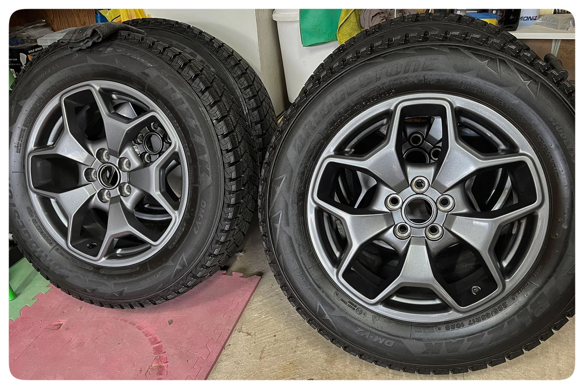

So my 2025 lariat with the black appearance package has 225/55-19” all season tires (never really been a fan of those rims) but the spare tire they give me is a 215/60-17” that is considerably shorter.
I just got a nice set of 17” Bronco Rims with Blizzack snow tires that are 225/65-17”
Now I just need to get rid of my 19” BAP rims for 17” XLT rims with a decent truck tire.
Then matching spares for each set. Never a shortage of upgrades!

That would be sweet to have a matching spare for both sets, but I've heard a real full size doesn't fit. That's something to try before you switch into the winters. What about the lug nuts? Do you have to upgrade them for the Bronco/blizzack set? You could probably trade your BAP wheels for XLTs.

After seeing what a hassle it is getting the spare tire from under the truck i now keep it in the bed. That may change when i start pulling a Safari Condo trailer.
Existing lug nuts will do for the Bronco rims. Hopefully i will start to see some XLT rims now that the colder weather is approaching.

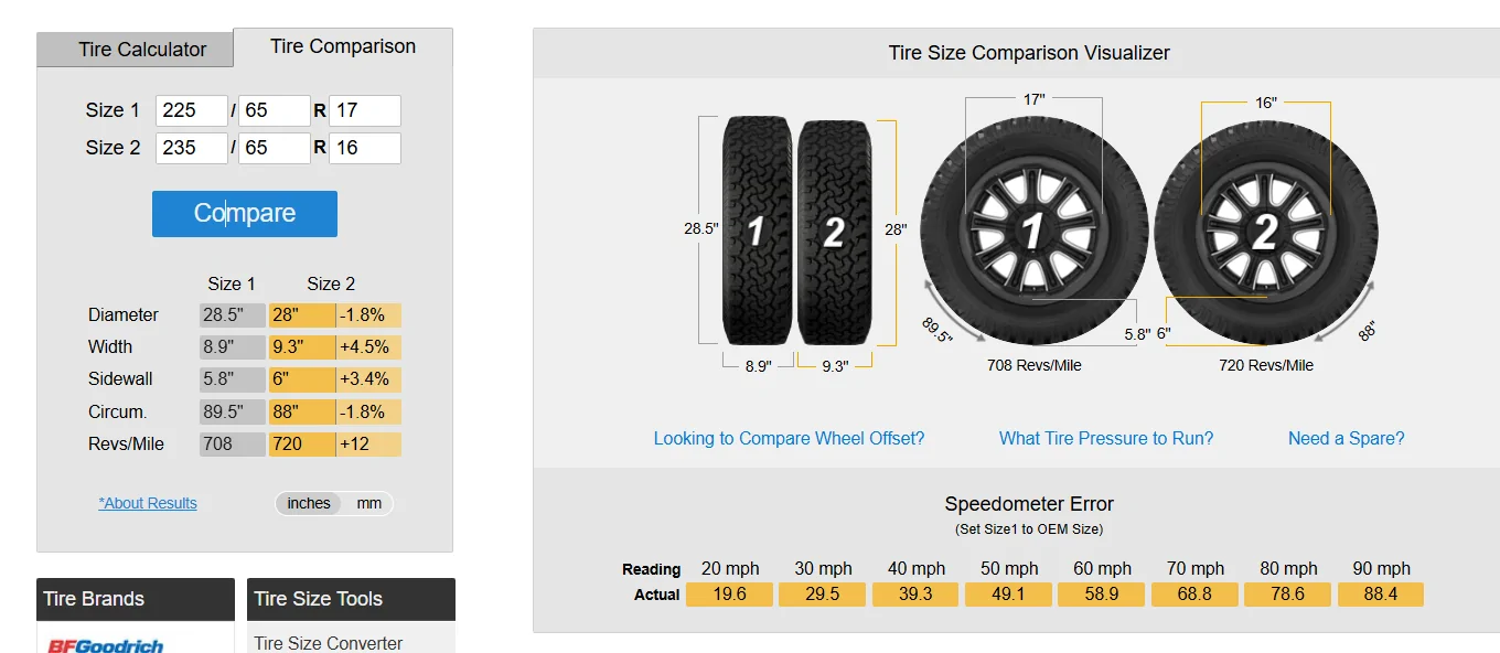

While checking my collection of tire chains the other day to see if I had any that would fit the Mav, I was surprised to find that the Mav tires are "bigger" than the tires on my Transit(not Connect) T250.
225/65-17 on the Maverick, 235/65-16 on the T250 (T250 tires are 10-ply, though, 80psi)
