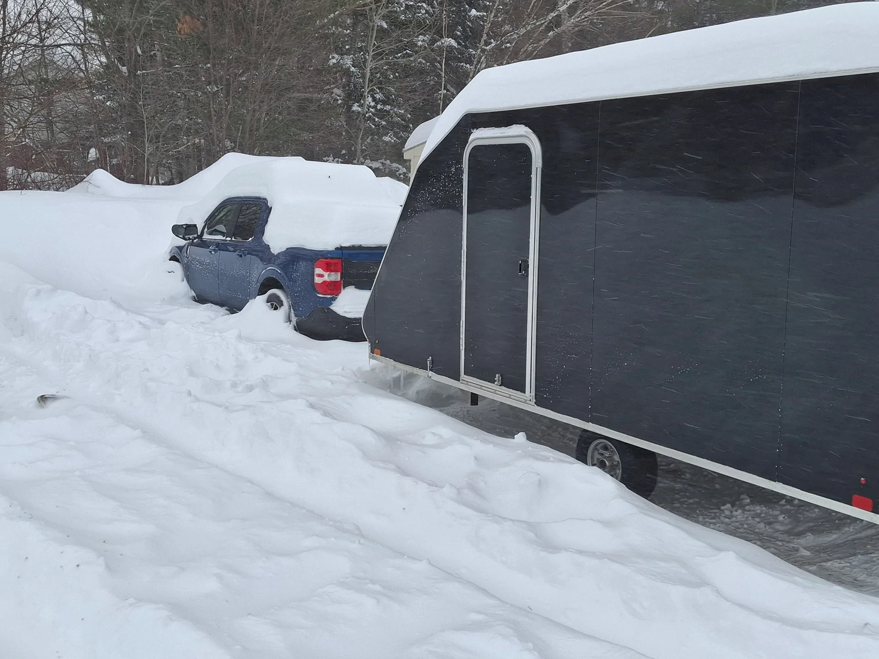

Snowtires are a must when your a snowmobiler and up in northern Maine and eastern Canada much of the winter. I backed right out of this mess, though did shovel about 3 feet behind each tire to make sure I could get started. lol

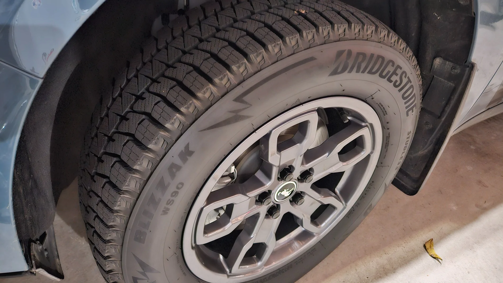

Absolutely 110%. Heck, I'd take a FWD Civic with winter tires over a 4x4 pickup truck on all-seasons. Winter tires stay soft and pliable in subfreezing temperatures and also have micro serrations in the tread blocks, which allow the tire to grip on ice.
Yes. You could get steelies from an XL, or 17" XLT or Bronco Sport wheels, or maybe these ones from Costco.
https://www.mavericktruckclub.com/forum/threads/25-xl-in-costco-rims-17-x-8-impulse.65684/
You’ve hit the nail on the head here. These are more aptly called winter tires or ice tires, rather than snow tires.
Ever watch snow wheeling videos or videos of Arctic trucks in open snow fields? Are they using Blizzacks? Nope, they’re using massive mud terrain tires for flotation and large open tread blocks to prevent clogging of the tread pattern.
Blizzacks have silica -sand- in the tread pattern to increase friction on ice and thousands of tiny sipes to increase the wicking away of melted water to prevent the ice skate effect, where the skate is sliding on a thin film of water. Blizzacks are all about ice traction.
