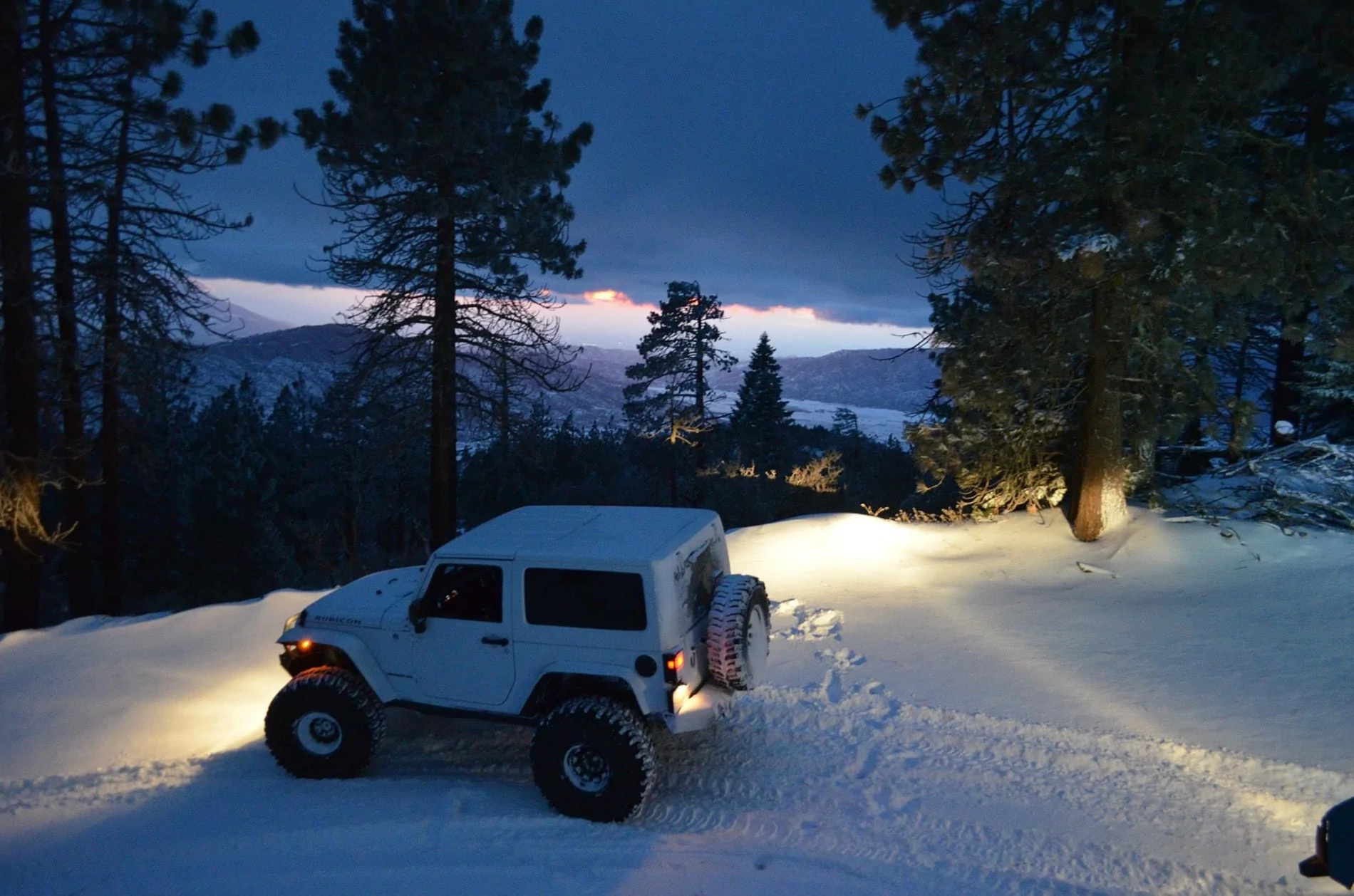

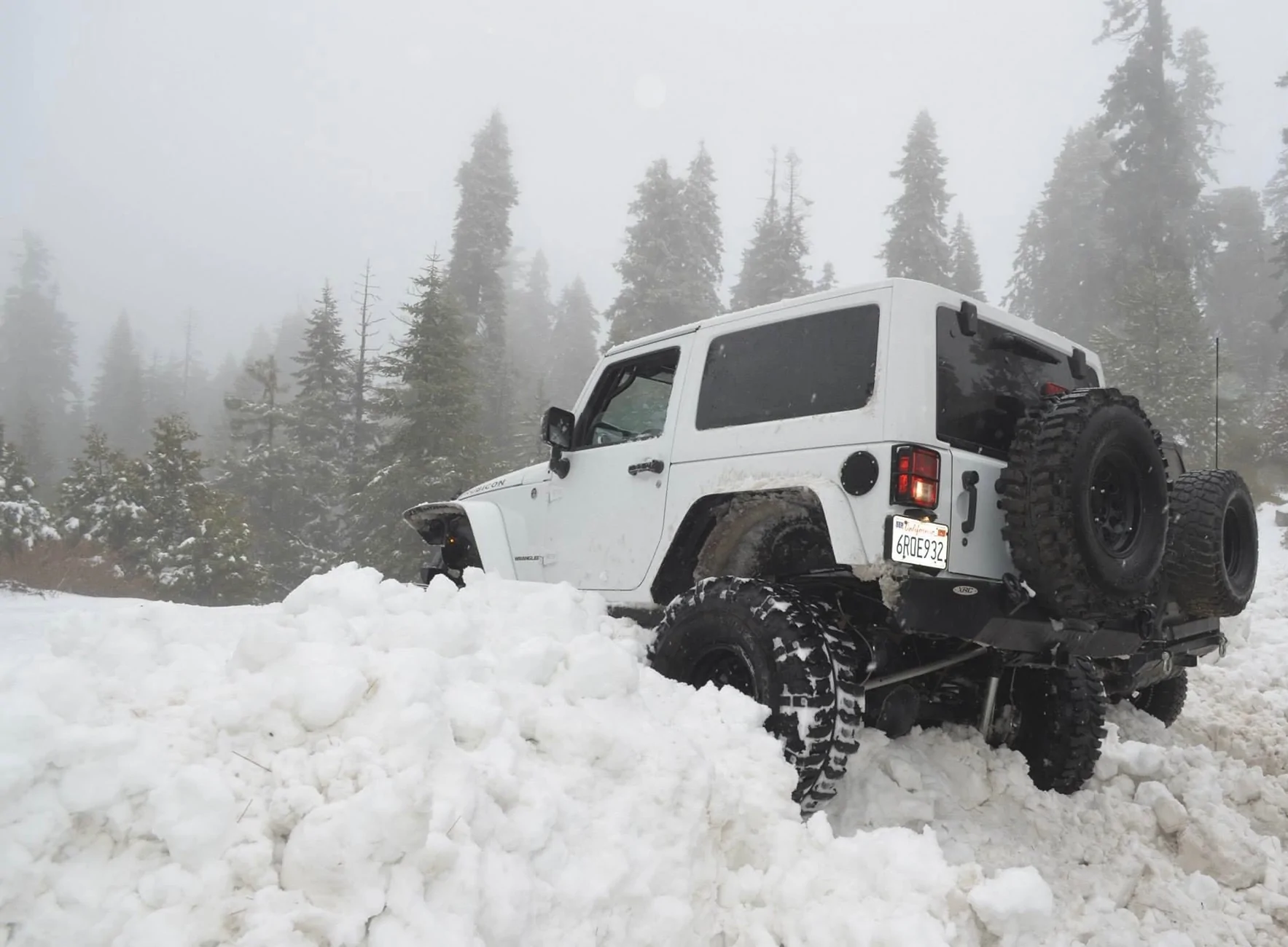

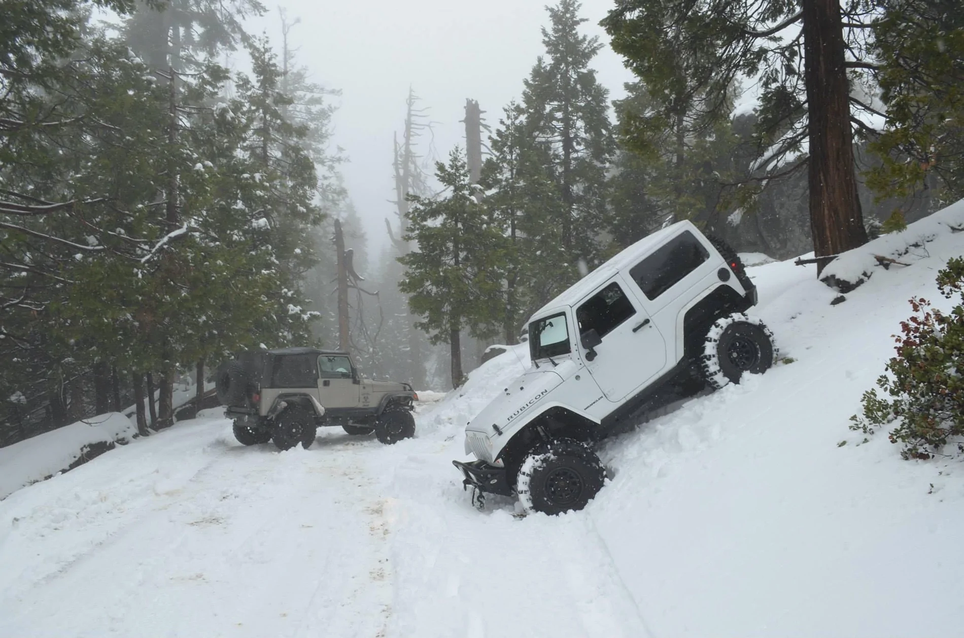

Likewise, for “snow” driving on roads, it’s not the 8 inches of snow that are giving traction, it’s what’s underneath it; pavement covered with a layer of ice. It’s the ice traction that is important.
Also, when snow wheeling in places that get 120+ inches of snow per year, you’re not digging into mud underneath the snow. You’re digging into packed snow that is under the fluffy snow. And mud treads still do well with packed snow.
Ford Maverick Do Snow Tires Help IMG_9695
Ford Maverick Do Snow Tires Help IMG_9694
Ford Maverick Do Snow Tires Help IMG_9696
Plenty of times where you’re just digging into snow and not mud.

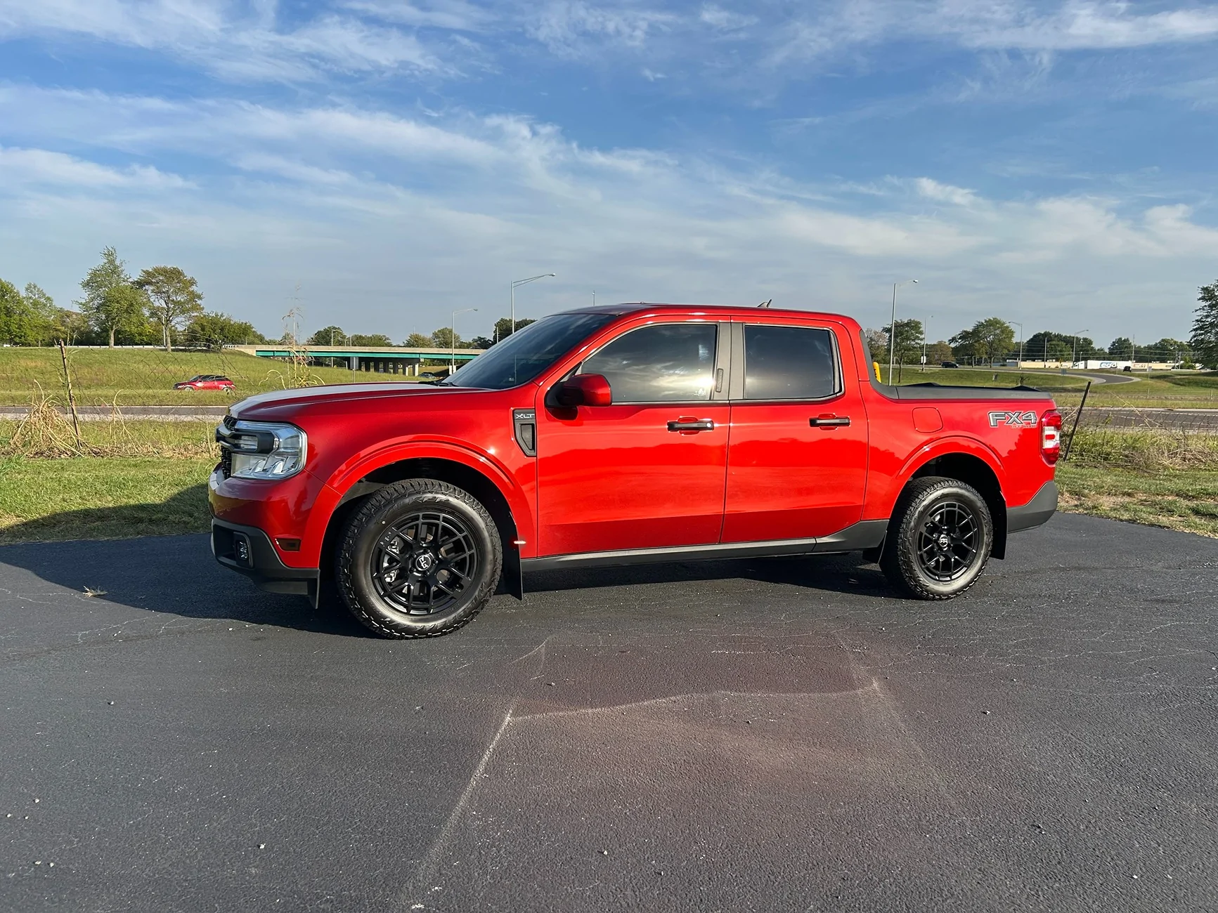

......One more question... Will 17s fit a 2025 AWD hybrid lariat 4k?? My research seems to say yes but I'm not 100% sure.
Yes they will help and yes, 17's will fit a 2025 AWD hybrid lariat with the 4K TT option.

You just need a 17" tire with an aspect that matches the 18" diameter. You'll have a bigger sidewall on the 17" which may help ride comfort and pothole damage resistance.
You can search for tire diameter calculators to find your numbers.
I like the better ride part!
