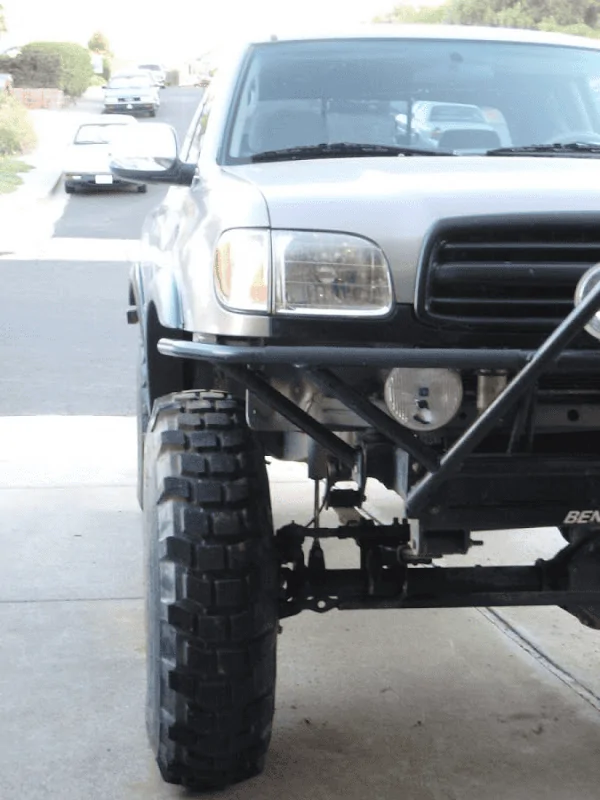

lol, that’s what my old Chevy truck looked like with farm tires. Doubt it will be that bad :) Although I must be old cause I don’t mind that look.

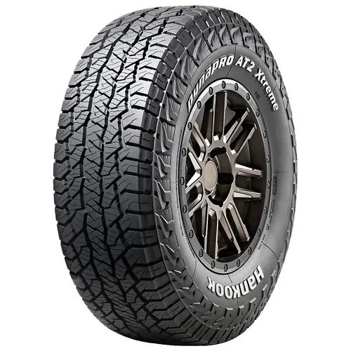

So I found these today - $100 rebate available
https://www.hankooktire.com/us/en/tire/dynapro/at2xtreme-rf12.html
https://www.walmart.com/ip/Hankook-...132366?wmlspartner=wlpa&selectedSellerId=7125
Ford Maverick Skinny and tall - why not? dynapro-at2-xtreme-rf12-tiresDetailsFormat
30.2 inches diameter - perfect fit (I'd think) for a stock non-lifted maverick (1.7" taller than stock)
8.4" Sect Width (.6" narrower than FX4 Pirelli 225/65/R17)
6.9" Tread Width (.3" wider than FX4 Pirelli 225/65/R17)
41 lbs (a little heavy compared to the Toyo 245/70R17 35lbs)
688 Revs per Mile
15/32 Tread Depth
