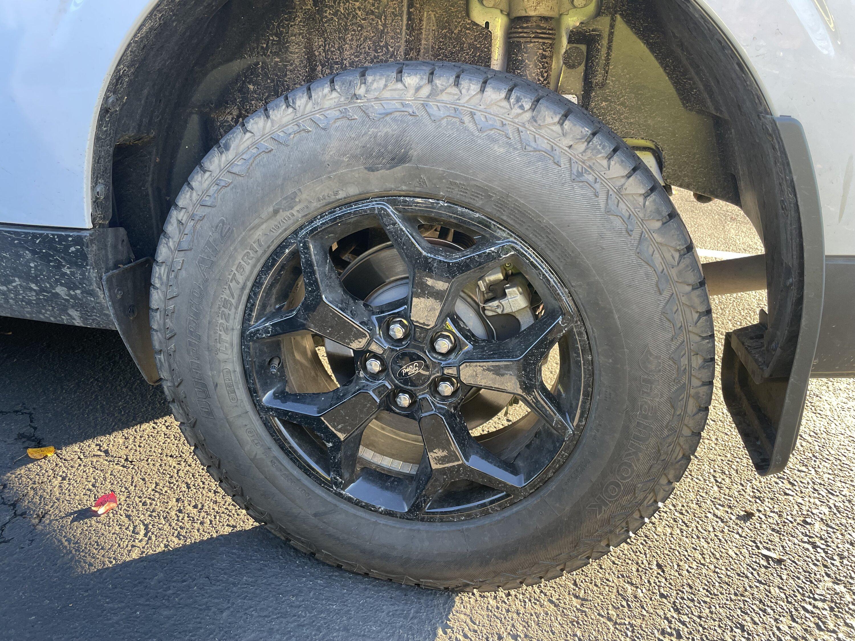

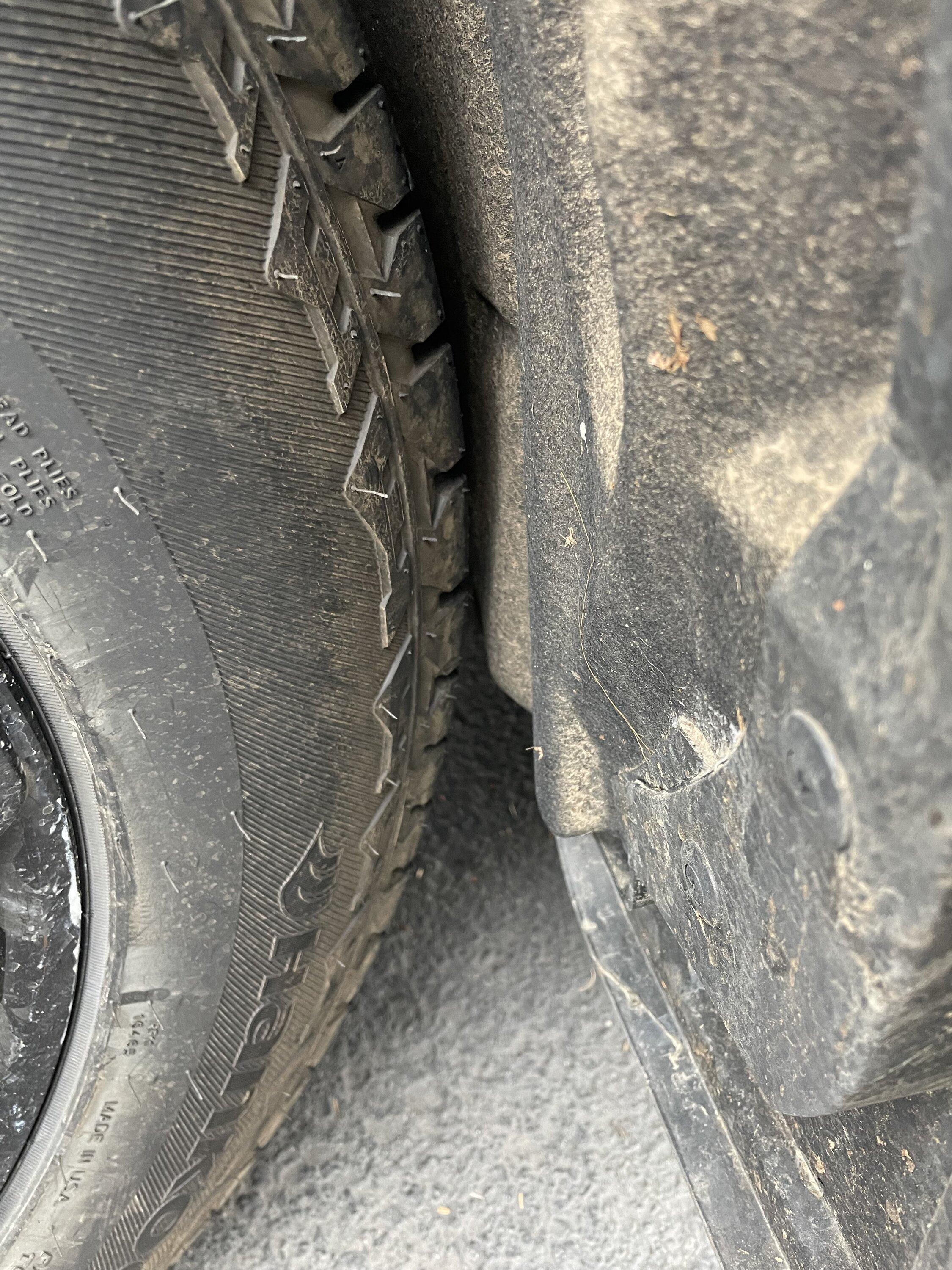

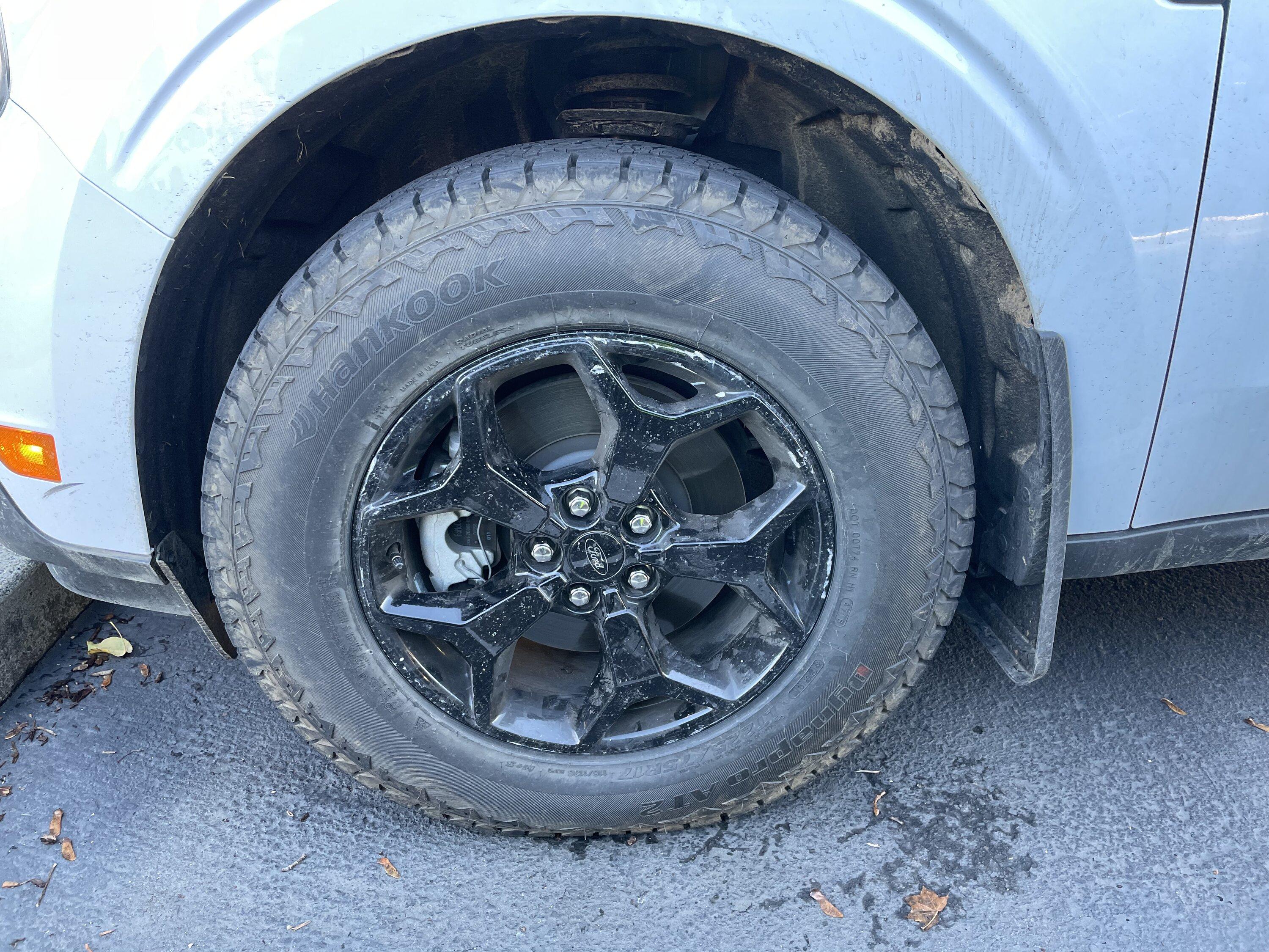

Great great thread. If I can only find an 225/70R17 (yet to be successful), I would do it in a heartbeat. 225/75R17 - me waiting for a braver soul to try it out and report back.
Hello everyone! I can attest that the 225/75r17 Hankook Dynapro AT2’s do indeed fit my FX4 without a front lift without any pinch weld manipulation. Your welcome!
pics!!

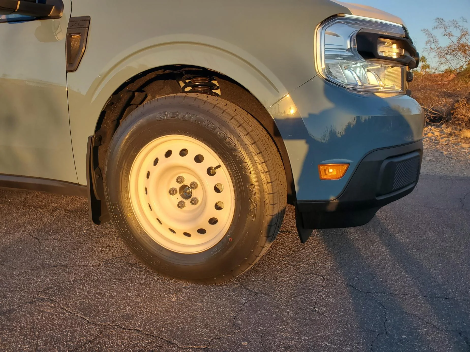

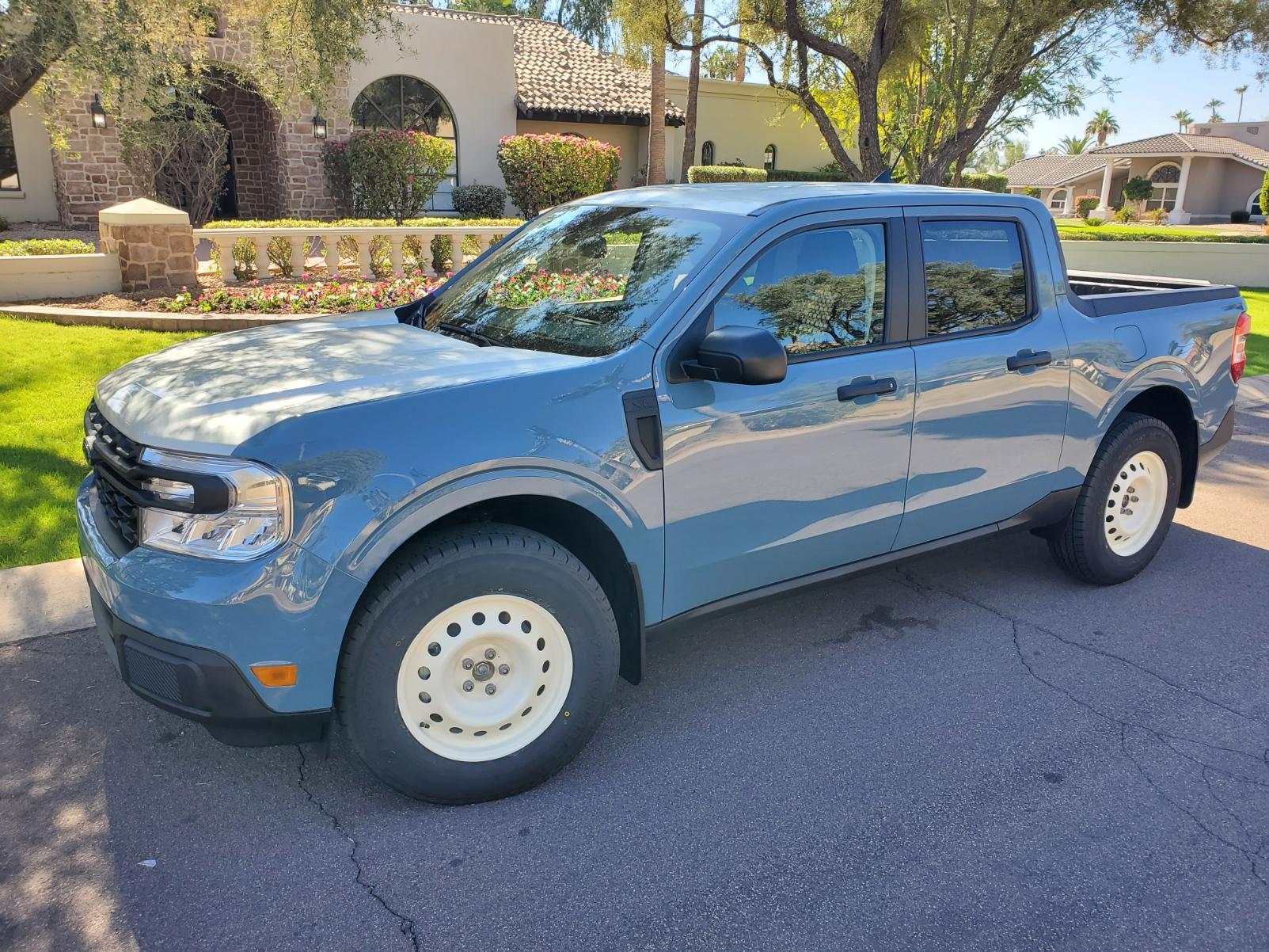

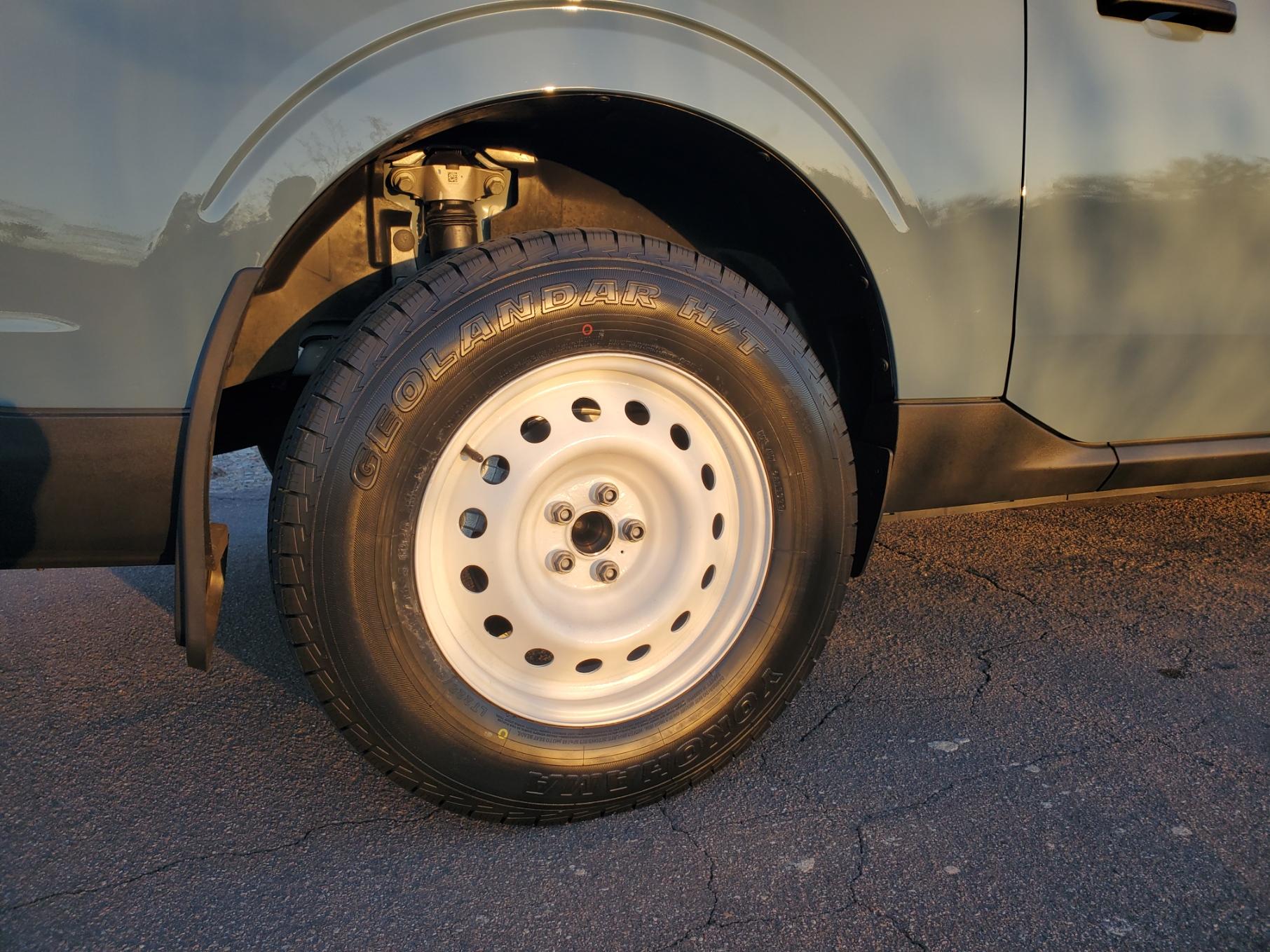

The highest profile I could fit under the stock, no lift 23 hybrid was the Yokohama Geolandar H/T G056 at 225/75 R17.
They clear the aftermarket mud flaps by 8 to 9 mm.
more pics from different angles please?
what was the hit to MPG? (easiest way to tell is to find out how much of a hit you took to miles per tank)

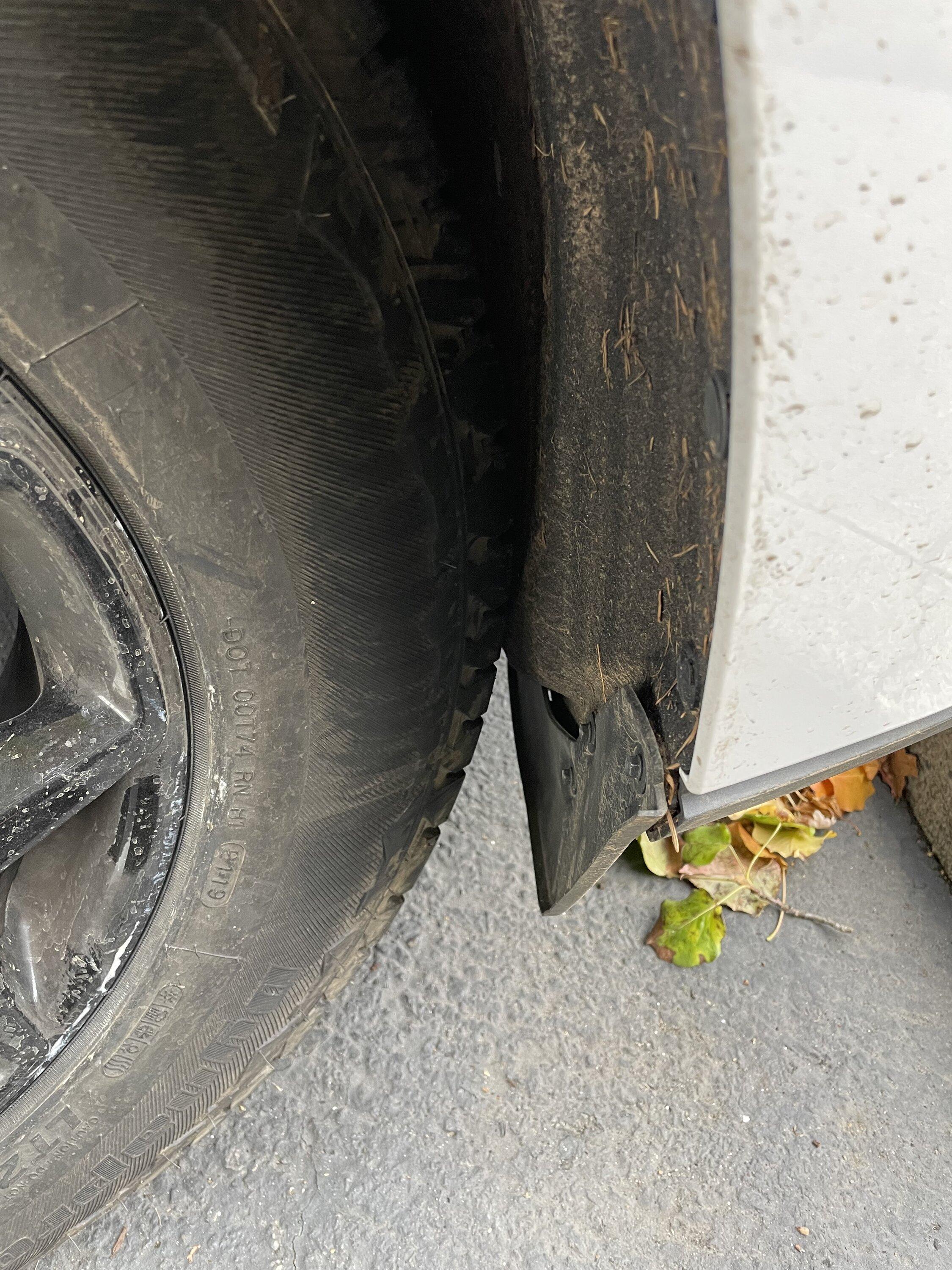

Ford Maverick Skinny and tall - why not? IMG_1083
Ford Maverick Skinny and tall - why not? IMG_1082

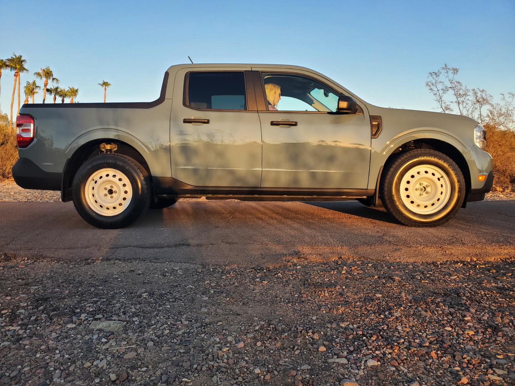

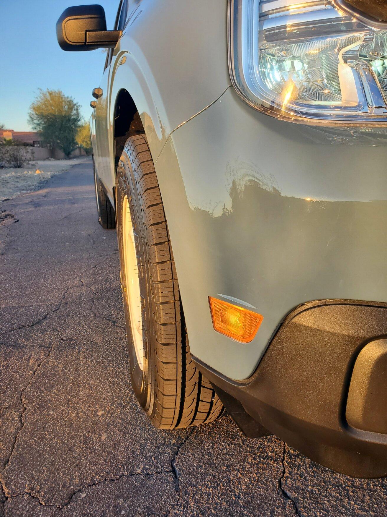

Front
Ford Maverick Skinny and tall - why not? Front
Rear
Ford Maverick Skinny and tall - why not? Rear
Profile
Ford Maverick Skinny and tall - why not? Profile
Full
Ford Maverick Skinny and tall - why not? Full
After I got them home from Discount Tire, I hit them with some inexpensive tire cleaner / shiny stuff from the discount rack at O'Reilly's.
The next day I washed the tires off, then wiped them down with 303.
If you live in the desert and want to maintain some shine to your tires, this combination is a good option. I have to say that these Yokohama tires take a shine even better than Michelins.

Ford Maverick Skinny and tall - why not? IMG_1087
Ford Maverick Skinny and tall - why not? IMG_1086
