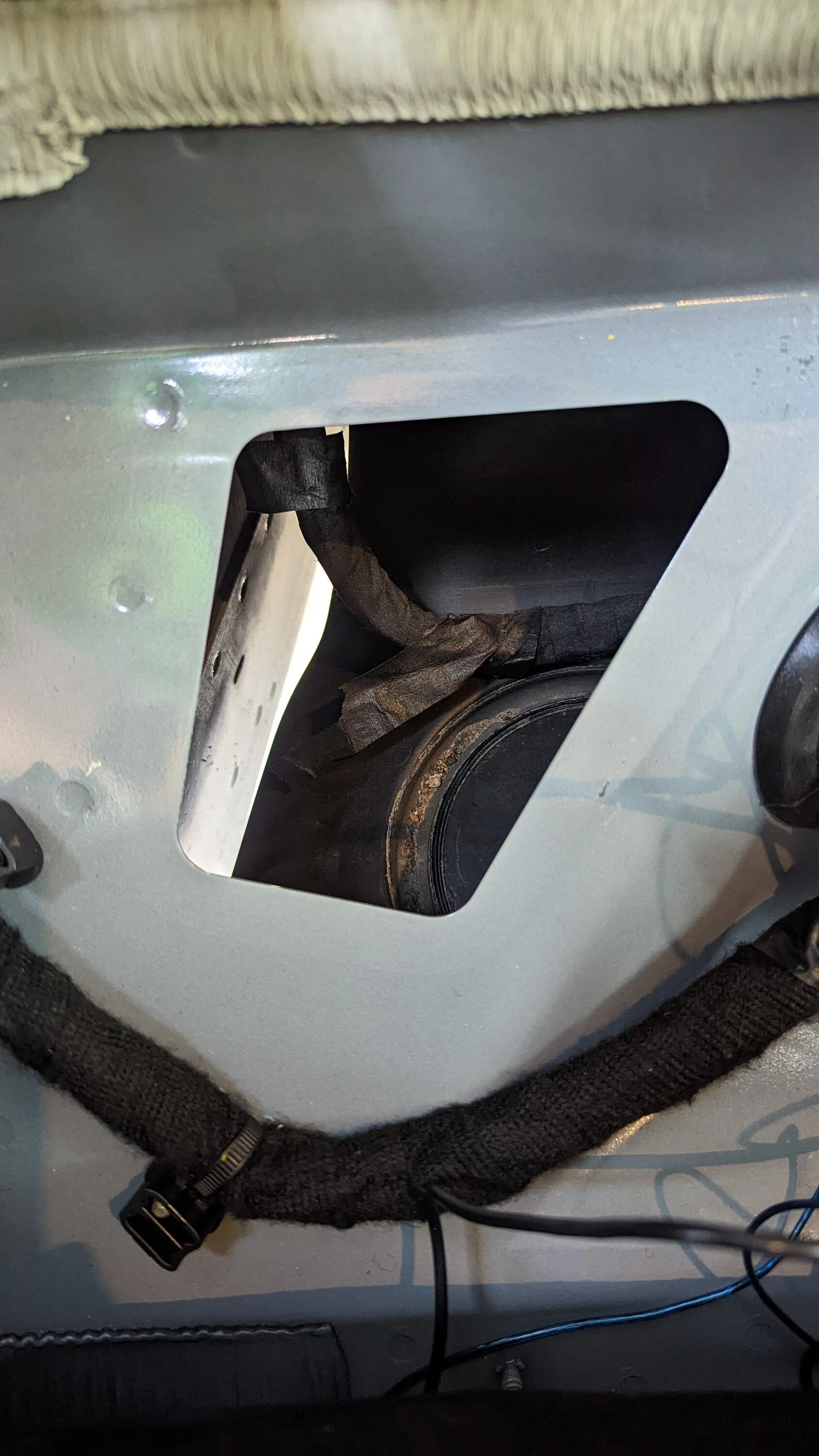

I also made the mistake of covering that "bandpass" hole in the floor and finding out it made the speaker useless. FORD's decision with that whole setup is just odd and nothing I have ever seen before. A literal hole in the floor used for a bandpass box... Mind. Blown.

Free air, not bandpass ;)

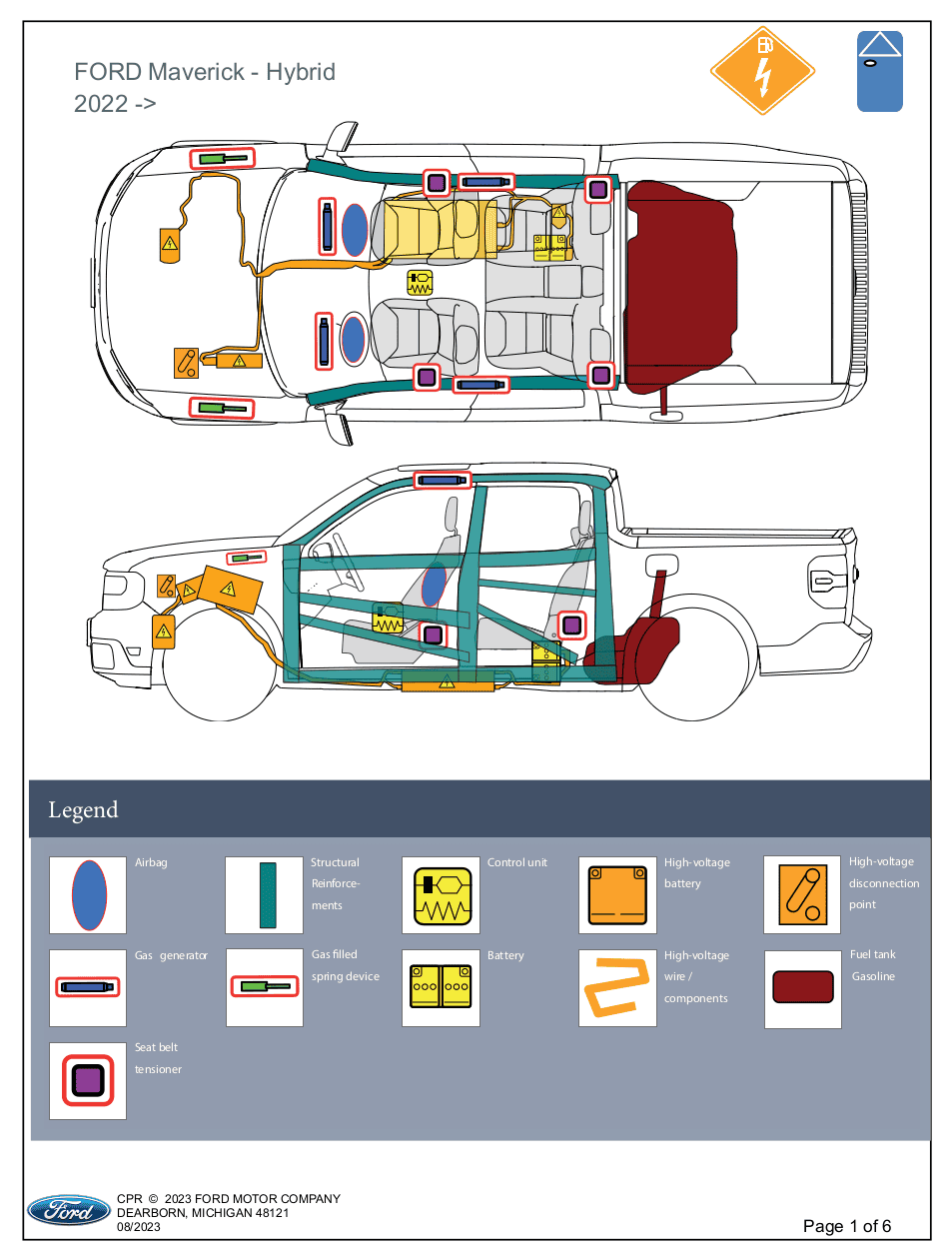

I found this diagram while poking around on the motorcraft website. That port looks like it points towards the gas tank and at least provides enough resistance for some of the moving air to come back into the cabin, though I'm sure it eventually opens up to the outside around the edges?

(snipped) and at least provides enough resistance for some of the moving air to come back into the cabin, though I'm sure it eventually opens up to the outside around the edges?
nah. it's definitely an infinite baffle. you can see daylight and the frame.
Ford Maverick Simple B&O upgrade and sub solution. PXL_20221009_151545959
freeair in literal terms means it has no separation of the front and rear of the speaker cone. the b&o 6x9 does have separation, it just vents out to the atmosphere.
one interesting thing to try would be an aperiodic membrane over that hole. this makes it a leaky sealed enclosure instead of infinite baffle. if you know what that is chances are you're as old as me or older, LOL. I don't know where to find one. I googled and found some on eBay in various sizes, one of them is 80mm x 50mm that is probably not enough. Back in the 90s, you could buy sheets of it.

I made attempts at covering up the hole with sound deadener mat and separately bass blocker foam. In both cases the output of the sub was diminished, I'm assuming because it was restricting the movement of the sub on the back side. Would that aperiodic membrane not restrict it in the same way?
those are impermeable or near it.
an aperiodic membrane lets some air through. how fast it leaks through determines how large of a port you should make in a real design. this is different as the hole is already pre-determined.
let's be clear that covering the hole with that is just an idea of an experiment, not actually a suggestion that I think likely to make a major difference.
