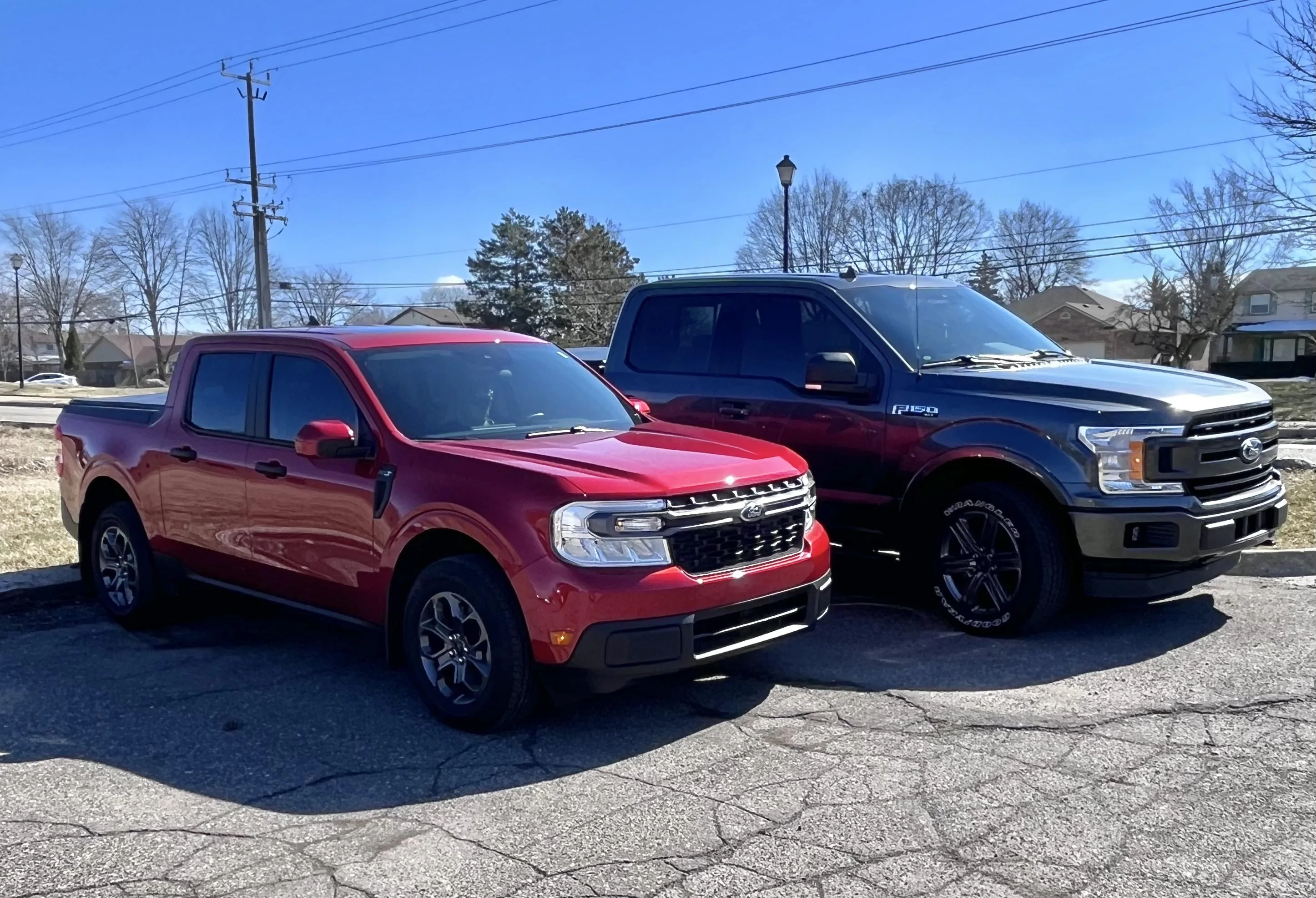

Problem solved. 31 days later. A wire got pinched in the air bag replacement. Took all this time for the Tech and engineers to find it. Service manager was very upfront and honest. He also went out of his to make sure we were happy. It was unfortunate that it happened to us but hopefully they will learn from it and it won’t happen to anyone else. Having been in the auto industry for 26 years, I know these things happen.
After driving a Lincoln Corsair as a rental for the last month. I like driving our Maverick better. Glad this is over
Happy to have our Maverick back!
