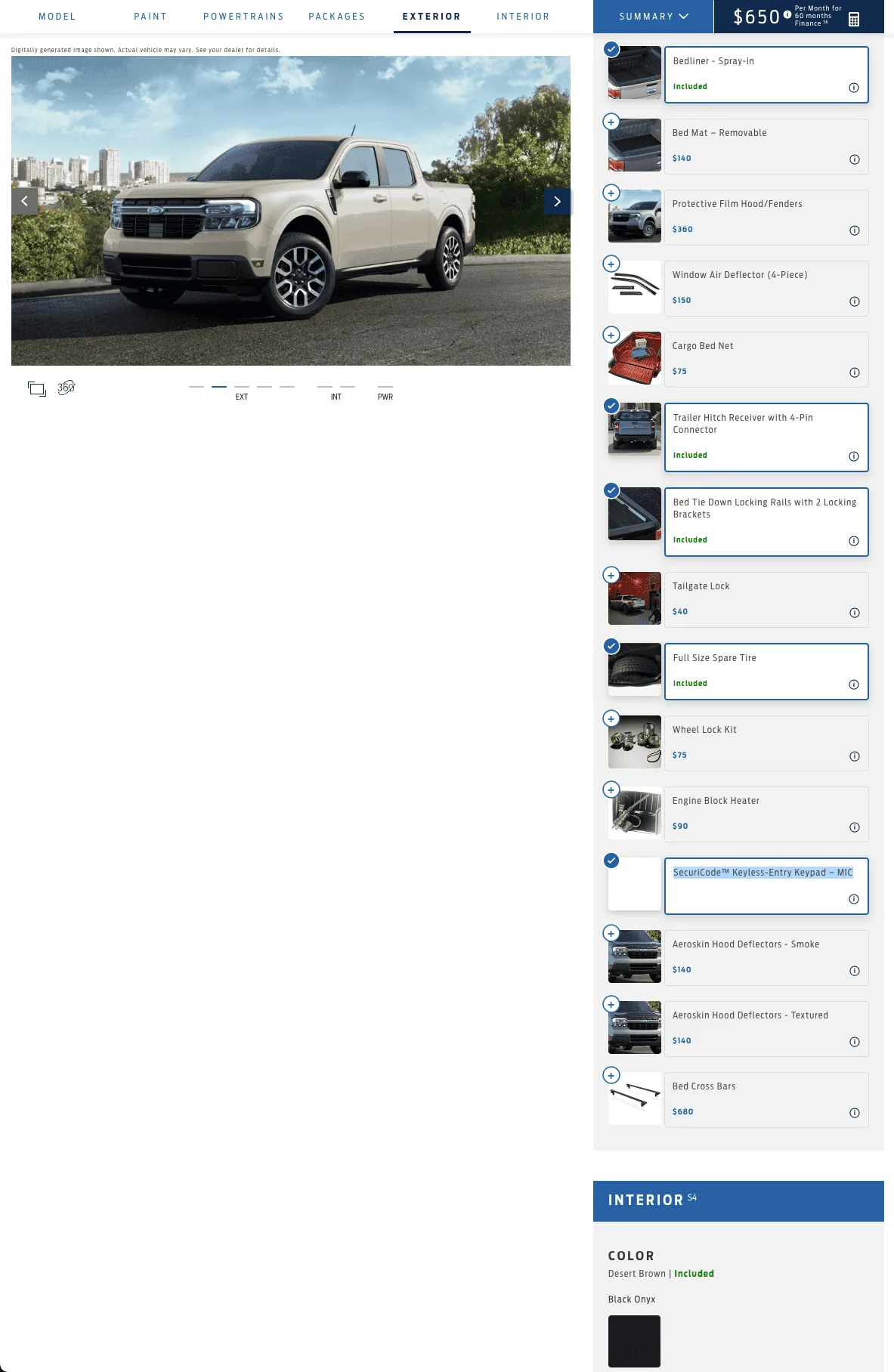

"SecuriCode Keyless-Entry Keypad - MIC" now listed on the 2024 Maverick build pages for all trims under Exterior but no price listed yet.
I can't find it. looked under all trim levels. What is "MIC"?

2023 Ford Maverick AWD Lariat BAP 4K CP360+Assist
Listed between Engine Block Heater and Aeroskin Hood Deflector. I'm not familiar with the "MIC".
Ford Maverick SecuriCode Keyless-Entry Keypad is available again for Maverick Screenshot 2023-07-22 195252
