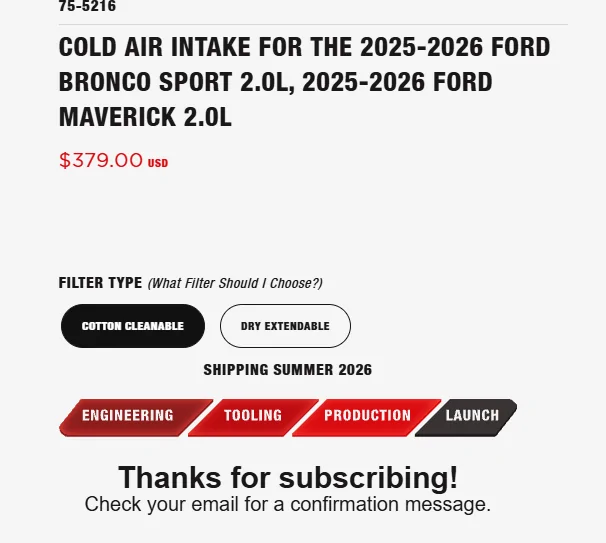

I’m going to install the 25/26 S&B Intake as soon as it is available for purchase ($379). Should be available any day now? I check the website weekly - still shows “launch Summer 2026”.
Some have already been installed & are being test driven pre-launch. I would have volunteered for that…

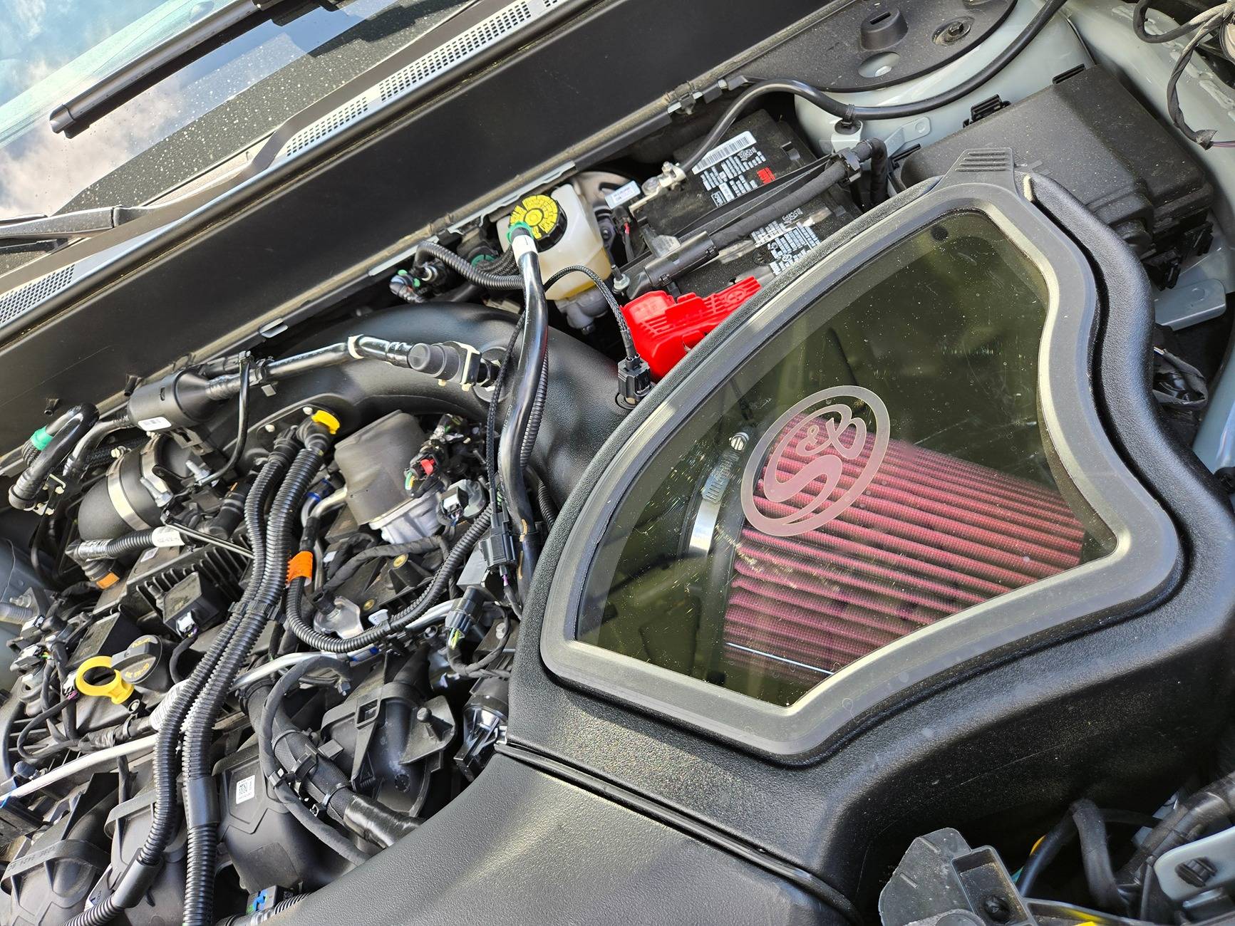

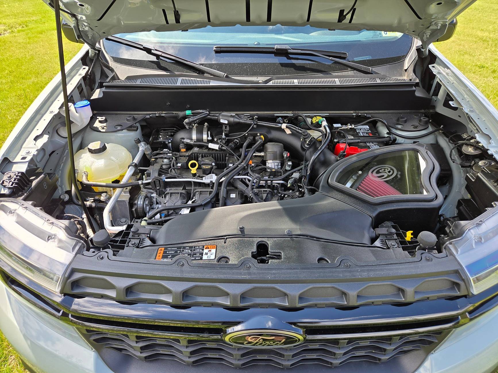

Such a better location for the actual air intake then on the completely opposite side of where the turbo lives -

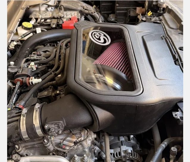

BTW the 2025 intakes are now showing as in production. Should be soon!

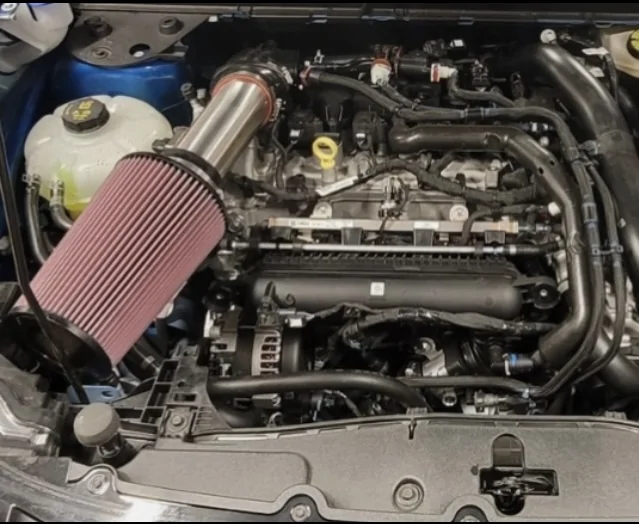

Wouldn't an open cone be the best for flow? The turbo is going to heat up the air to high heaven anyway, so the intake temp doesn't make much a difference. It will make all the noises, which is why ford doesn't do it that way from the start.
I've been through this with the ole 3800 M90. Open cone stuck directly to the throttle body was the best option overall. The intakes got barely measurable improvement in power, but less in MPG. Also, working around the open cone in the engine bay was so much nicer with all the space opened up.

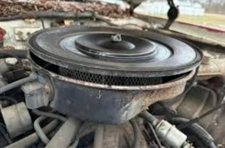

Must be coincidence but when I was a powertrain engineer we used dynamometers to check this kind of thing too. Then we used statistics to figure out if small changes were real. We'd usually do a test of reasonableness first to screen out testing stuff like Pixie Dust.
You were using the wrong measurement tool. Should have used sound level meter, also commonly referred to as a decibel meter, sound pressure level (SPL) meter, or noise meter.
