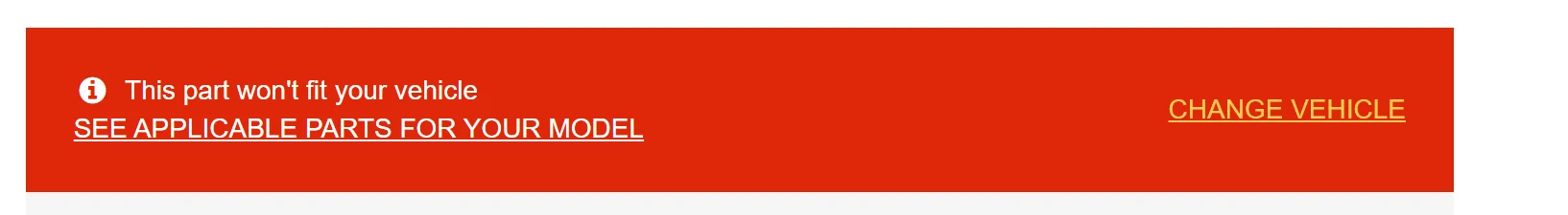

I don't know...to my eye, the black "rail" on the top of the flex in the photo looks a lot narrower than the black rail on the roof of the maverick. I'd measure the rail (depth and width) on a flex in person before ordering those rails for a Mav.
Update...I ordered this clamp on roof rack and one j-bar (1 reviewer said it only fit square and not round cross bars and the rack comes with angular cross bars so hope it will fit) and it was from Amazon for a total of about $96 shipped. I'll update the fit on the Mav and kayak after receiving/installing them. They look just as generic as the brand of the rack "Generico"...no joke. Only had 1 review which was 1 star due to lack of directions which came with the rack.

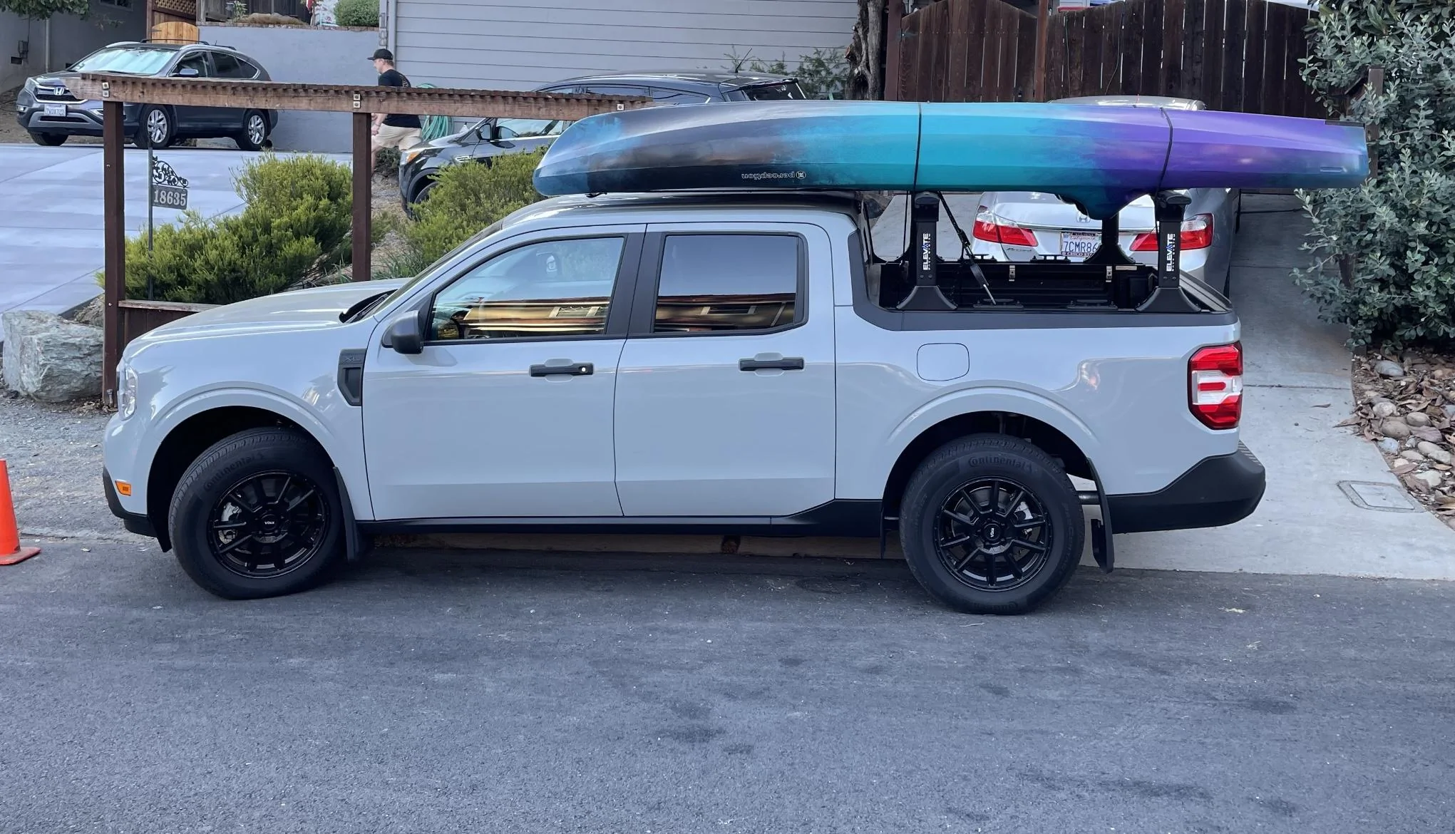

As best I can tell, the "landing pad" option is the only real solution. It involves dismantling and reassembly of the liner. Not for the novice mind you. My ultimate decision was the truck bed removable "Elevate" rack system. The matte powder coat finish matched up well with the Maverick matte black trim. https://truxedo.com/product-detail/1118513 (remember the rails)

Rivet mounting pads to the non-removable strips??
So this setup cost how much? Can you still ad a tri fold hard cover?
