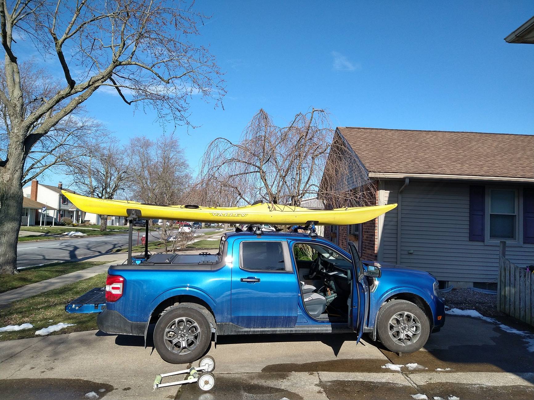

I use elevate rails then added one rear cross bar IO made myself from Tnutz. Yakima cross bars on roof of cab. So I have three cross bars. The main reason is I also use a Hullavator which attaches to the from cab cross bars,. BUT I only use the Hullavator once in a while for a shorter boat I have . Other wise I load from the rear.
Plus when I first got my 23 Mav I only had the cab cross bars as I had them from past vehicle.

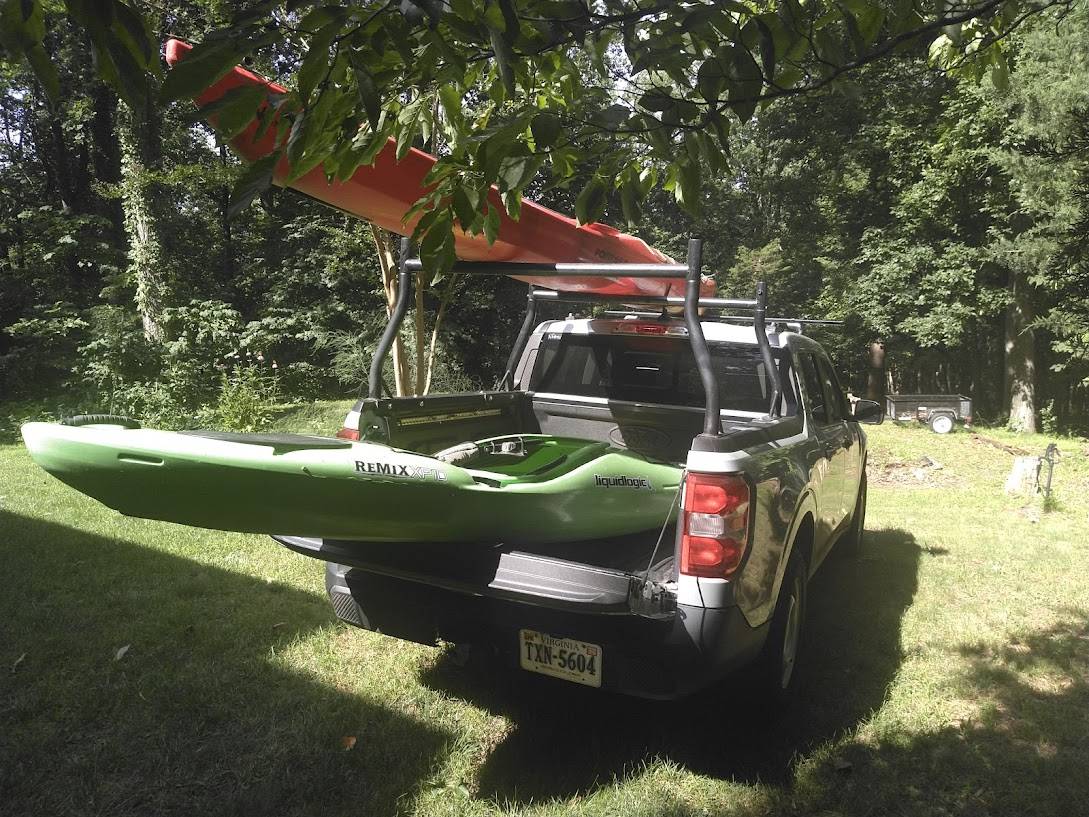

Dan's setup is what I would recommend for long boats. I have mostly the same set up. The bed rack is steel off ebay and cut to match the height of the removable yakima crossbars on the cab. I put j-bars on the roof rack for whitewater boats. When I am not hauling boats the 4 crossbars act as a serviceable lumber rack for hauling long stock.
The whole thing is removable. The crossbars use yakima landing pads and the the bed rack uses threaded rivnuts. I have been using the setup for 3 years now and folks have been impressed how easily I can transport things. The last one was a 20 foot section of 6 inch plastic pipe.
