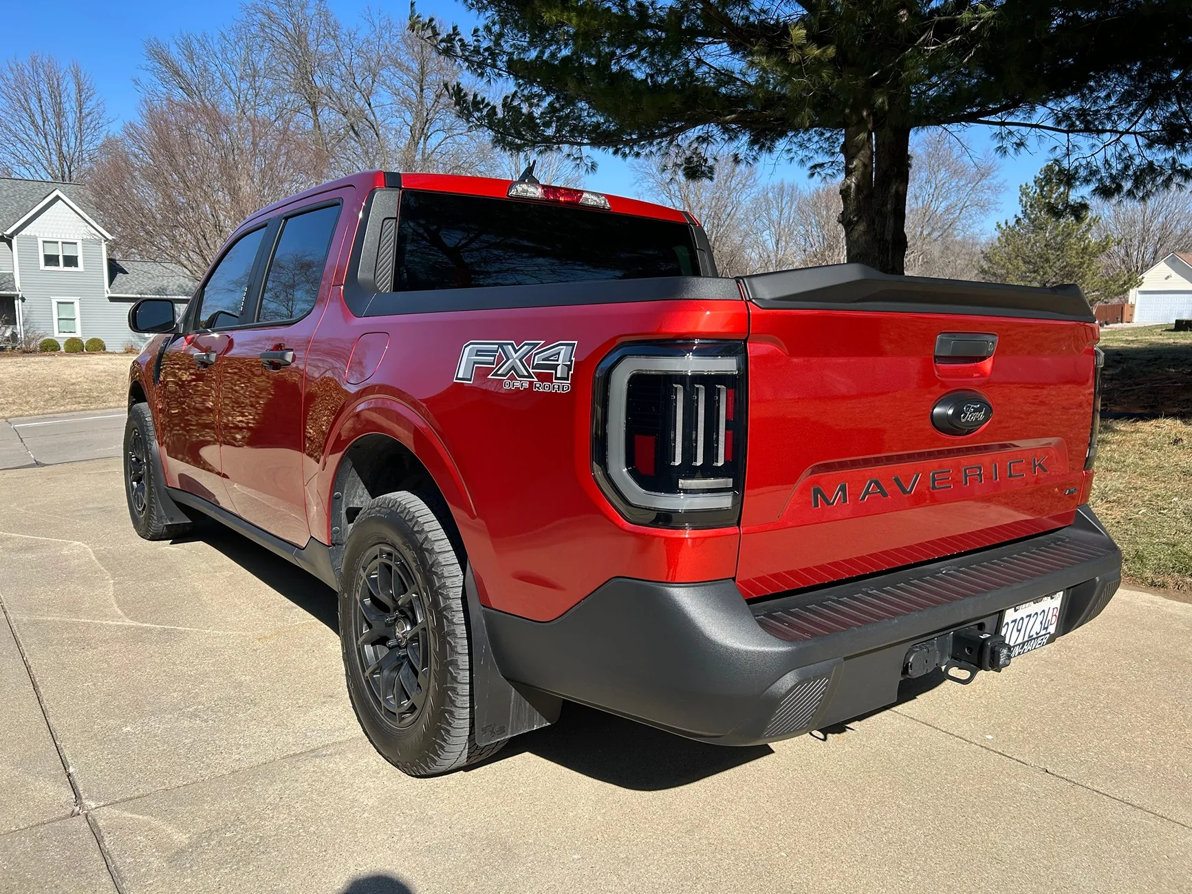

Get the Form lights :cool: You can use my ambassador code MaverickDad for free shipping too
Ford Maverick RIP Lasfit tail lights Photo Feb 13 2026, 1 25 54 PM

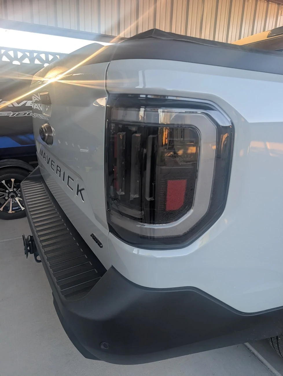

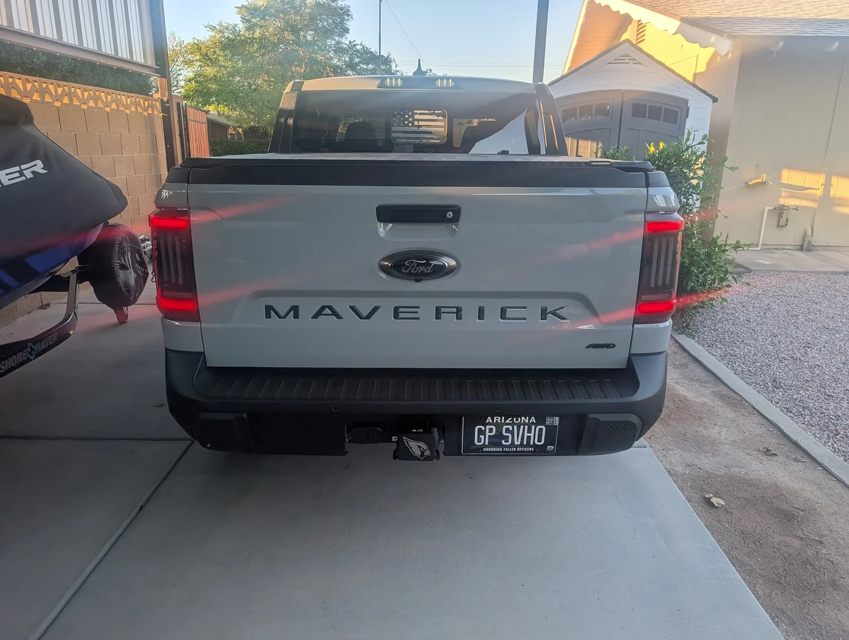

Well the time has come. Bought July 2023 and installed right away. Been pushing my luck since then but recently 3 out of the 4 red tail lights are dead, and I think the white back ups might be dead too. I planned ahead and got the replacements but when I swapped them looks like they are already dead. The diode dynamics aren't cheap, like $50/pair. Any one just give up and get the Form lights?
Yep, They're nice
