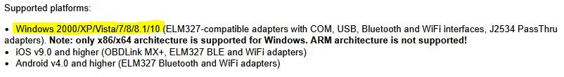

I'm not one of those with a laptop or PC. The last laptop I had, before it was shredded was running Windows Vista. 🤣
Too bad you shredded it. FORSCAN is simple software with very good platform support.
From the FORSCAN website:
