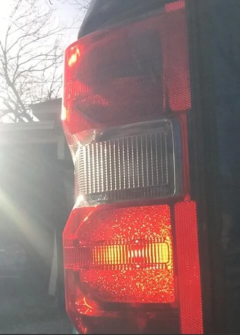

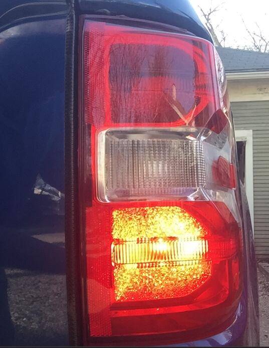

Well, a 2nd set of @LASFIT Taillights have failed. Not sure if they need all four taillights to be LED or not but the brake and blinker portions have failed a 2nd time.
Both times they have lasted about 6 months. Now I do have to say that Lasfit's customer service is excellent, just the product on taillights, not so much. I have also installed Lasfit back up lights and they seam to be working well.
