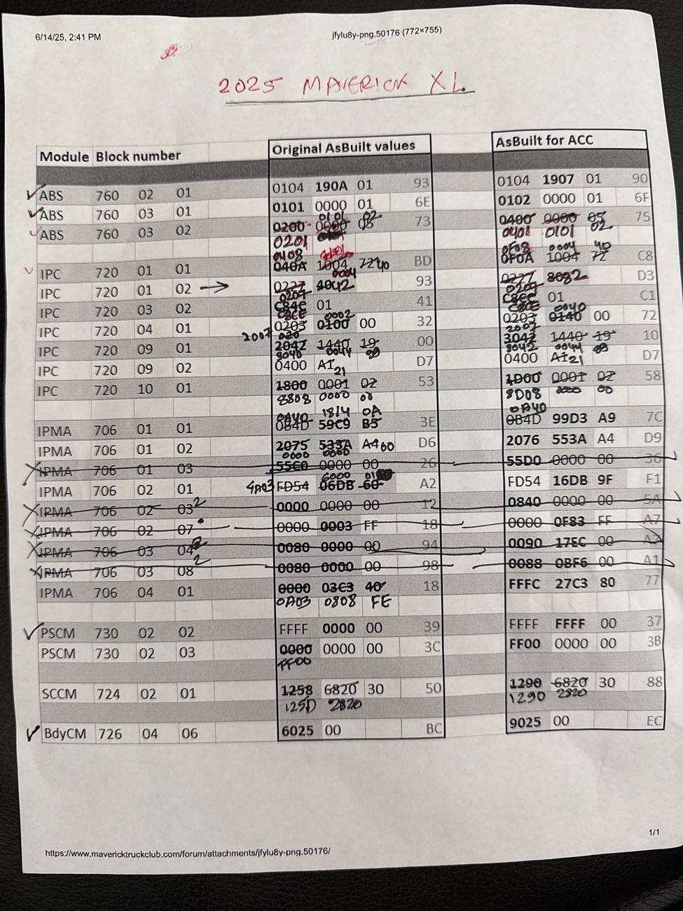

Alot IPMA blocks are not available for me to update. Any block with number 3 and on are not in the car( crossed out in my markups). I didnot want to update half. I took the notes on old sheet what I found different. Anyone with 2025 maverick CCM could share some of these numbers from their modules? If you know that one which bring in CCM to show in module let me know. I can randomly try some but again worried that will brick my car.

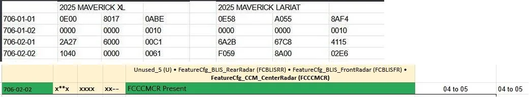

Does your IPMA have 706-02-02 ?
That's where F150 IPMAs enabled CCM.

You need to compare lariat hybrids with adaptive cruise and lane centering installed to yours and then go line by line to determine what the change is.
There is a nice program that lets you compare module by module here:
https://www.compulsivecode.com/Project_AsBuiltCompare.aspx
The 22-24 seem to be completely different in terms of how they are set up.

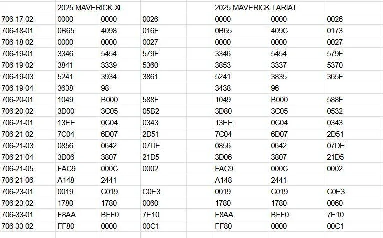

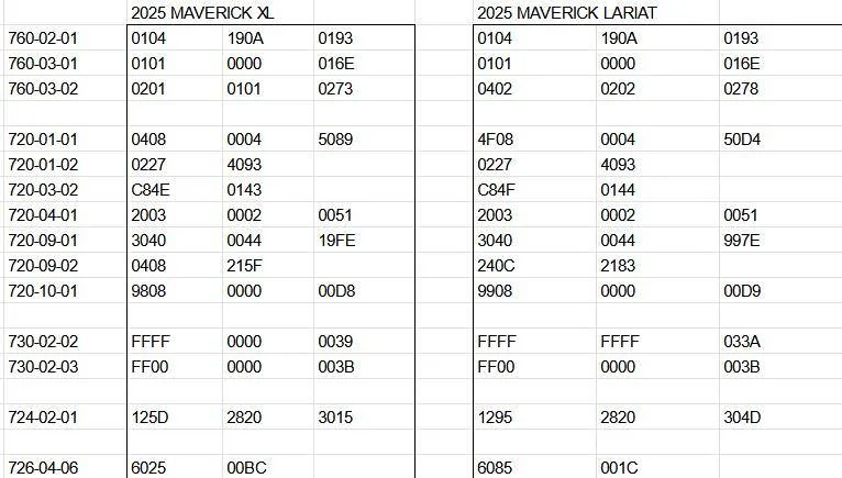

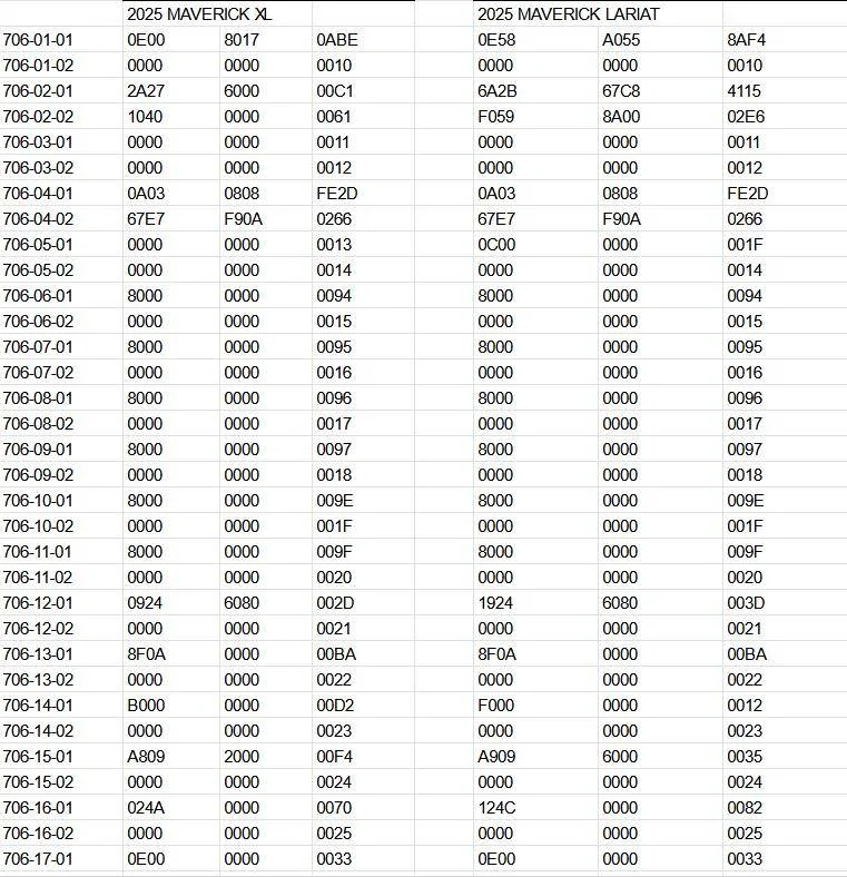

Thanks, got some info and made a sheet to compare with my VIN and a Lariat for sale nearby.
I see differences between my truck and the notes @HaveMave took as well, probably due to differing options between our XLs
The IPMA is so different from the 2024, I decided to included them all, just gotta figure out whats what.
My scan tool will be in tomorrow and I can compare the as built with whats on the truck too.
Edit: tagged the wrong person sorry!

This compare: 02-02 XL to Lariat appears to go x04x to x05x as the F150's do.

Surprisingly my backed up Asbuilt before I do anything and I downloaded from motorcraft service is different. I did not see any difference it made but some code gets updated. I assume same for Lariat.

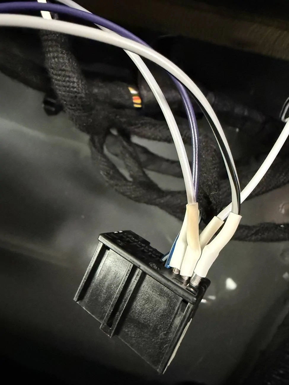

I scanned as a new profile but I didn’t change anything in IPMA yet, if that’s the case I will try again when it is a little cooler outside.

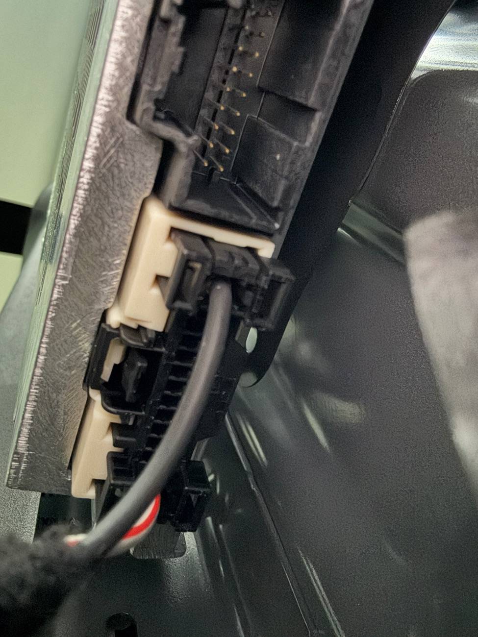

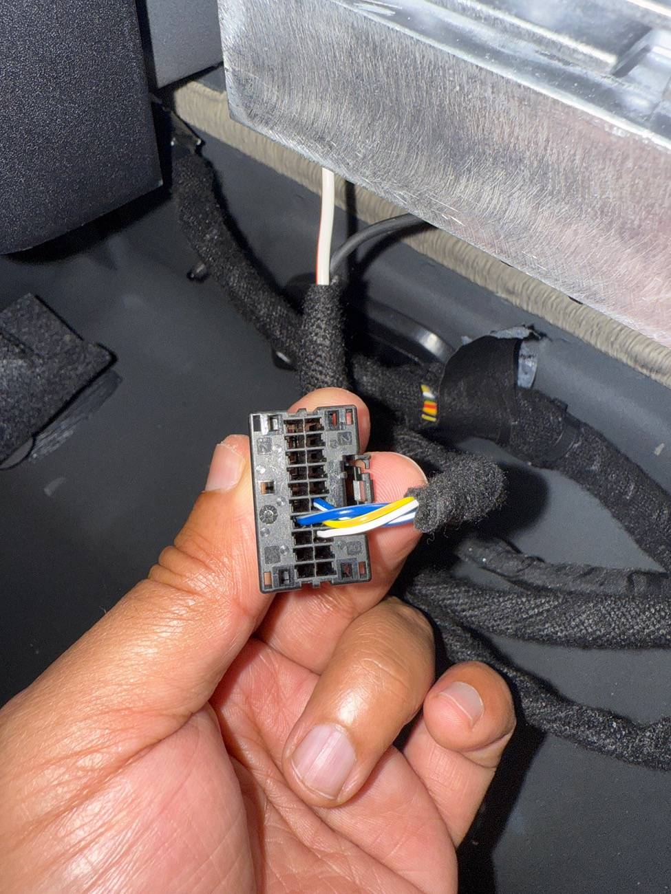

Adding pin was hard part. There was no pin in 9, 18, 19 and 20. I added and checked with multimeter for continuity.
where did you find the extra pins for this plug? I want to take a crack at this and see if I can get the CCM recognized.

I had pins available for another make shift pigtail. I put those in the IPMA pigtail at 9 18 19 20. CCM never got recognized. I think either those pin number were not correct or my CCM had gone bad. I had connected everything temporarily so after that I reverted connection to the factory config. I still have camera calibration DTC. It didn’t go away even I drove a while. I do not see calibration service in forscan. If any of you know how to calibrate camera in Forscan please let me know.
