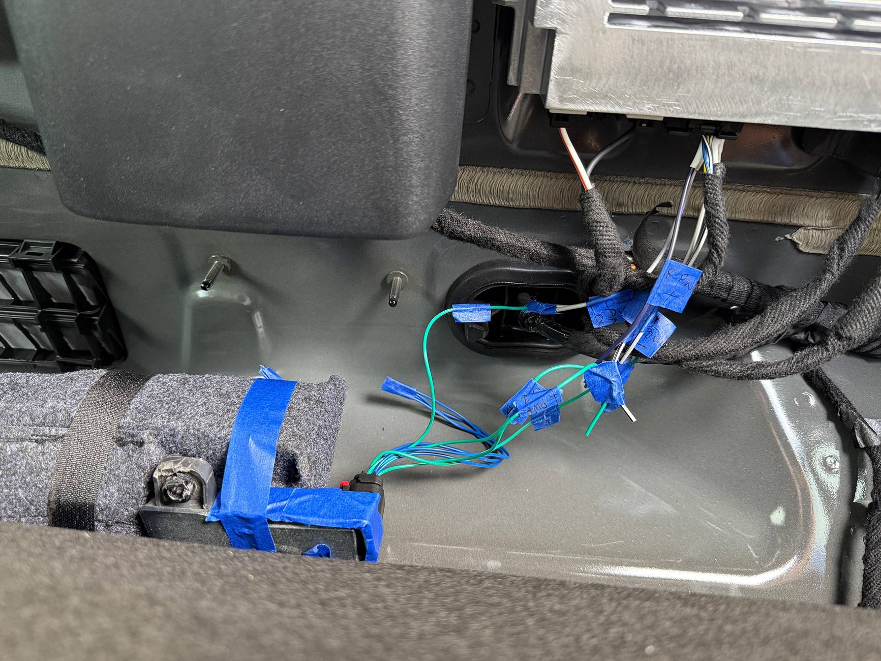

Ford Maverick Retrofit Adaptive Cruise 2025 XLT IMG_1434
I I connected my old module but CCM is not detected. Could it be Forscan version (2.3.66)? If compatibility, I would’ve at least see DTC? I have saved a firmware for CCM which is proven worked with Maverick from fcolo but here I didn’t even get chance to update it. Do you guys think, I need to take battery power off to reset computer?

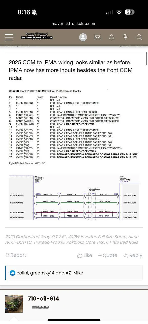

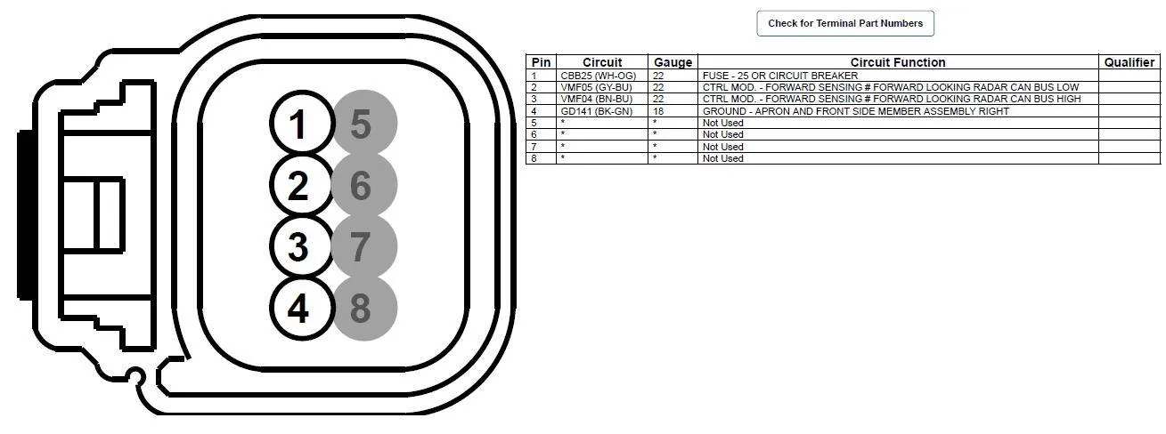

Make sure you start with a new profile and don't use the saved profile in FORSCAN. So click no when it starts loading. Also, I think you need to change the settings in the IPMA first to enable adaptive cruise control in order for it to even look for the CCm.
Question, were the wires for the CCm (power, ground, data+ and -) already pinned with wires coming out of the IPMA?

I scanned as a new profile but I didn’t change anything in IPMA yet, if that’s the case I will try again when it is a little cooler outside.
Adding pin was hard part. There was no pin in 9, 18, 19 and 20. I added and checked with multimeter for continuity.
