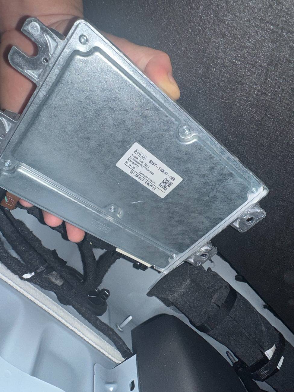

Chrysler master tech here, I bought a 2025 XL with copilot 360. Looking at retrofitting the adaptive cruise to mine as well and happen to have a 2025 lariat at my disposal, neighbors… I looked at theirs and seen the CCM is a different part number than the one you have listed and won’t fit the 22-24 mavericks. It’s more like the f150/explorer one. I have part numbers and wonder if this is the issue why it won’t recognize the CCM. S1PT-9G768-AA

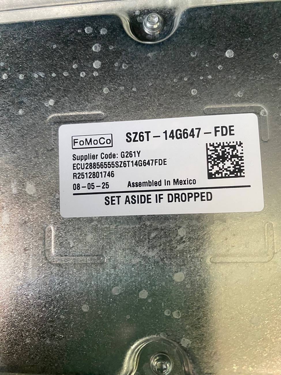

Regardless, Jesse-Infotainment at the f150 lightning forum told me that unless your IPMA module is revision xxxx-xxxxx-C the CCM likely won't work. My XL has blind spot monitors and is revision B, some lower trim mavs have revision A. I can't find a B or C on Fords part site, but it's printed on the module itself. SZ6Z-14G647-A
The specific revision of your ABS and BCM could be a conflict as well.
If your neighbor will let you, the IPMA is driver side behind the rear seat. You'll have to take the nuts off to see the sticker on the back, get the part number off that module for us!
Another thing you could do, friendly lariat owner permitting, borrow his CCM, buy a connector and 4x pins(price is for 1 piece) for the IPMA,and wire it up behind the seat. In the IPMA enable the CCM and see if it shows up on forscan.

I also have the IPMA, CCM, IPC, SCM, and gateway as built data saved from forscan. If any of that is helpful from the lariat truck

FDE?? lol mine says BBB. If you want to share IPMA as built, I'd like to compare it to the one I was able to get online with a lariat VIN.
Also, check the last edit of my last post, you responded so fast I might have still been typing it. If you can do that, it might confirm whether we need new IPMA modules. I could also ship you the plug and pins I bought if you don't want to waste funds yet, since I was unsuccessful so far they are just collecting dust over here. You have a good opportunity to do some research for this project having a lariat nearby so just thought I'd ask.
