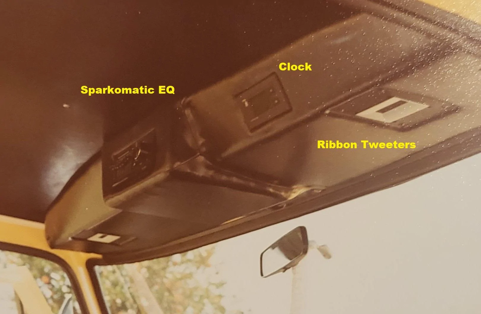

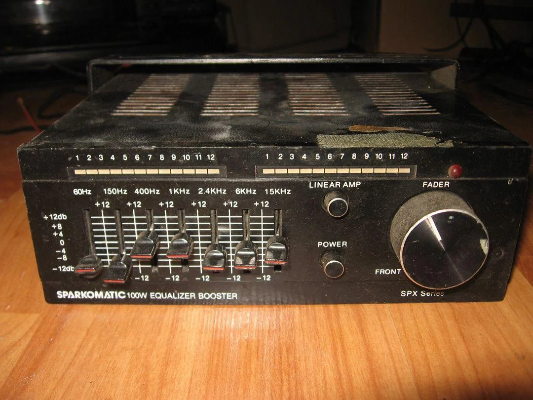

The "SPARK-O-Matic" and Jensen 6x9 triax were my "Go To" set up for just about everything back in the 80's. The colored EQ lights were a huge deal back in the day. I mounted that in an overhead console that was way ahead of it's time.
Very cool! You should have patented that! I still have a working 8 track in my 72 cuda,and also my Craig power play 8 track. And I have a brand new set of 6x9 Jenson speakers still in the box for the 80,s.
Very cool! You should have patented that! I still have a working 8-track in my 72 cuda, and still have my Craig power play 8-track. I also have a set of never used Jensen 6x9 speakers still in the box from the mid 80s
