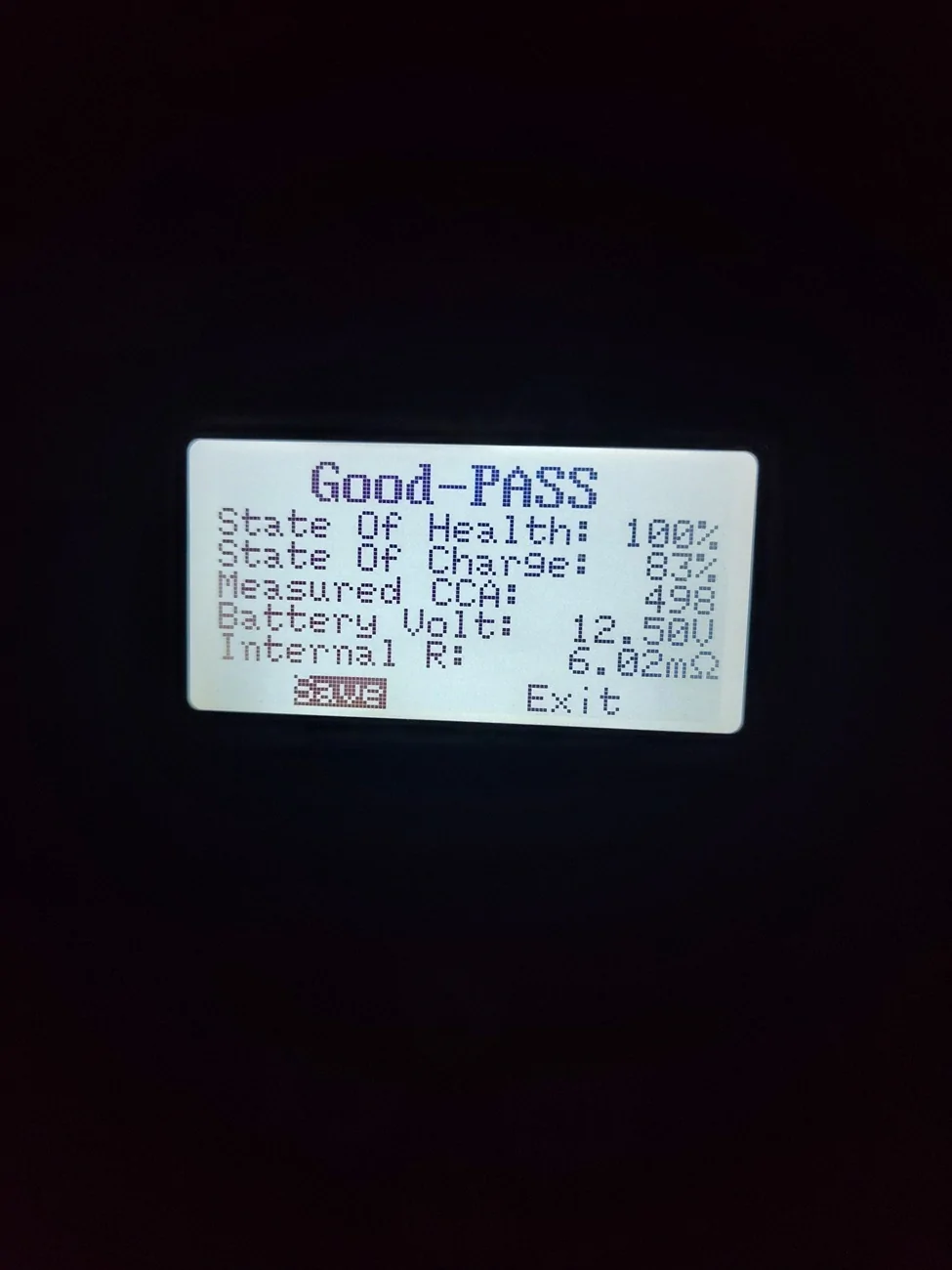

FWIW, here's the test results. This is an OEM FLA (replaced under warranty) that's just over a year old. We'll see what happens. I did order a battery tester from Amazon so I can at least have a little more information when it starts misbehaving again.

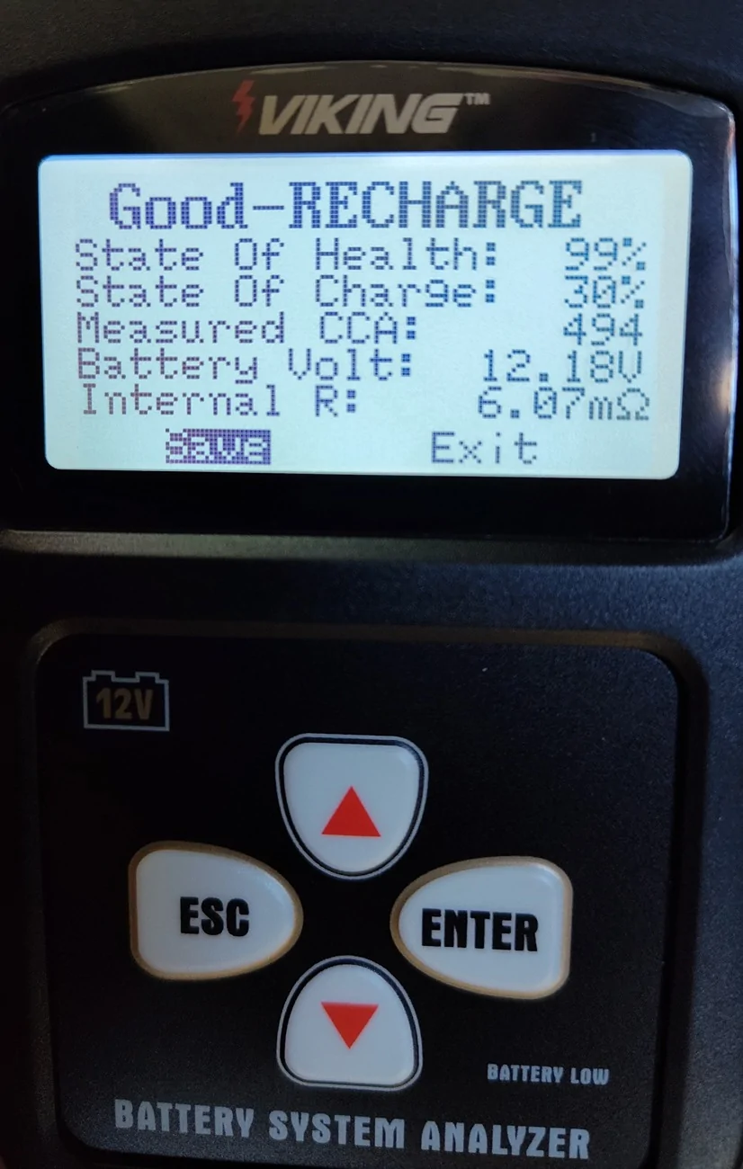

My simple battery tester found the same thing on OEM small battery, and warranty bigger battery.
The stated Ah / CCA was easily surpassed in the test. So they do overbuild by a bit.
I wondered how bad would it be if they actually matched the specs!
So SOH% was fine, except for...
The internal resistance and ability to hold a full charge was very bad.
But from their point of view - unless it hit their Ford SOC of 39%, or went under those battery limits decently enough - not a bad battery.
Here's mine from 1/26 - 5 months old, 2 full recharges 3 months in, with drive to NY over 2 days up, 2 days back.
Compared to next picture of 6 yr old Rav4 battery, driven little since 4/24. And pre-Noco extended charging/repairing cycle. I thought interesting that the resistance in truck battery is already so bad.
