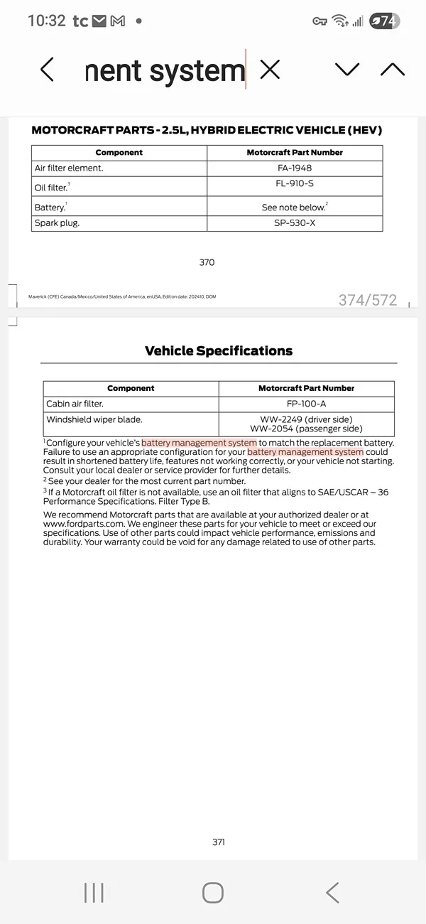

Question: this portion of the manual says "if equiped" with the BMS. Which Mavericks have BMS, and which don't? I have 2023 Hybrid XLT.
I don't have the reference immediately at hand, but from what I remember most or all Fords since (2011?) have had a BMS system with upgrades to it since then.
So, I believe all our Mavericks have a BMS.
I will go look for a reference and will include it here when I find it.

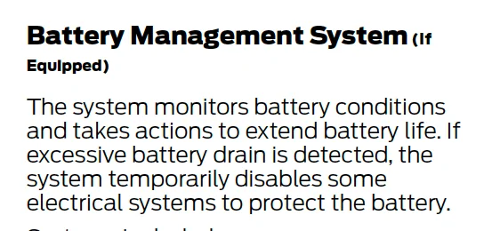

Okay, I only have my 2025 Maverick Manual, not your year but I would imagine they are pretty close in page references.
Take a look at the my page below, and it directly gives direction as to BMS management, this shows me mine has a BMS.
In your manual as you have a hybrid as well, it should say the same thing, though the page number may differ.
The Eco-Boost directive is just above the Hybrid information....for anyone wondering about their truck as well.
I hope this helps,
Andy
I hope this helps,
Andy
That wording in the manual started with the 25MY hybrid, and has always been there for the EB's.
There is no such indication of battery info entered for the pre-25MY hybrid, in the manual. In fact the BCM PID's show no info entered, empty choices.
They all have the BMS, unless there were some very early builds that left it out - betting the BCM got the upgrade to include it though, and that was probably the EB's.
