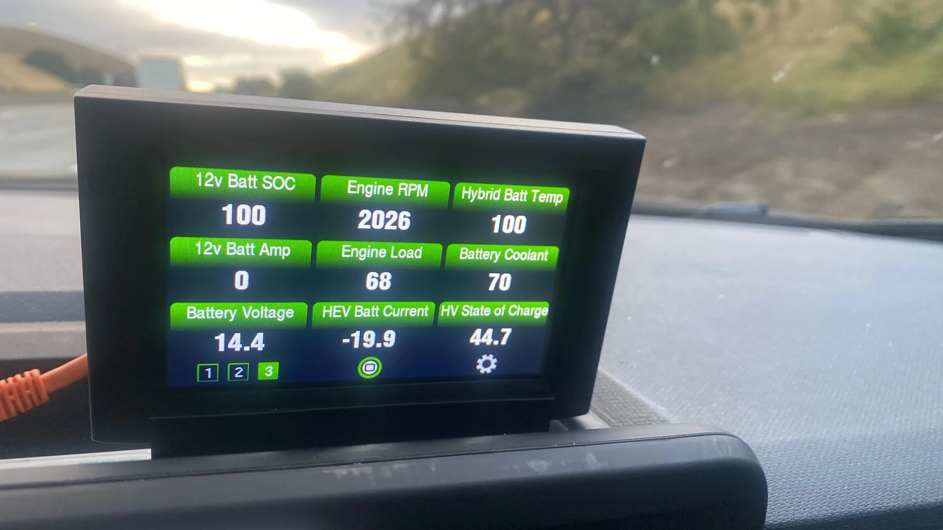

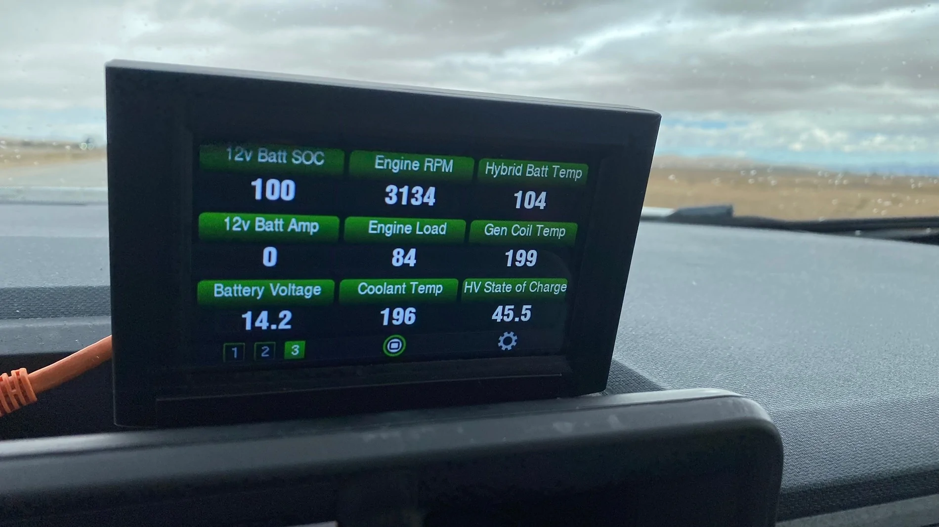

Ladies and gents (mostly gents I suspect) I do believe I have solved the HYBRID 12v battery mystery.
I will start a new thread soon because this fix is simple, and APPEARS to work!
Yes it is a faulty BMS.
I have found a work around to manually control the BMS.
Teaser: my 2022 HYBRID 12v battery has maintained 100% charge for a week straight. And charging occurs at 98% and it tops off to 100% before stopping active charging. Float/Maintain voltage now stays at 14.2 indefinitely.
Teaser:

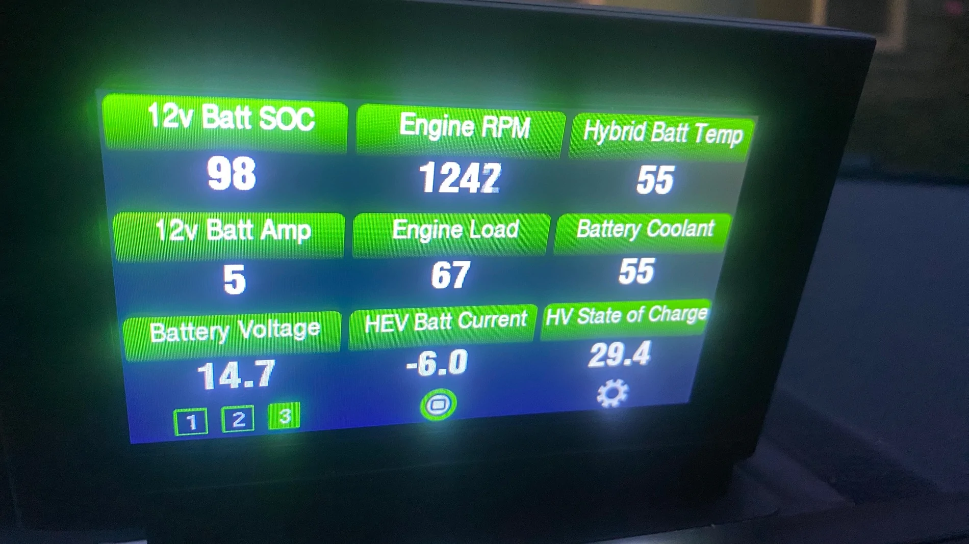

Ford Maverick Replacing the Hybrid's OEM 12v. Battery IMG_7813
98% with 5 amps charging.
98% after a cold start after sitting parked overnight 13 hours.
Ford Maverick Replacing the Hybrid's OEM 12v. Battery IMG_7816
100% 0 amps - neither charging nor discharging
Ford Maverick Replacing the Hybrid's OEM 12v. Battery IMG_8030
Different day, 100% neither charging nor discharging. Maintaining 14.2 v.

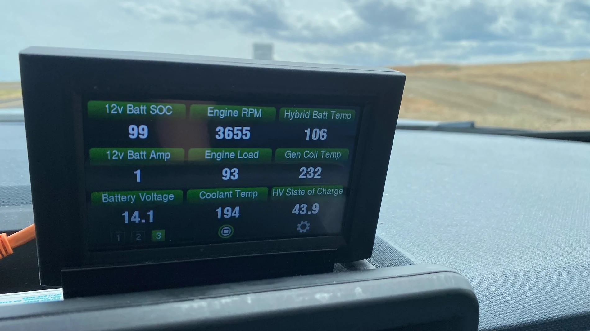

Ford Maverick Replacing the Hybrid's OEM 12v. Battery IMG_7836
99% and 1 amp charging.
This fix is so simple (and yet dumb) I have a hard time believing it. But 7 days in a row of consistent results.
