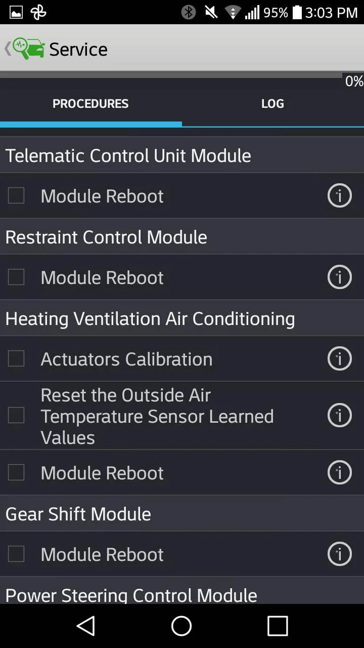

Did you notice in the notice to disconnect negative cable for 5 minutes. I bet that though a temporary solution resets some modules to reduce that draw
HeyBales
May 3, 2024
4,944
4,536
KC Metro area
It is a complete power cycle.
Which all know is useful for computers.
Can't hurt!
Probably confirms that reboot on whatever module was causing the drain.
So they don't recharge battery hooked up, and it just happens again.
Shoot, even Forscan Lite has procedures for doing that to individual modules.
For instance.
Ford Maverick Remote Features Disabled To Preserve Battery Life. Screenshot_2024-12-13-15-03-33
