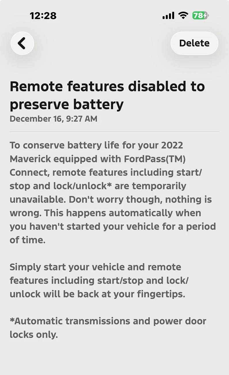

This is a new message I never received before "Remote features disabled to preserve battery". I have been on vacation for the last 2 weeks (drive your vehicle to access remote commands and useful features). I do have an 1 amp NOCO charger on my AGM battery (about 6 months old). When I look at the Ford app it tells me in bold letters Battery saver mode. I would have thought my 1 amp charger would prevent this type of message?
I'm not terribly worried about it, more or less curious./

It will automatically do this after 14 days of inactivity.

2 factors that the driver can check. The other is Ford's SOC scale to 40% or below.
https://www.ford.com/support/how-to...y-does-my-ford-vehicle-enter-deep-sleep-mode/
Deep Sleep mode is designed to conserve your vehicle's battery power. This setting is activated when your vehicle falls under the following conditions:
  • Vehicle inactivity for 14 consecutive days
  • The battery voltage drops below 9.5 volts
  • Extremely cold/hot weather conditions
My Maverick was sitting for 14 days when I received this message! I just didn't think I would get a battery message when I had a 1 amp trickle charger on it. It still started today which is good
bighap
Aug 27, 2021
765
1,358
Oregon
2023 Maverick Lariat Hybrid
Right. It wasn't the battery in this case. Just the set 14 interval.
