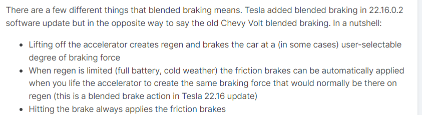

Looks like Tesla has only recently added an option for blended braking like within the last year or so. But it also sounds like that's only for the computer to automatically apply friction brakes in situations where the regen is inhibited such as a full or cold battery? Hitting the brake pedal is still all brake pads.
I suppose when I hit my brakes (and can see the regen green bar), it seems like my brake pedal is enabling a stronger regen when in reality, I'm simply adding friction braking to the regen that the car is already engaging making it seem like my brake pedal is doing regen.
Either way, it's seamless to the driver and very well executed.
