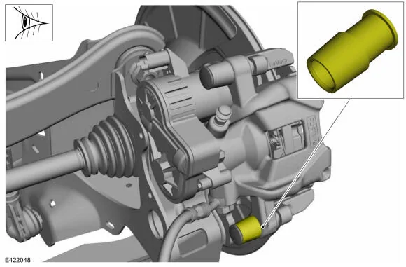

  5. NOTE: Reinforced bush shown below.
    Visually check the type of bush mounted on the brake caliper.

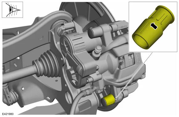

  6. NOTE: Standard bush shown below.

  2. NOTE: This step is only necessary when standard bushing located on the opposite side of the bleeder.
    Clean the brake caliper bush housing.
    Material: Brake Cleaner
    Ford Maverick Rear Rotors and Pads {filename}
    Courtesy of FORD MOTOR COMPANY
  3. NOTE: This step is only necessary when standard bushing located on the opposite side of the bleeder.
    NOTE: Make sure that the component is clean, free of foreign material.
    Apply the grease on new bush.
    Material: Grease - Silicone (ESA-M1C200-A) (ESE-M1C171-A)
  4. NOTE: This step is only necessary when standard bushing located on the opposite side of the bleeder.
    Apply the grease on brake caliper bush housing.

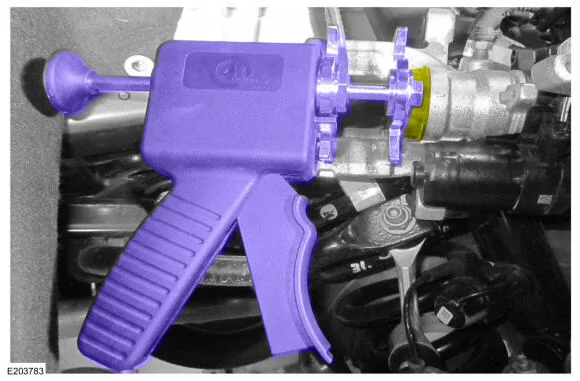

  5. NOTE: This step is only necessary when standard bushing located on the opposite side of the bleeder.
    Using an appropriate diameter socket to push the new bushing into the caliper bushing housing.
