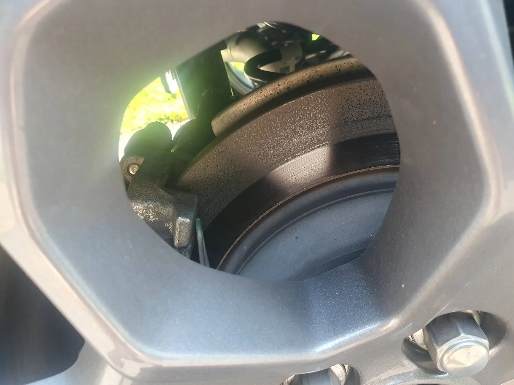

Rear rotors. Dealer has free yearly safety inspections. They don't say shit about it now. If they tell me I need new rotors to pass State Insp., I'll remind them that the NRA Headquarters is only a mile away and I have anger mgmt issues. You wanna rip us off? Stare down a barrel. I'll bet they don't even mention it...
That's not great that only a small percent of your pads are touching the rotors.
