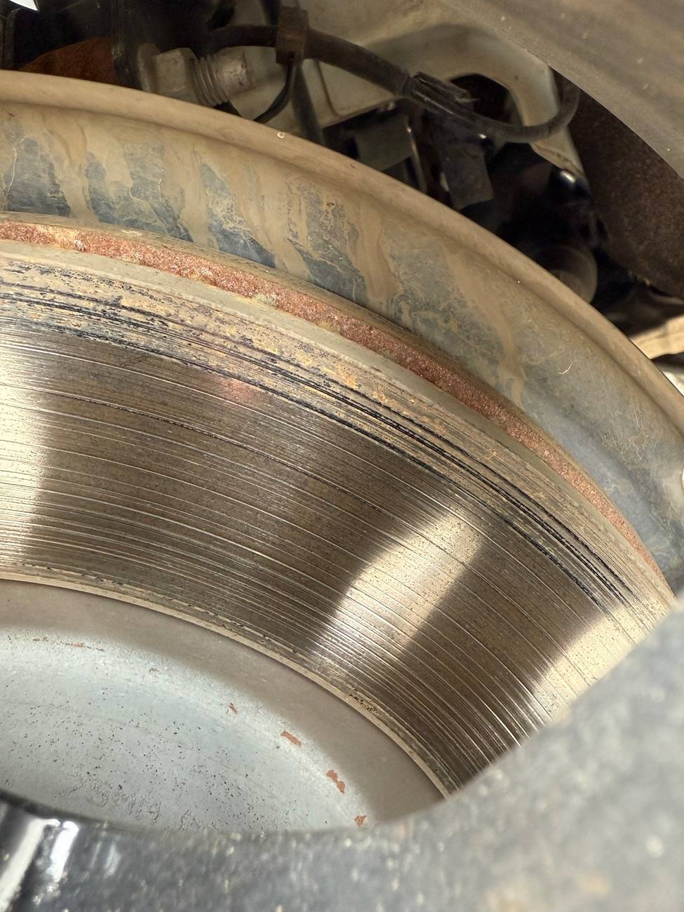

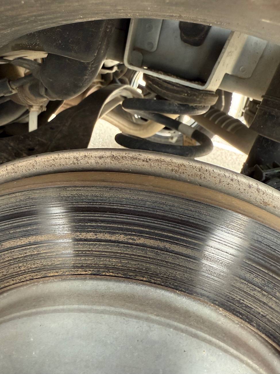

Here is 2 pictures of rotors, brakes are at 8mm
Ford Maverick Rotors and brake pads for 2024 Ford Maverick IMG_4114
Ford Maverick Rotors and brake pads for 2024 Ford Maverick IMG_4115

You're not braking enough, those rotors are rusting and getting scored from lack of sufficient braking
A couple times a month, find a road without traffic and do 2-3 moderately hard stops from 60 MPH to 15 MPH
Speed back up to 60 MPH and drive about 3/4 mile between stops to cool the rotors and pads

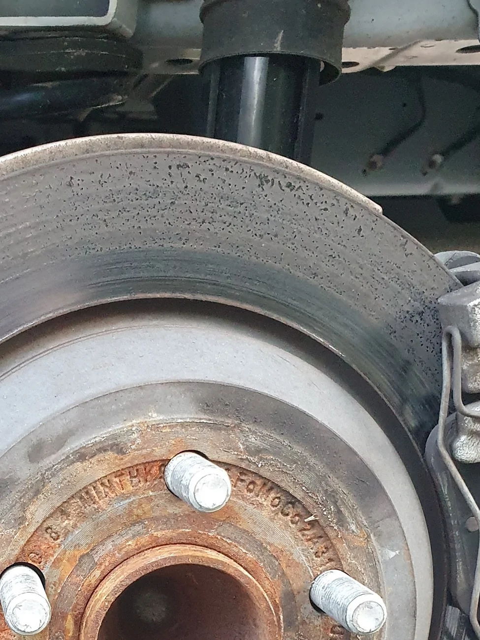

Me neither, it's all generator braking. Brake checking didn't work in my case and I still have rusty rear rotors. It may have actually worn out the front, as they were replaced by the dealer under a maint. plan. It was a surprise to me. Maybe I'll get new back brakes out of the deal too. I'm resigned to it. Rusty rotors for life.
