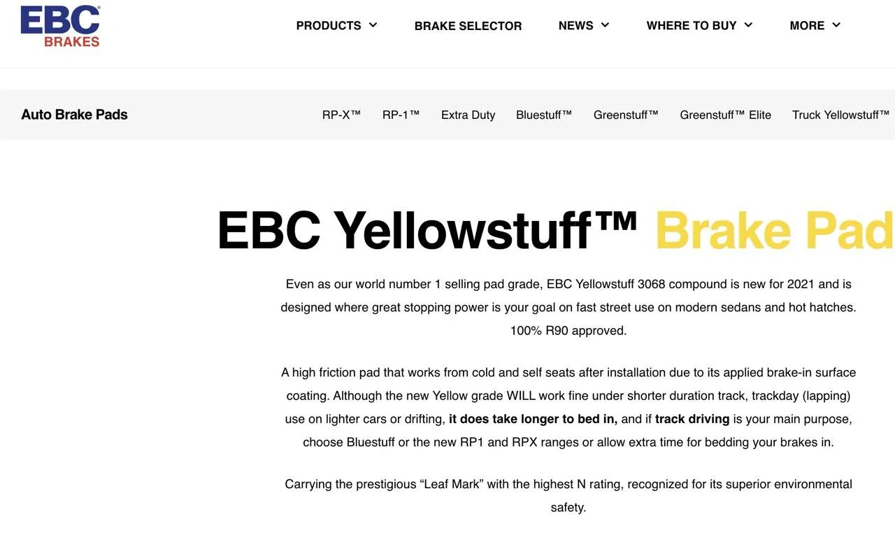

Not sure what you mean. My source already linked and is listed in my post, the ebc website, click the link. If you can't bother here is a photo. google ai is super usefull at getting key information wrong even when it cites a source. ai has been proven to hallucinate as well.
THIS IS THE LINK TO THE FIRST PICTURE AND SOURCE EBC SITE
https://www.ebcbrakes.com/products/ebc-yellowstuff-fast-street-pads/
Ford Maverick Brake upgrade (EBC Yellowstuff rotors & pads) for my 2.0 ebc Larg

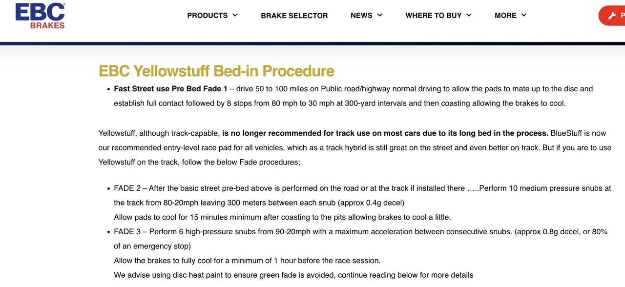

Here is more info on why the yellow pads are different than before:
"Yellowstuff, although track-capable, is no longer recommended for track use on most cars due to its long bed in the process. BlueStuff is now our recommended entry-level race pad for all vehicles, which as a track hybrid is still great on the street and even better on track. But if you are to use Yellowstuff on the track, follow the below Fade procedures"
THIS IS THE LINK TO THIS INFORMATION FROM EBCs WEBSITE MY SOURCE.
https://www.ebcbrakes.com/race-motorsport-articles/bedding-in/
Ford Maverick Brake upgrade (EBC Yellowstuff rotors & pads) for my 2.0 3 Larg
Cite your source.
Here is the key info. Theirs no longer much copper in the pads. They take MUCH longer to break in on the street for at the limit use. If you are using them in stop and go traffic you won't notice the pads limits. The long bed in process, is what i was noting origninally and this is specifcally noted on the ebc yellows by oem in the pictures, on their main website.
