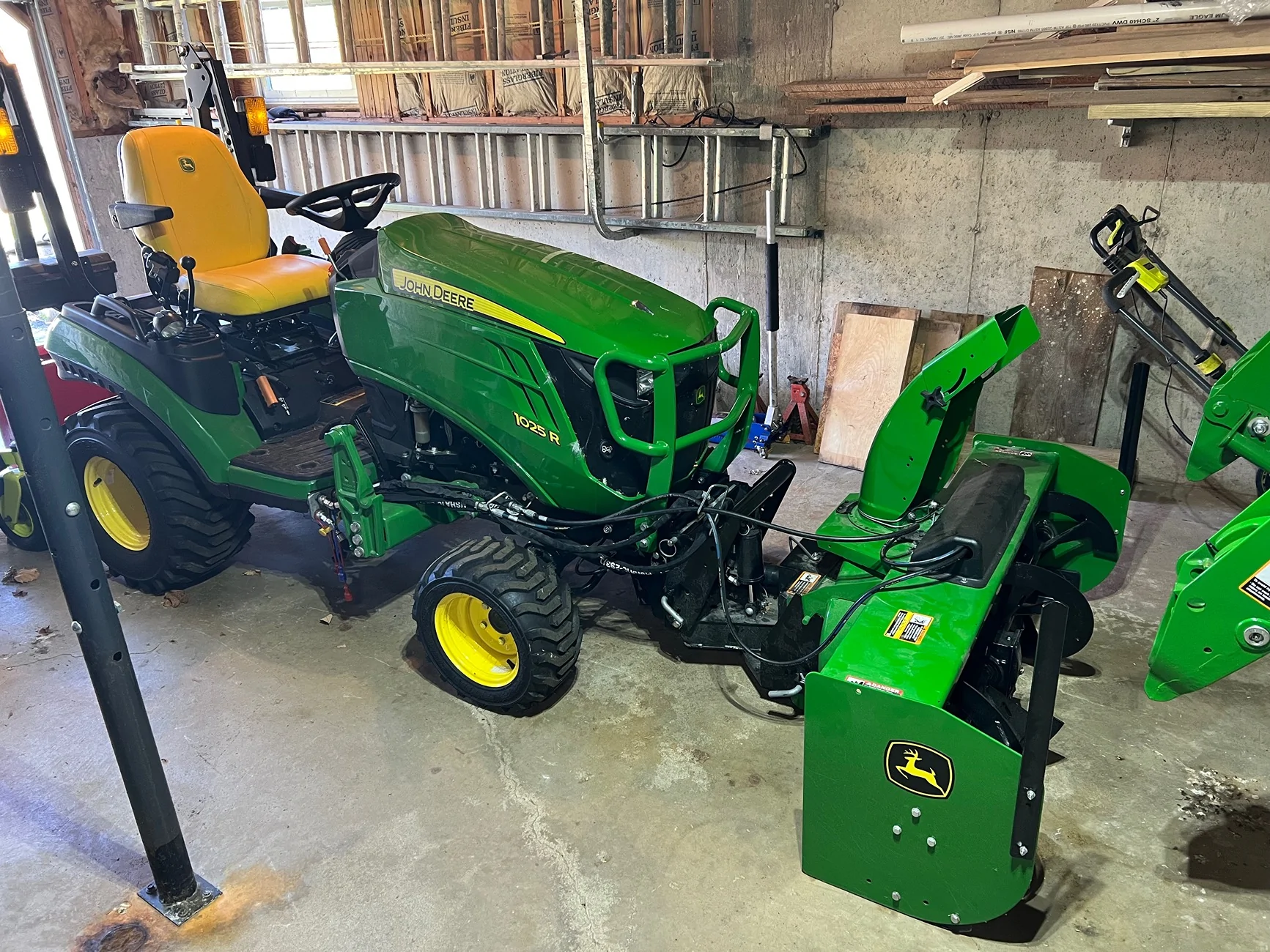

This is what I use for snow removal. It is a 1025R John Deere with a 54 inch snowblower. I bought it last season to replace a 23 hp Kioti with a 48 inch snowblower. The Kioti was purchased new but was problematic which is why I had the homeowners blade on my four-wheel-drive Colorado. The John Deere is extremely reliable and I don’t ever expect to use a rear blade on my Maverick but it will be there for emergencies. I hope this clears things up for everybody.
I seriously doubt it will.

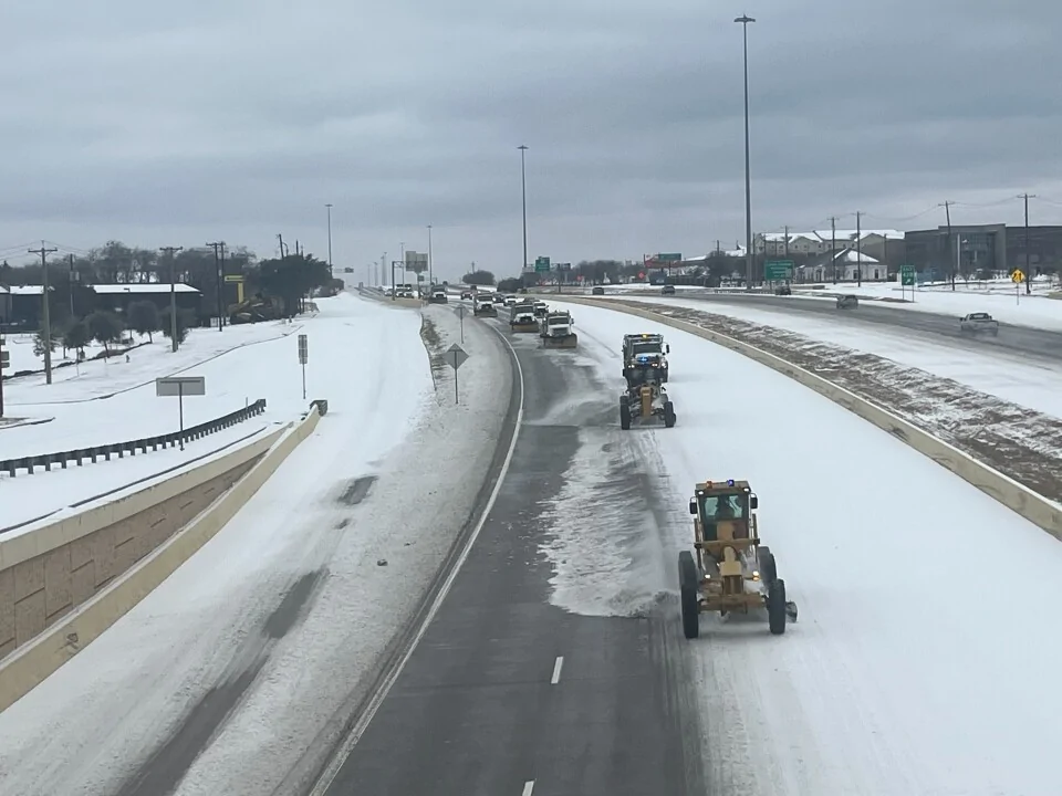

From a Texan "What in hell is that contraption used for?" LOL
That joke didn't really age well, since this image was probably taken within 25 miles of you last weekend. Thanks for jinxing us. :crackup:
