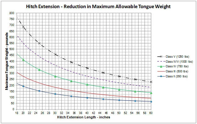

What worries me is the length of the lever holding that blade
If it's really 300 lbs, that's a LOT of weight cantilevered out 3+ feet away from the hitch.
Diagram from here > http://www.visualsc.com/hitch_calc.htm
Yes but (there's always a but) and I think that is a reasonable citation; that is not the application here.
Towing your travel trailer at 70 mph over potholes ≠ pushing a plow at 2 mph on your smooth driveway.
It illustrates a basic idea though.

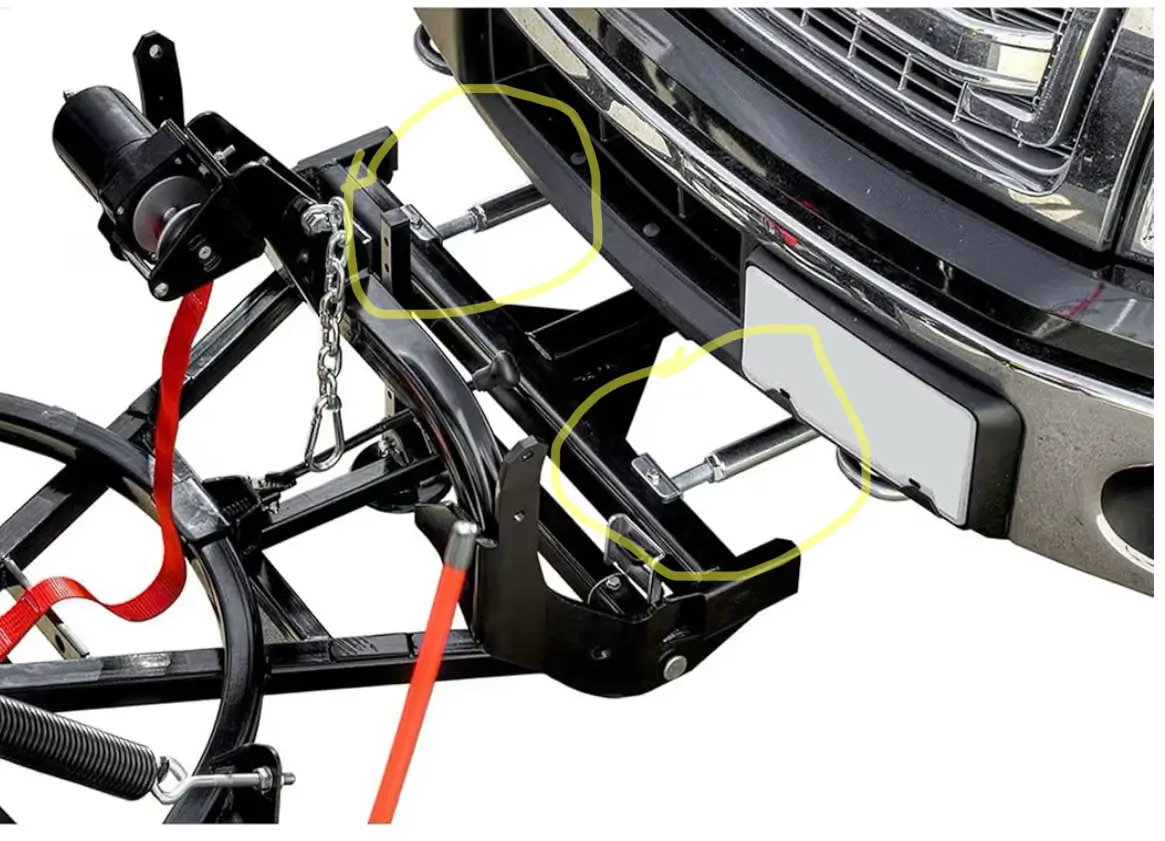

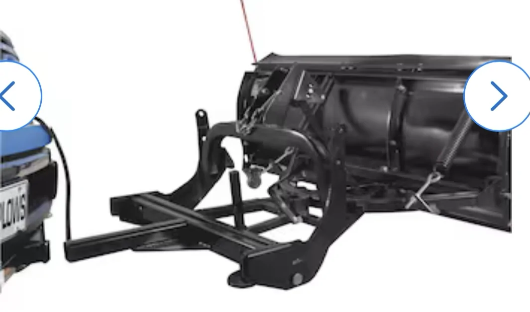

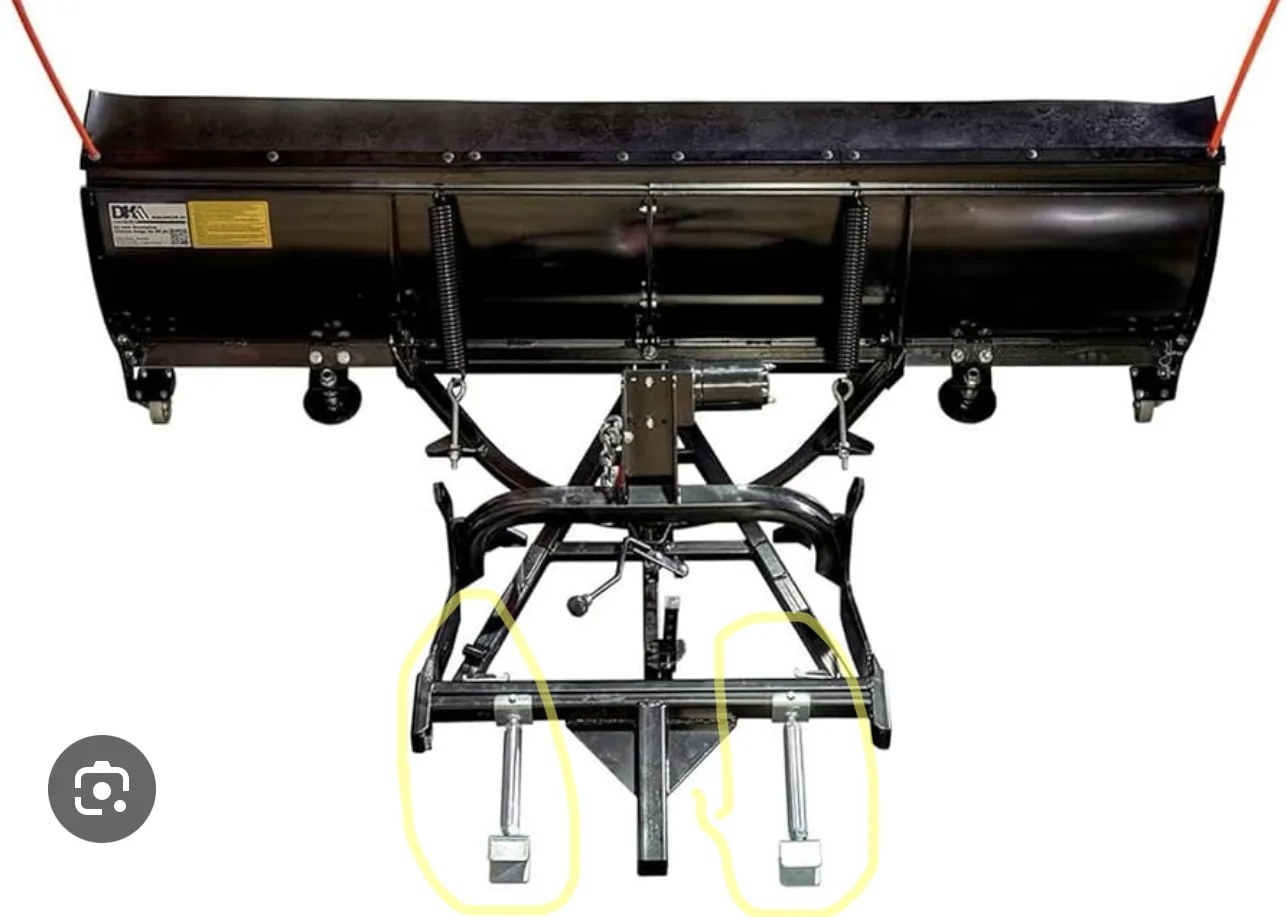

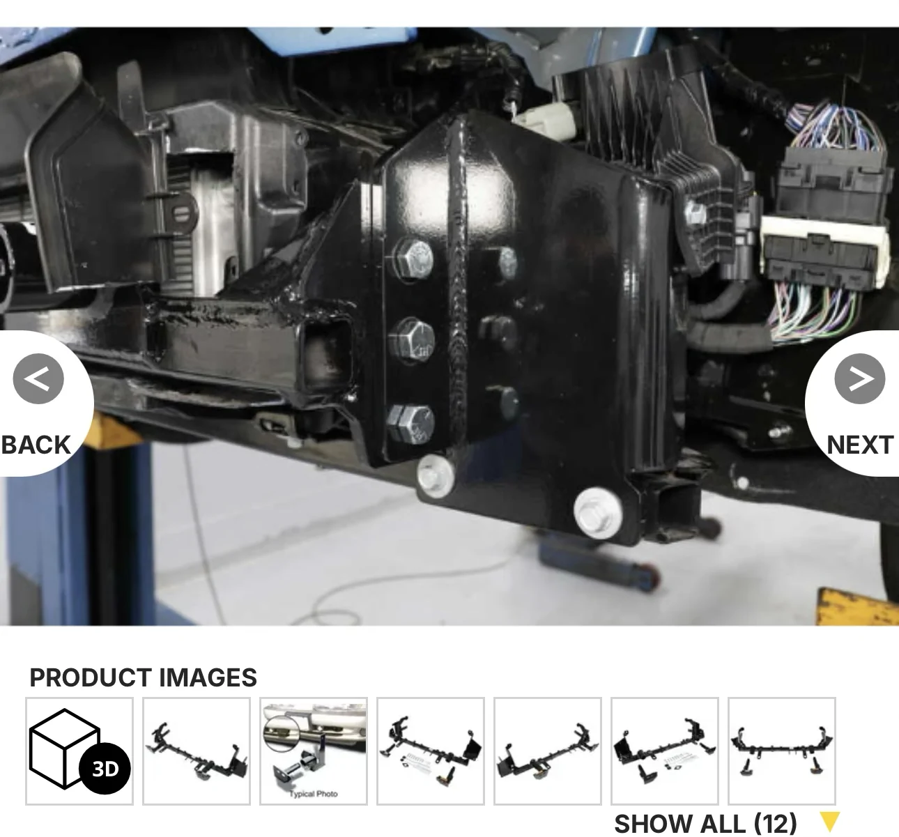

My point wasn’t about front mount vs rear mount, but that hitch mounted plows are not supposed to have just one mounting point, because the hitch serves as a fulcrum for a lever arm, the blade, to apply torque multiplication from the lever arm.
Ford Maverick Rear mounted snow plow installed IMG_4629
Hitch mounted blades are supposed to have additional mounts to the frame to reduce torque loads.
Ford Maverick Rear mounted snow plow installed IMG_4630
Ford Maverick Rear mounted snow plow installed IMG_4631
without these additional mounting points, the torque loads on the blade are likely to bend the rear subframe that the hitch receiver is mounted to.
